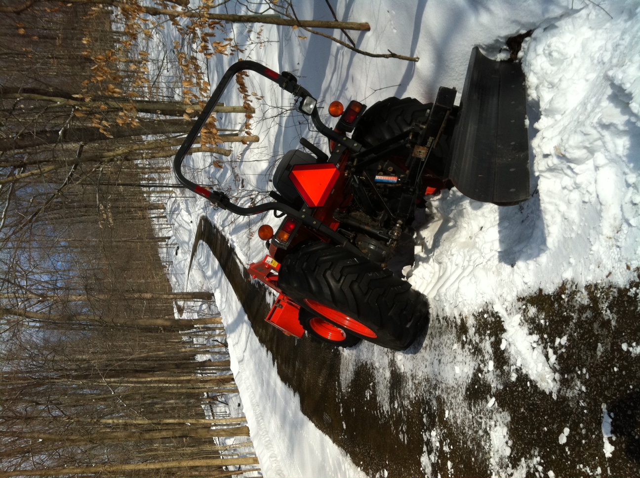

Next time, for my particular uses, I'll go back to R1. Mostly my work is where scuffing up the turf doesn't matter. R4 may be more thorn resistant but I did managed to put an antler prong thru mine. In the pic attached, I got the R4 off the edge of the pavement and attempts to get back up just made it worse. My thought at the time was that R1 would have probably let me drive out and, maybe, not sucked down so far to begin with.

Not all R4s are created equal. Some have huge lugs that have terrible traction. Those on your tractor are the same that my L3240 had and they’re pretty similar to a R1 tire but wider. I don’t think you’d notice much difference in traction.
