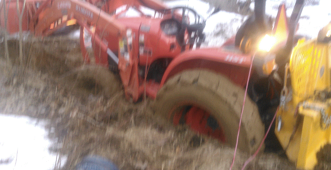

My thought at the time was that R1 would have probably let me drive out and, maybe, not sucked down so far to begin with.
Boy, your pic looks familiar. Nope. Didn't matter what you had for a tire. Had to winch this out with a tow tuck. Even my 5200lb Durango wouldn't budge it.

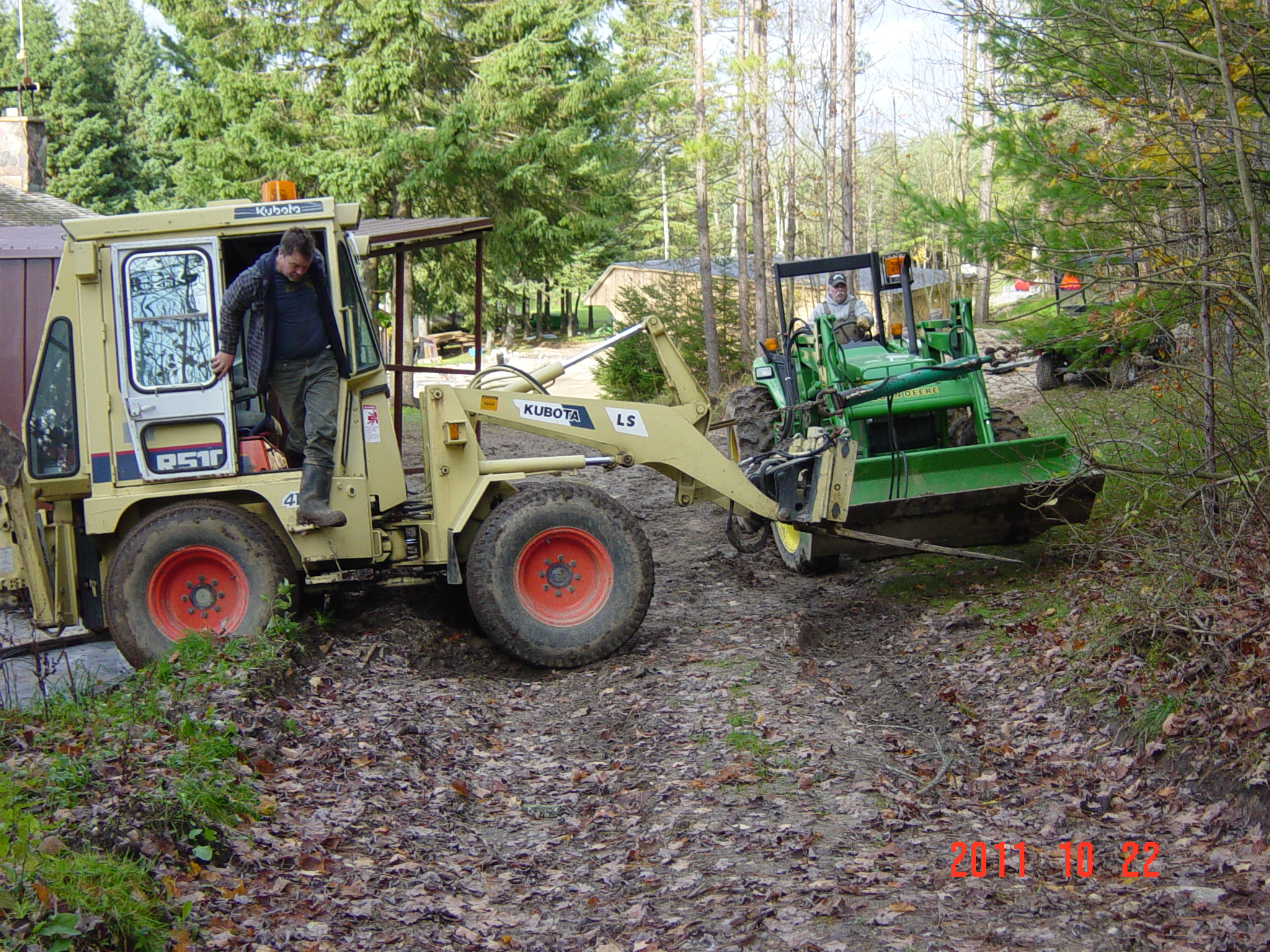

It really is one of the few times in twenty or so years that Turfs gave me grief.

R1s clean because of the tread angle. Wheel speed not required.

Stuck like that. All you need is an old surplus cylinder with a good long stroke and shackles or hooks at each end. Some hose and plug into a remote. Probably cheaper than the tow. If you have something to attach it to, there doesn't seem to be a limit as to what you can unstick. Also, GREAT for being alone, and stuck.
Seen in action, turf tires, working in very wet conditions. View attachment 625826
A winch on the Durango was actually pulling it toward the tractor. Plus the tractor wanted to tip over so had to chain it to an opposite tree. Thought about chaining the Durango down but was concerned that it would ride up and wreck the front bumper. With some clever boom maneuvers on the tow truck and $150 later, she was unstuck. One of those gasoline powered, portable winches may have been the tool for that day.
Love that R510.

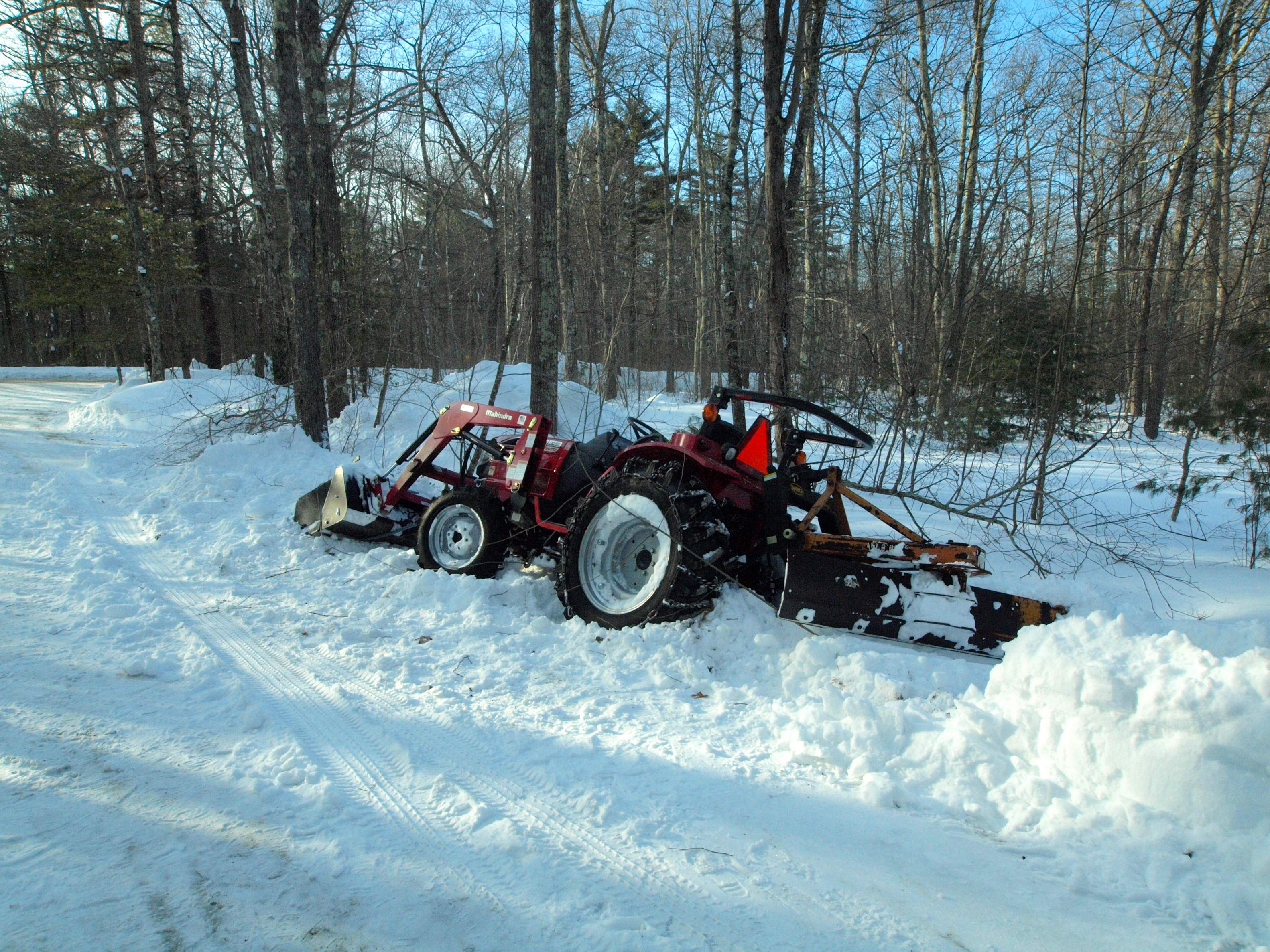

That doesn't look so bad. Did you try a chain to the bucket, with the other end attached to a tree? Crappy picture I know, but that's how I got out of this one. (And in case you can't tell, those are R-1s.)
