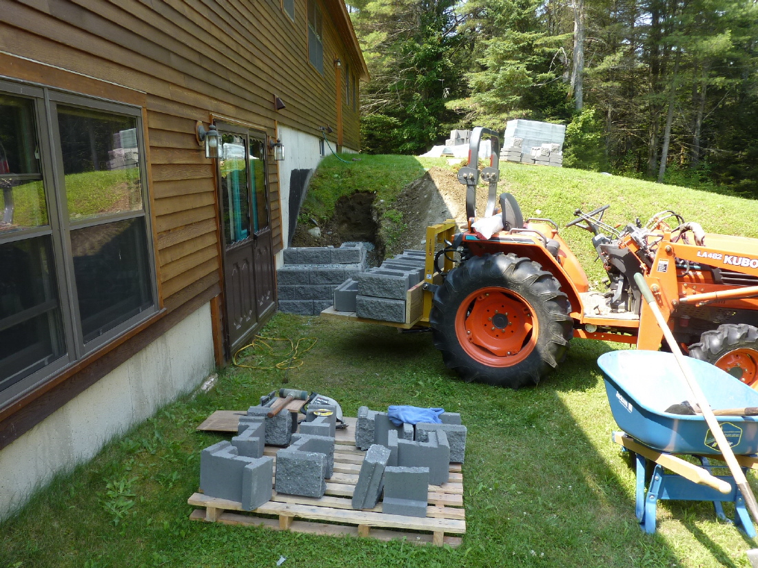

I purchased a carry all then took it back. I decided I would rather have some forks for my 3ph and then get some wooden pallets to move things around. I was disappointed with the ground clearance with the carry all when all the way up.
