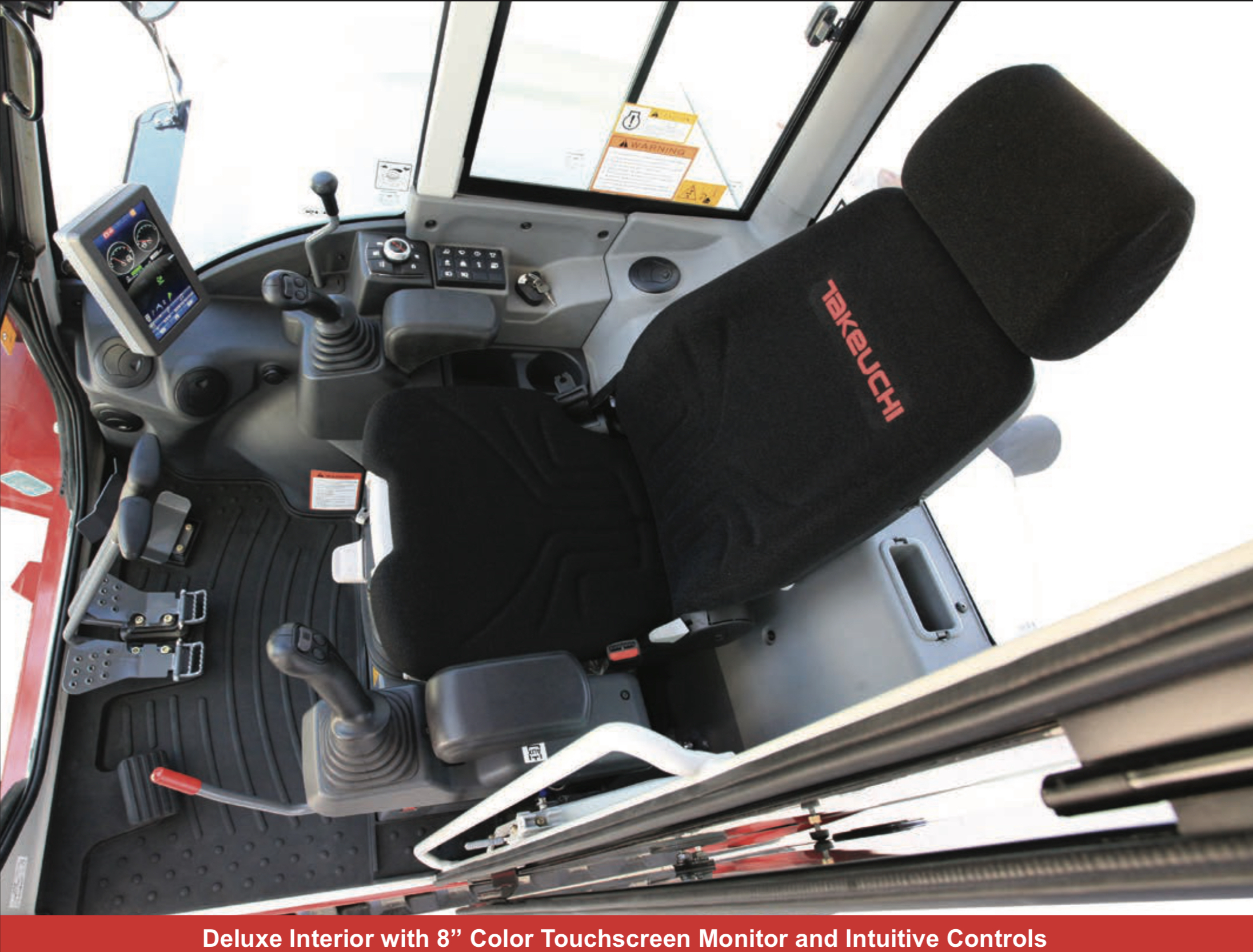

Lol, I’ve already been looking at it. Here’s a pic of the new cab on the tb370. It is a lot better. They finally went with a screen and got rid of all the buttons. Kubota did too, but honestly i dont mind buttons and the new screens are not my thing, well except for the camera, my thing is a go solid sealed rubber floor, seat, and nice rubber joysticks. I got on a cat 505 and the sticks were like some cheap PlayStation controller.
A positive was to get the throttle off the arm rest, that’s an annoying place. The floor is a good chunk of solid rubber, so is the -5’s, unlike my 040 that is a loose fitting couple of floor mats that you can seen the ground below.
Looks like they got rid of the fold out cup holder/storage compartment. That’s also a BIG thing for me is just some place to put stuff. In my 040 there is no place to put anything, just a little cup holder. The -5’s have a few places. The 300 series has a couple of places too. Its the small things. I added a place on my 040 and a place to put Kleenex box…allergies. Every piece of equipment I got has a box of Kleenex.

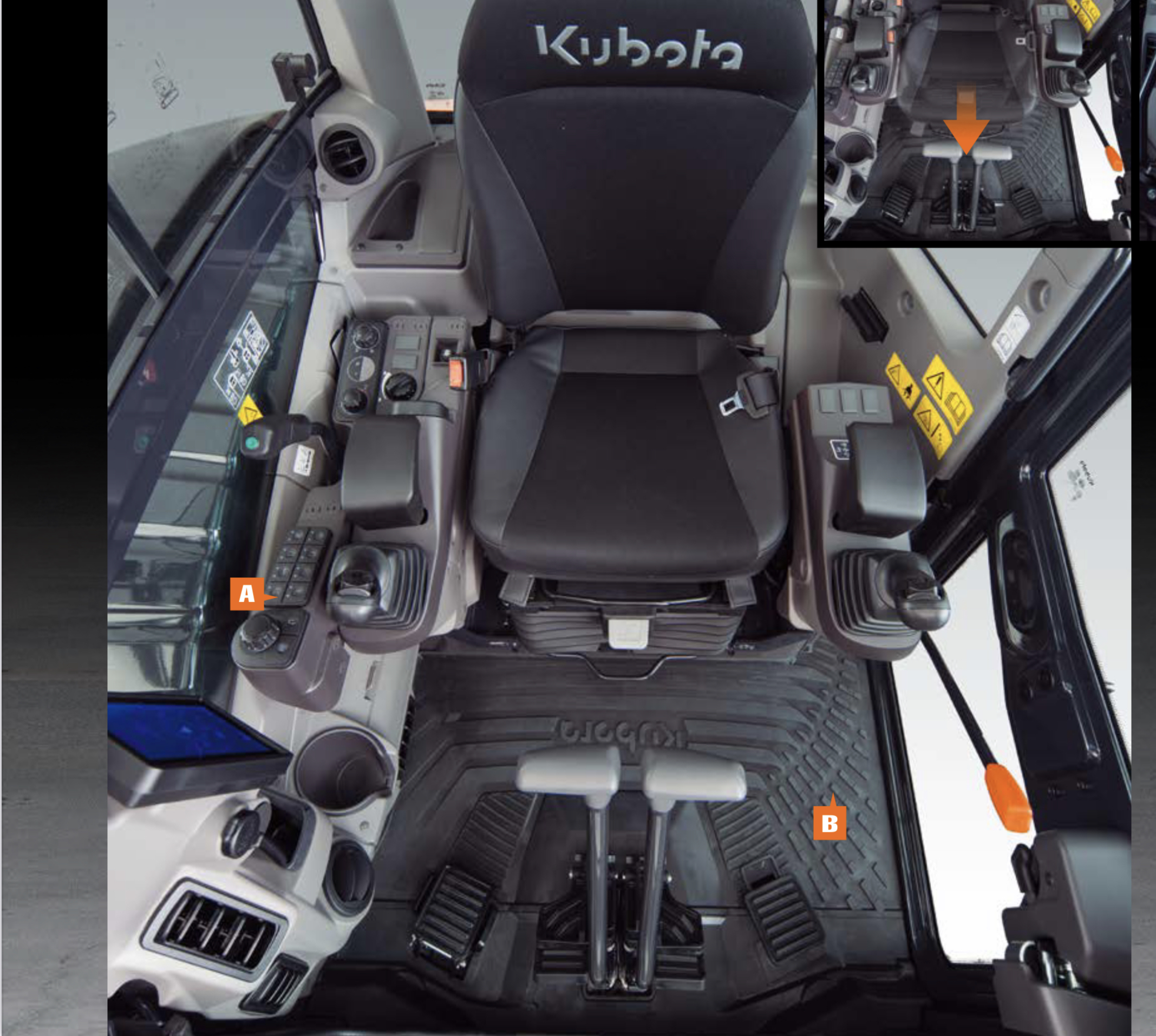

heres a pic of the kubota -5 cab. Nice thing with the -5 is the ability to adjust seat back and forth separate from joysticks, but then you can also adjust the seat with the controls front to back. Very adjustable.

One of the reason I went with a Takeuchi for my baby excavator a couple years ago was the simple electronics and heavy counterweighted rear end toughness.(she got a big butt)
The Cat sticks feel different because they are electric over hydraulic design. You loose some feel at the joystick but you don't get the heat from hydraulics like you do from a piloted set up, making it easier to keep cool inside in the summer.

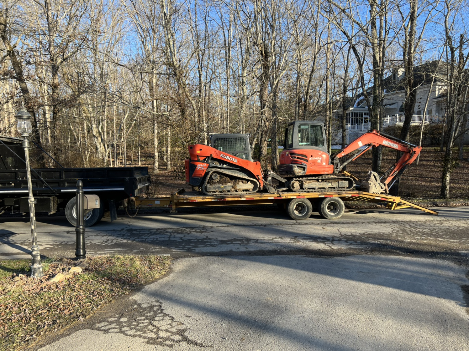

Also worth consideration is what you are trailering it with. The 5t class machines are at the limit of a 14k trailer. Whereas your KX040 has alot of wiggle room and can even be towed on a 12k trailer. IF that is a concern for you or not
The KX040 with 6 way blade and cab is 10,300. Its just over 5T. 14k trailer is pushing it. 12k Trailer I doubt it. The 057 is over 13k I believe.
I do agree OP should look at Kx057 or equivalent or larger machine. However OP is into CDL territory.

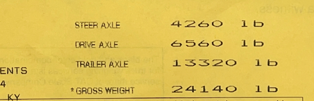

not 100% true. The u48 has about 200lb less bucket breakout, and 1200lb more arm break out. It has 2” more reach than the 040, 7” less dig depth and about 500lb more lift capacity. Plus a better cab. The 040 is well under 14k trailer capacity. The u48 is pushing a 14900 trailer.
heres my scaled numbers with the 040 plus chains, a solid 2.5” punch bar and a 5’ gravel bucket.
Kx 057 is an absolute no go with my current setup to stay under 26k. I could possibly go 1000lb lighter in a another trailer platform, but still wouldn’t be possible for a 057. Unfortunately.

Lift capacity? Look at your stats again. The KX is 4200, U48 is 2900. Not very close. The U48 is a great machine…I almost bought one over the KX040. However when it came down to it there was no reason To spend more money for a less capable machine for my needs.
So you are into CDL territory for what? Not really any gain. That was my point.

No ideal what numbers you are talking about..4200, 2900?
not in cdl territory, well under. You keep saying less capable..I’m quoting kubotas stats. At best you could only say they are equal, but in reality the u48 has more numbers on top of the 040. Please explain.

26,000 pounds for the load and trailer not counting the truck seems fair to me.
