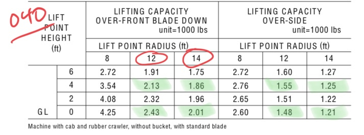

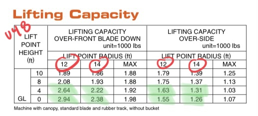

No ideal what numbers you are talking about..4200, 2900?
not in cdl territory, well under. You keep saying less capable..I’m quoting kubotas stats. At best you could only say they are equal, but in reality the u48 has more numbers on top of the 040. Please explain.
Well if you look at the 2 pdfs I linked and look at the lift capacity…you will see 4200 Vs 2900.
   / Question about hydraulics performance on different excavators.
#43
Lift capacity? Look at your stats again. The KX is 4200, U48 is 2900. Not very close. The U48 is a great machine…I almost bought one over the KX040. However when it came down to it there was no reason To spend more money for a less capable machine for my needs.
So you are into CDL territory for what? Not really any gain. That was my point.
oh man, I just realized what your talking about… those charts. Lol
Those charts aren’t even, you need to look at them closely. The 040 chart starts at 8’ out from machine and the u48 starts at 12’.
Kubota stopped listing the the 8’ on the -5’s. But I saw some literature can’t remember where but the up close lifting capacity of the u48 was like 5200.
Again, look at the charts. The u48 has more lifting capacity on almost all comparable measurements. It is weird dealing with 2 different charts. Confusing right?
I made it simple for you. U48 out performs kx040 on lifting in every comparable measurements, charts are not equal, you have to pay attention. As I said earlier, I read on some press release that the up close craning is like 5200lb for the u48, compared to the 4200 of the 040. The only place the kx040 outperforms the u48 is 6” in dig depth. The tracks are 1’ longer and wider so much mor stability. 32gpm flow through 3 pumps compared to 24gpm single pump on the 040. The u48 is more machine. Even a longer stick by a few inches. Down side is the angle difference of boom that changes dig depth because of the length of the undercarriage I assume, in which a grinder may fix.
