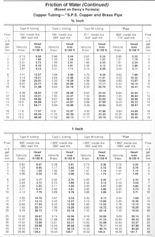

Hi there. I have a question for anyone with knowledge about water pressure drops.
The situation is a main house with a well and pump system. It then feeds water to a trailer that is 1500 feet away. using either 3/4 or 1 inch black poly pipe.
The problem is low pressure at the trailer end. expecially when the main house pump is at cut in pressure.

I couldnt find a simple online pressure drop chart to tell just how much is lost in the 1,500 foot run So was wondering if there is a formuler for this also.?

In my Cameron Hydraulic data book @ 1 gpm, the head loss is 0.335 ft/100 ft in 3/4" line & 1.21 for 2 gpm. To get psi, multiply the head loss by 0.433 (and account for any height loss this way, too). For 1" pipe, head loss goes down to 0345 ft/100 ft for 2 gpm, approximately by the ratio of the square of the diameters.
I put in 1100' of 3/4" poly line years ago down my back hill after figuring out that it would lose very little pressure at 1-2 gpm and would actually gain lots of pressure due to the 100' height drop (e.g. 43 psi).
The booster pump is your best choice. The tank won't do anything other than preserving water at whatever pressure it gets.
