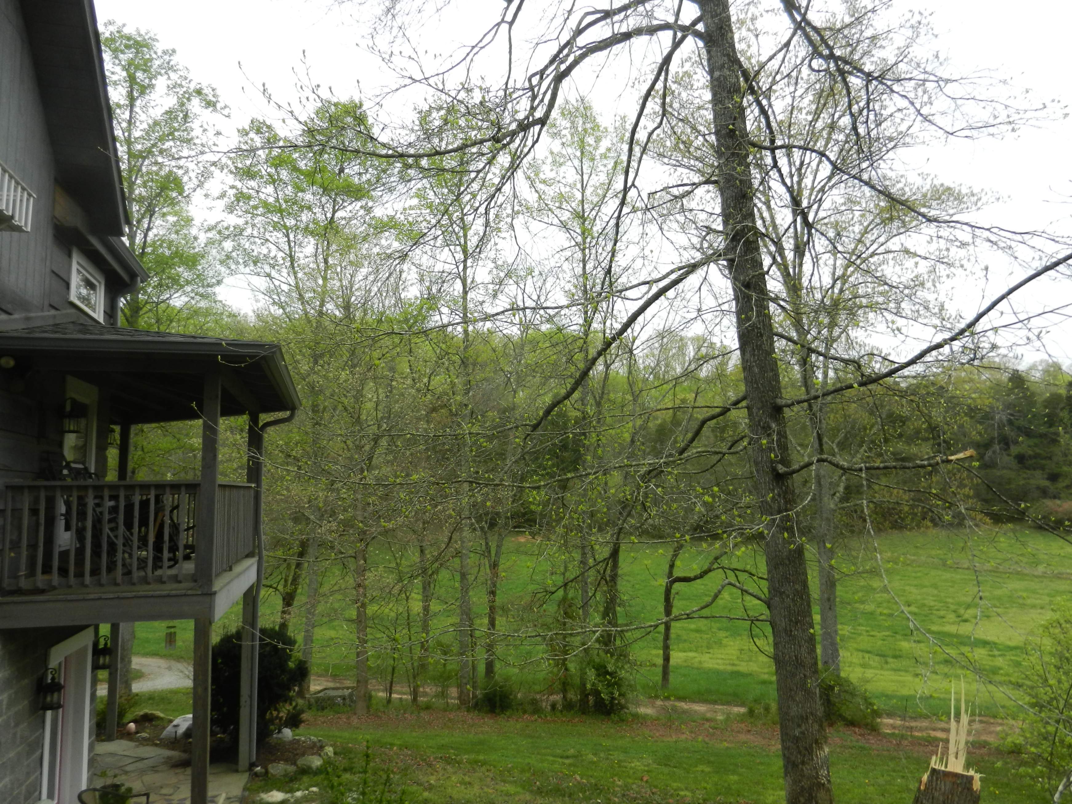

Have a dying 25' weeping cherry I want to take down.
Looking at the tree, the main trunk slopes to the 10 o'clock position. However, I want the tree to fall going towards the 3 o'clock position.
I've taken down some much larger trees, but I've never taken down a tree going against the angle it was leaning, and was wondering if I'm making a moutain out of a mole hill?

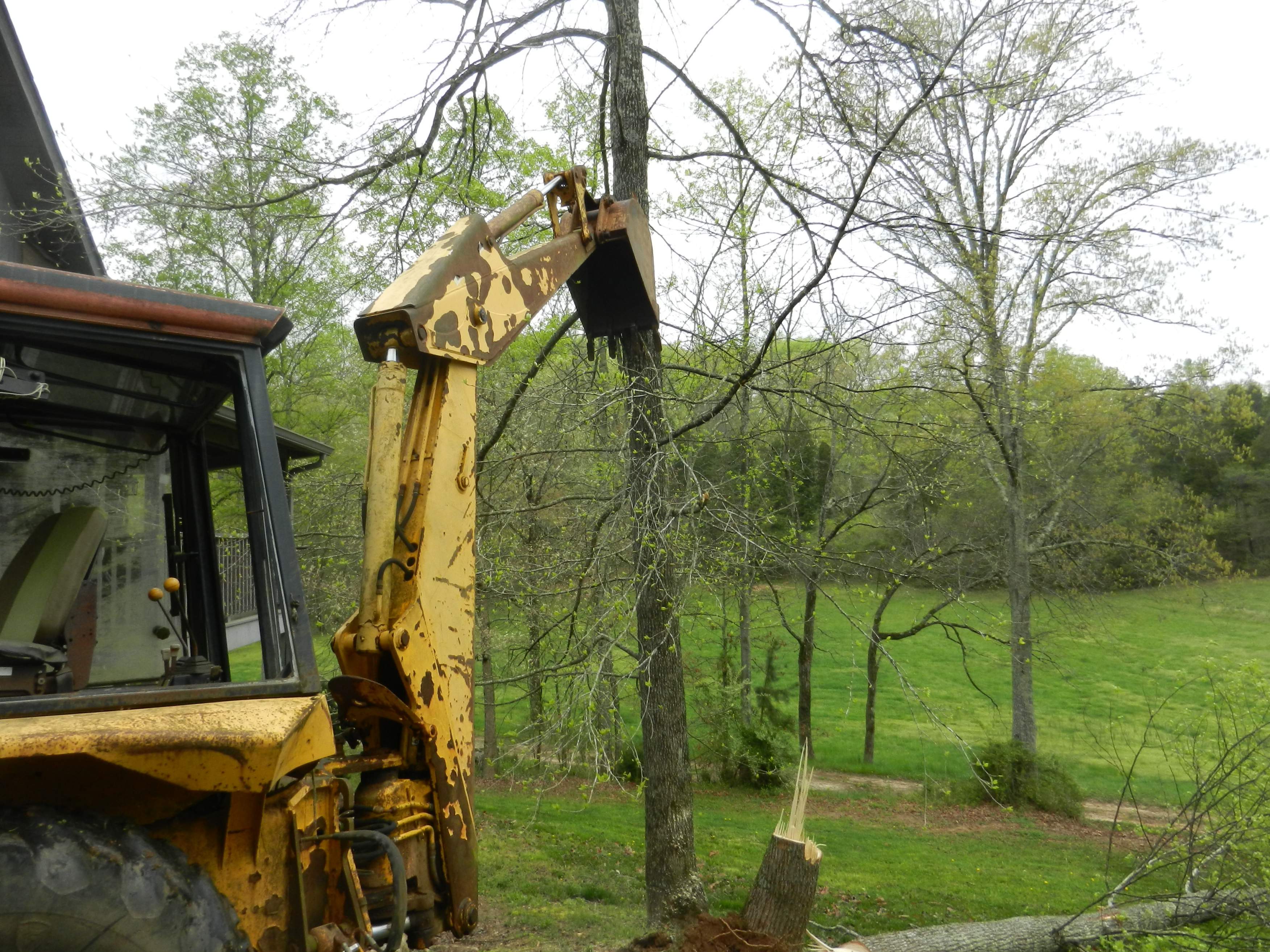

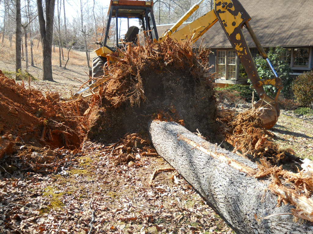

I'm not giving any advice on how to take it down, but I had a tree leaning towards my house that I wanted taken down. What to do...
I finally got some help!
I cut the notch in the tree and left the hinge thicker than I would normally make it. My thinking was I wanted the hinge strong enough to hold the tree and let the force of the backhoe break the hinge slowly, allowing me to help guide the tree.

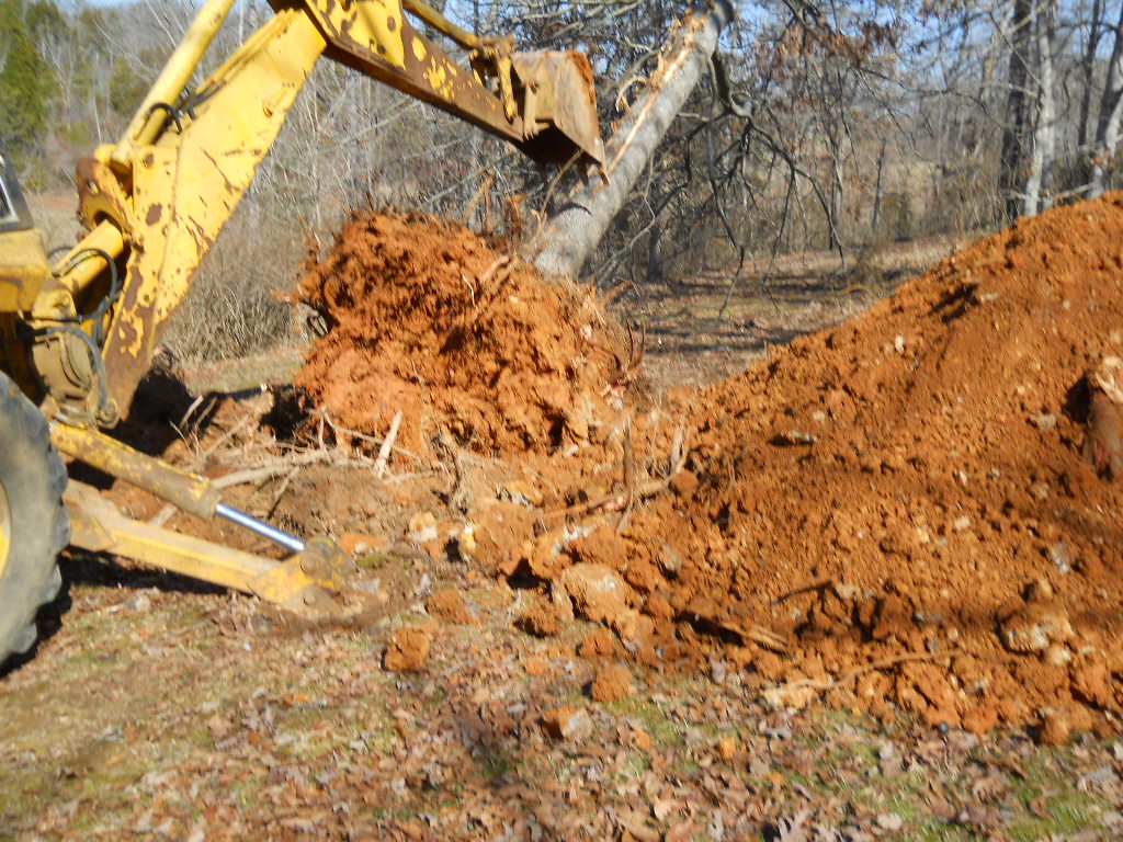

On another note, our neighbor (wifes cousin) wanted two trees taken out next to his house. I ended up leaving the tree intact. I dug on three sides of the root ball, keeping the part opposite of the house intact in the theory that it would help anchor the tree from falling towards the house, but the other side (dug up) would allow the tree to fall away from the house. In this specific circumstance, it worked.
