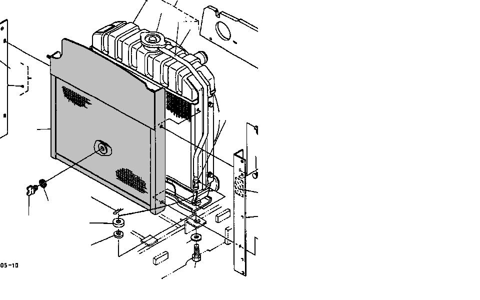

Attached is a picture from the parts manual of my L2500. The gray item is listed as 32400-17720 and is a screen in front of the radiator. I don't have one but some items in my parts manual are shared with the 4wd model.
Question...does anyone have this screen and if you can can you shoot a picture and post it here for me? Any thought on it's usefulness and aid in cleaning out goatweed blooms and stuff.

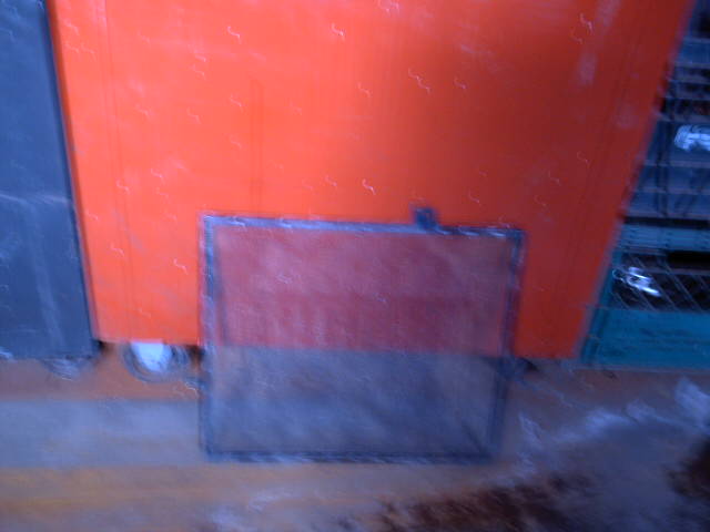

Rob - I think the B7800 has the exact same setup as the B3030 as posted by Brian above. Attached are a rather shaky photo of the screen for my B7800 and a less shaky photo of where it installs in front of the rad. (The white sheet is my winter replacement for the screen.) The fan on the B7800 is a "puller", front to rear. And yes, the screen does keep a lot of crud out of the radiator fins.

Good shot, I see the B's hood pops up. Mine doesn't, just the side panels come off.

Here is a screen shot from my L2550dt parts pdf. Not sure how I got it but maybe I saw a l2550 on Ebay and then asked tractorsmart.com for it. If you woul dlike the parts manual send me an email and I'll forward it to you. PM me or I think my emailis listed in my profile
Rob
