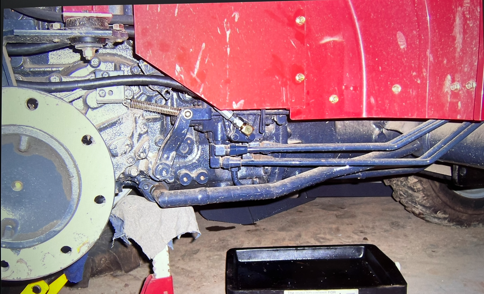

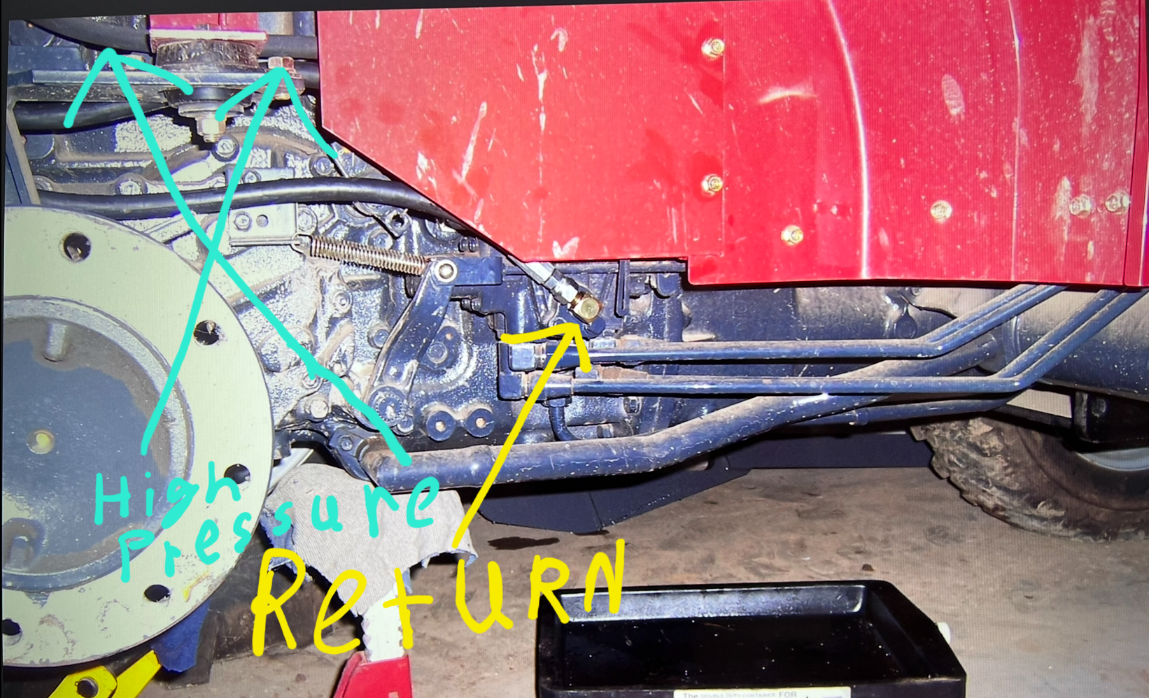

I found this photo from when I was doing my 1540. Maybe it helps a little bit?

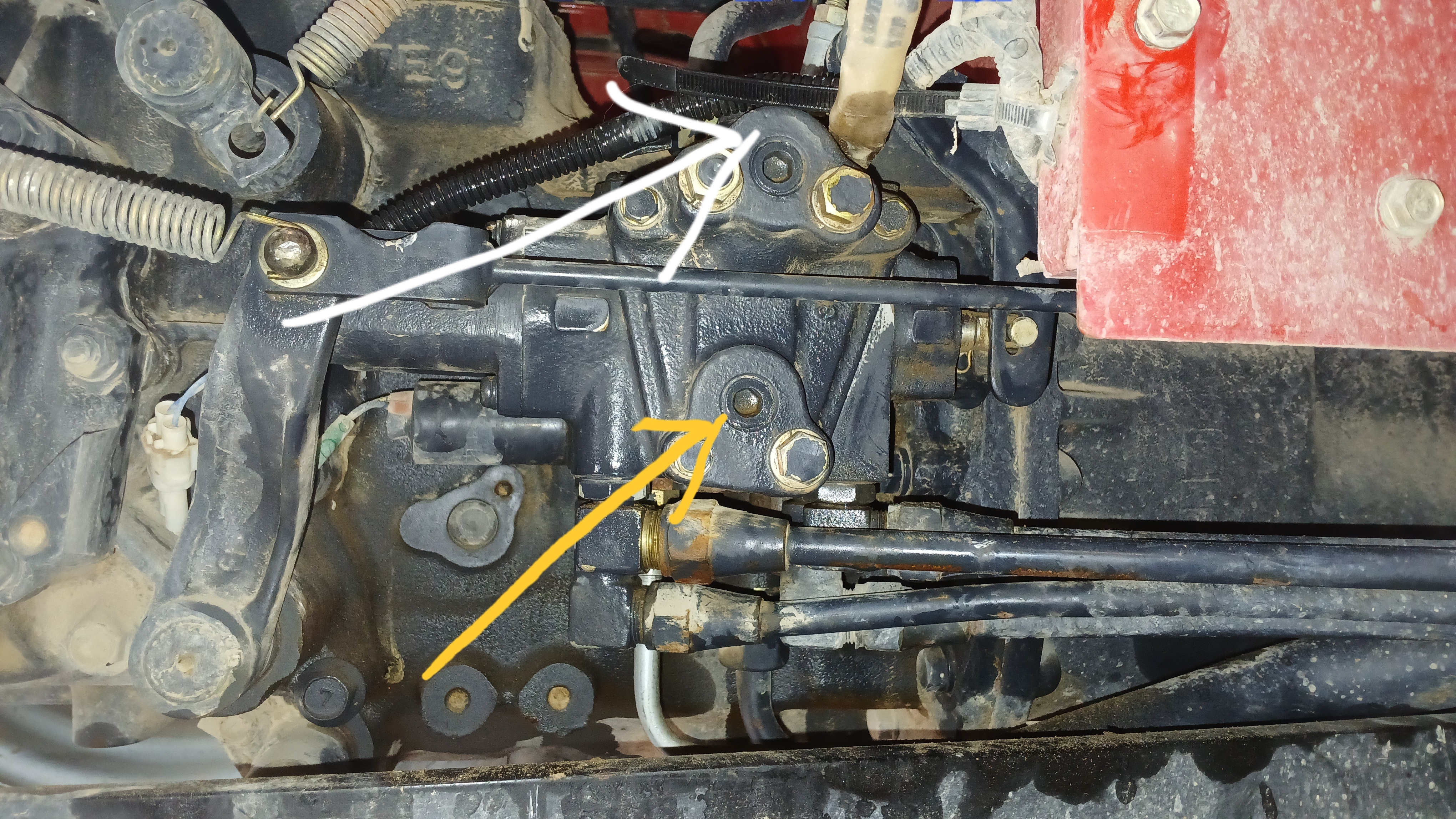

So if I understand correctly the lines being pointed to with the green arrows are high pressure lines going to your power beyond and the yellow is you return line?

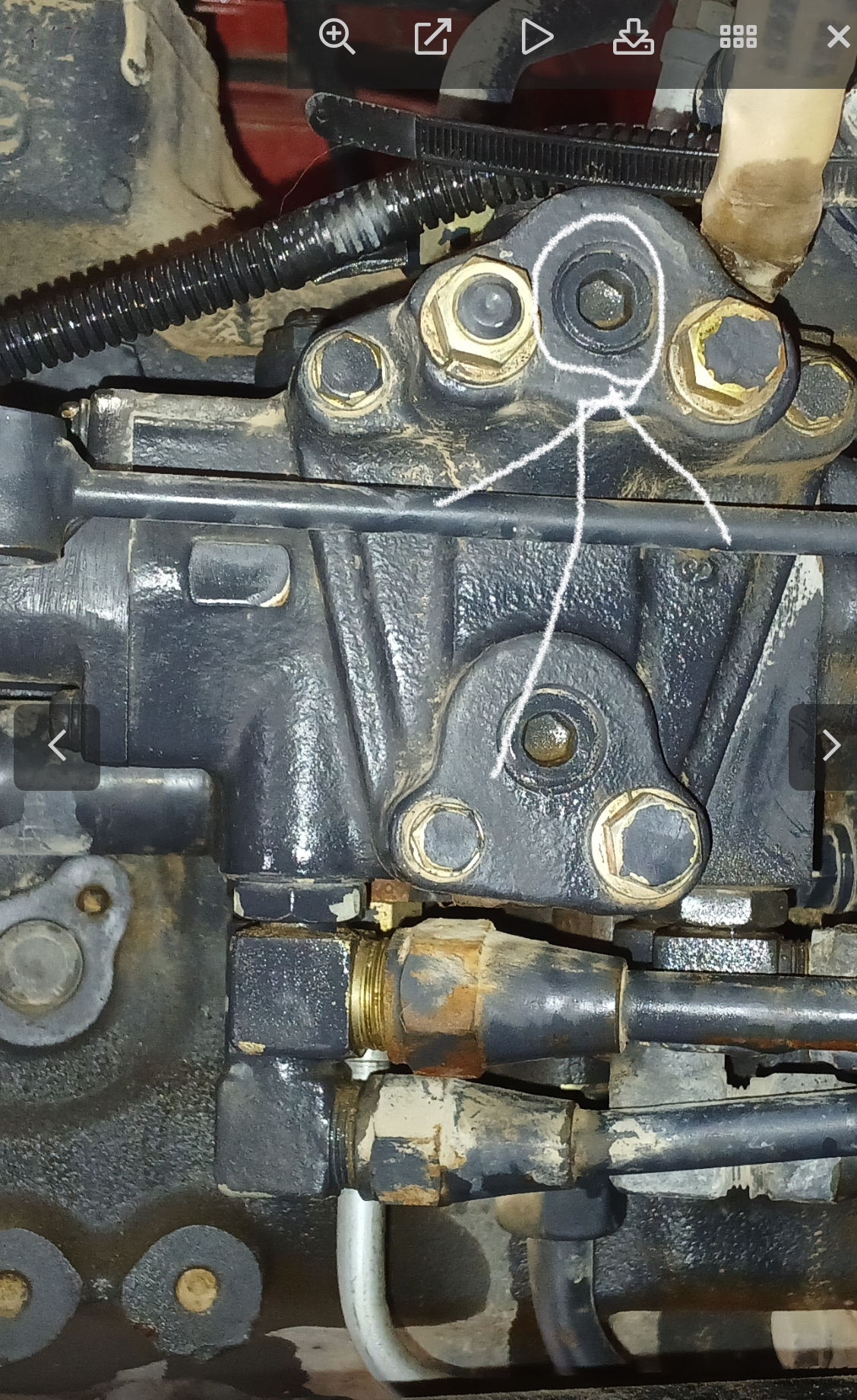

No. That lowest hose you identified in yellow, is connected to the pressure port.
Upper 2 hoses not identified, because my panel is in the way, go to return port and sump port.

Return port

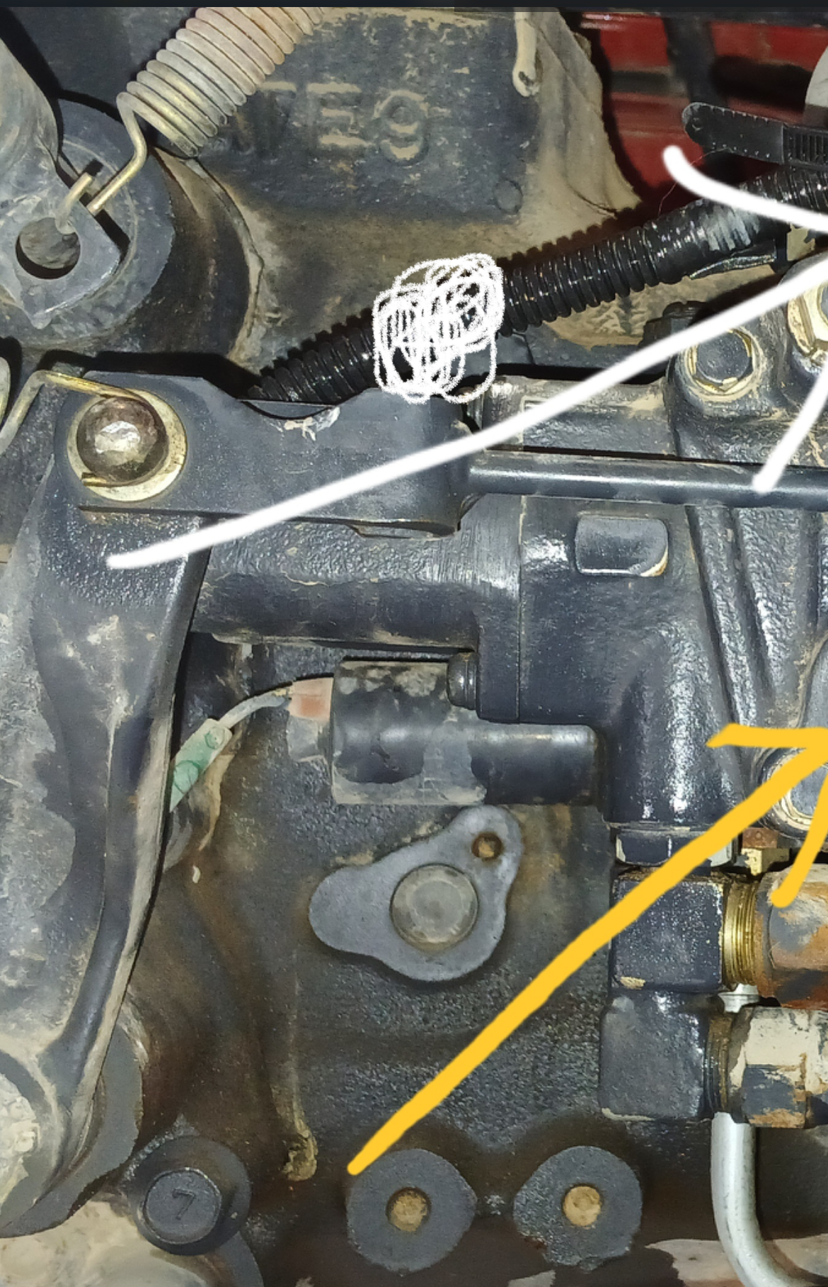

OK. So white Upper is return, yellow lower is pressure. Correct?
Yes.
I don’t see your sump port though. It’s different than mine. I’ve indicated where the sump port plug is located on mine

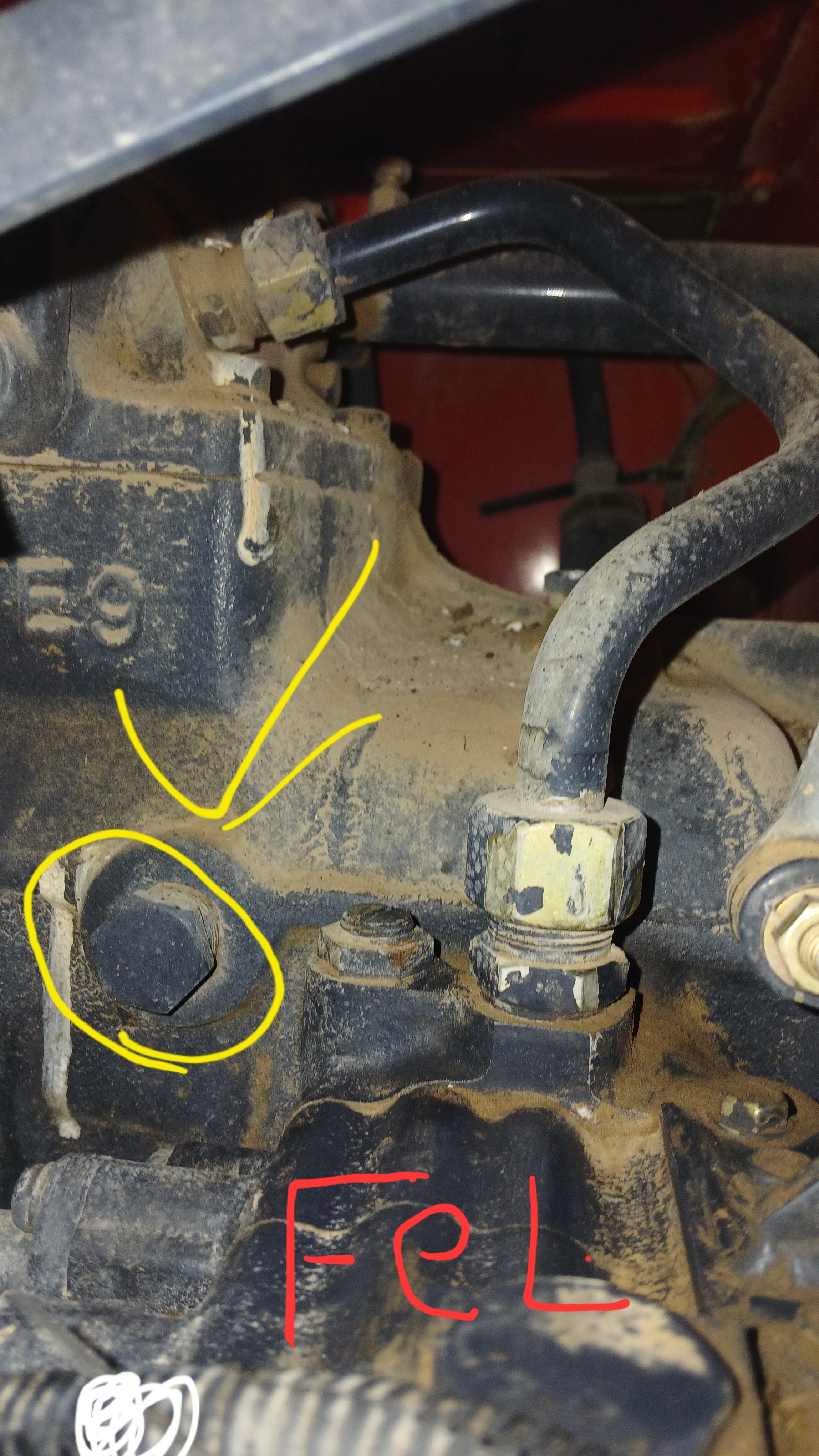

On mine, there’s also a downward facing hex plug, on top of the return port casting, that gets replaced with a “diverter plug “.

Are you talking about this plug? Thus picture is from the top side of the last picture you posted.
