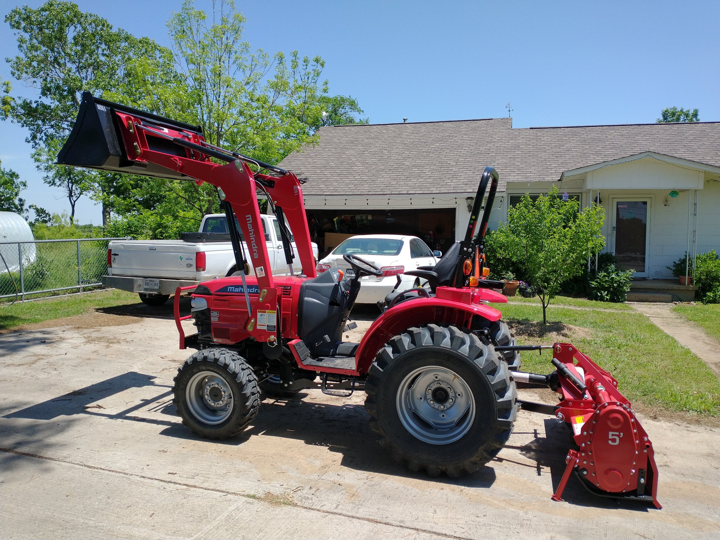

Long story short....I've been "farming" for a few years, basically trying to reinvent the wheel with a 49 ford 8n and some old worn out equipment, fast forward to today and I upgraded to a mahindra 1626 tractor with a 5ft tiller, I've also purchased a heavy duty used chain harrow. My goal with my 7 acres of heavy weeded coastal bermuda pasture is to start rotating cover crops in fall and spring for a few years to build soil health and increase organic matter in our heavy blackland clay soil. My question is how much can I do with the chain harrow? I've basic just been mowing, then broadcasting seed for a few years, and am only having patches of crops come up each season. Tilling 7 acres seems like a very time consuming endeavor, and I'm wondering if the chain harrow would prepare soil just enough to get better seed to soil contact, then run over the pasture with the harrow once more after broadcasting seed? I don't mind tilling specific areas, but what is the harrow capable of, and would running it over the broadcast seed do a good job of drilling the seed into the soil? Any and all advise would be much appreciated, thanks, Matt.
Pics of pasture I'm working with, I've been spreading wood chips for years and have about 4 acres really coming to life with the organic matter added. Also pics of the new tractor! Already got a scratch and dent less than a week in unloading the bush hog out of the truck! I really like the tractor!

A chain harrow would knock most of the grass over....for a day. It's not going to prep ground for planting. They are really made to spread manure, flatten clods from tillage, maybe some cleanup in specific applications. Tilling with a tiller is as you mentioned not really an option due to the time it would take.
Have you reached out to your extension office yet? Check to see if there are any no-till drills sized appropriately for that tractor available for rent. If not from them ask around to any local hunting clubs or see if there is a local guy that does food plots and has one.
Kind of hard to know what to recommend without knowing the endstate.

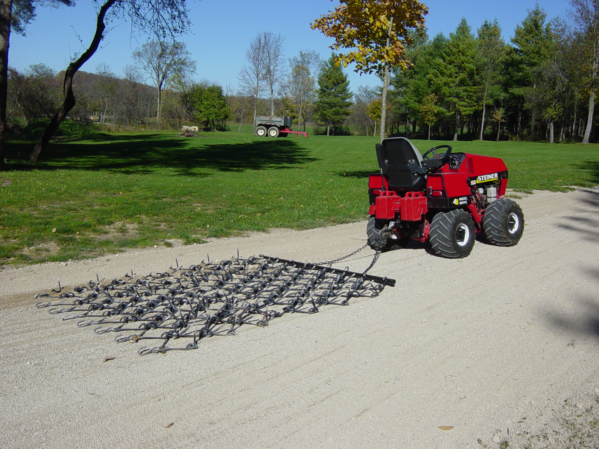

I found grass a nuisance for my harrow, simply getting caught on the spikes. Plus, no matter what you do, the teeth are just too few and far apart.
I'm not sure I would buy it having known what I know now. I have used it upside down, to smooth out landscaping work. But really, dragging just about anything will do that and these things are miserible to find a place to store them out of the way. Or mess with them, changing configuraion.

On that note I have drug a chain harrow over my pasture a lot over the years to break up cow patties. It never did anything to disturb the soil. If you had tilled ground and broadcast some seeds on it that needed to buried very shallow it might work decent for that but they don't disturb native soil much at all.

I would have to disagree on being a great tool for the driveway. Although I did discover a rather unintended outcome. I found the spikes when used in non-agressive mode, left scratches down my limestone screaning driveway. Which I didn't like the look of, but it didn't affect ride quality. But, on a hill where I was having washouts, these small ruts kept the material from just flowing off to the side. It lost ground in a downpour, but survived an amazing amount of rain.
