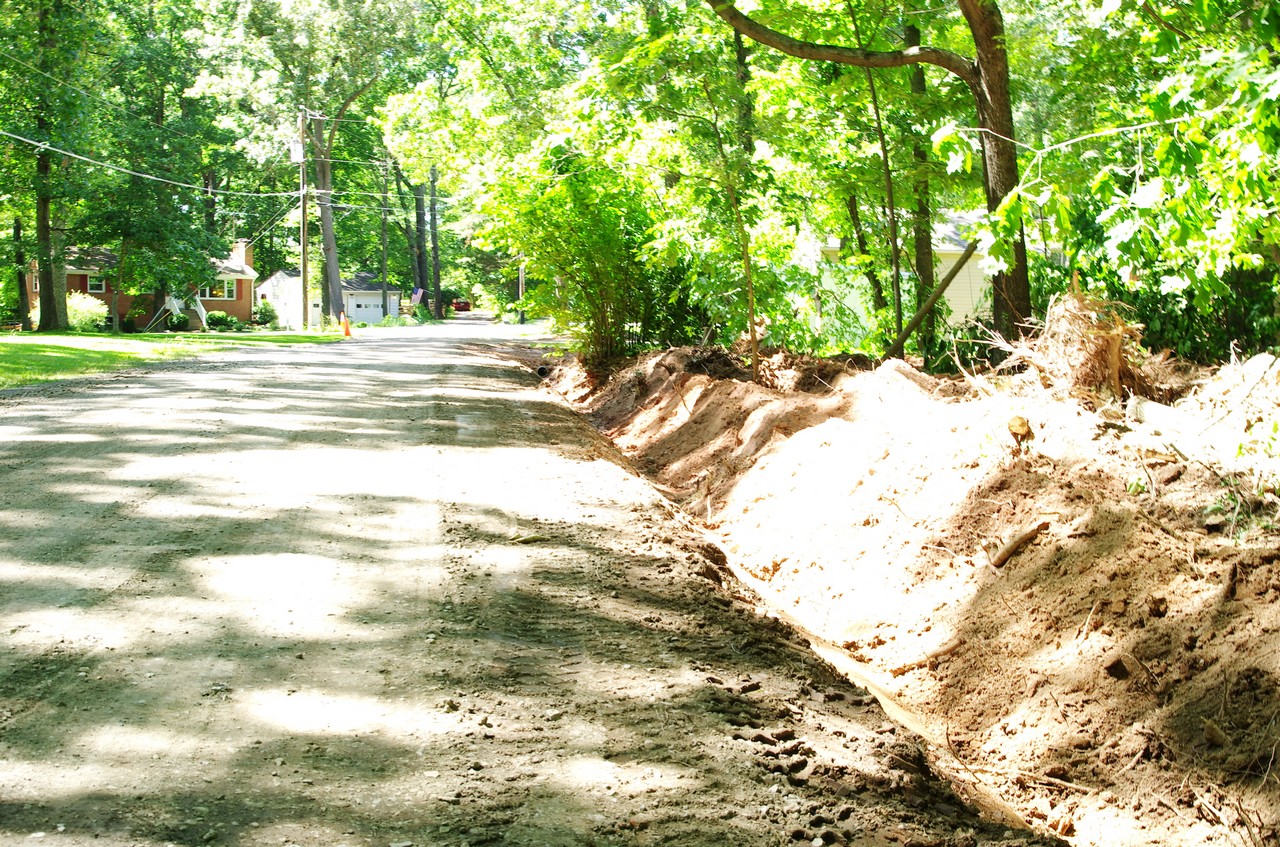

Thanks for the invite. That's very kind. Would like to see a picture of the rake. Does it allow you to maintain your road driving FORWARD?
We also had issues with local contractors, especially during hunting season when they don't show up for work. Fortunately, I live near two excavation contractors. So, I have access to special equipment if needed for a fee...
I used the 52 inch Ratchet Rake attached to the LMB to help maintain the road. ($300 from Lowes, See vendor video). I use it in forward and reverse modes. The problem with the PT in forward mode is that the tractor tends to try to roll over the front attachments. You have to take it slow with frequent stops and starts - not ideal but it can work. Helps if weights are attached to rear of tractor. Orient the bucket so the two sets of rake teeth are touching the ground and float mode is engaged. I do the bad spots in reverse pull mode. The Rip n Dig attachment may help with ditch maintenance.
