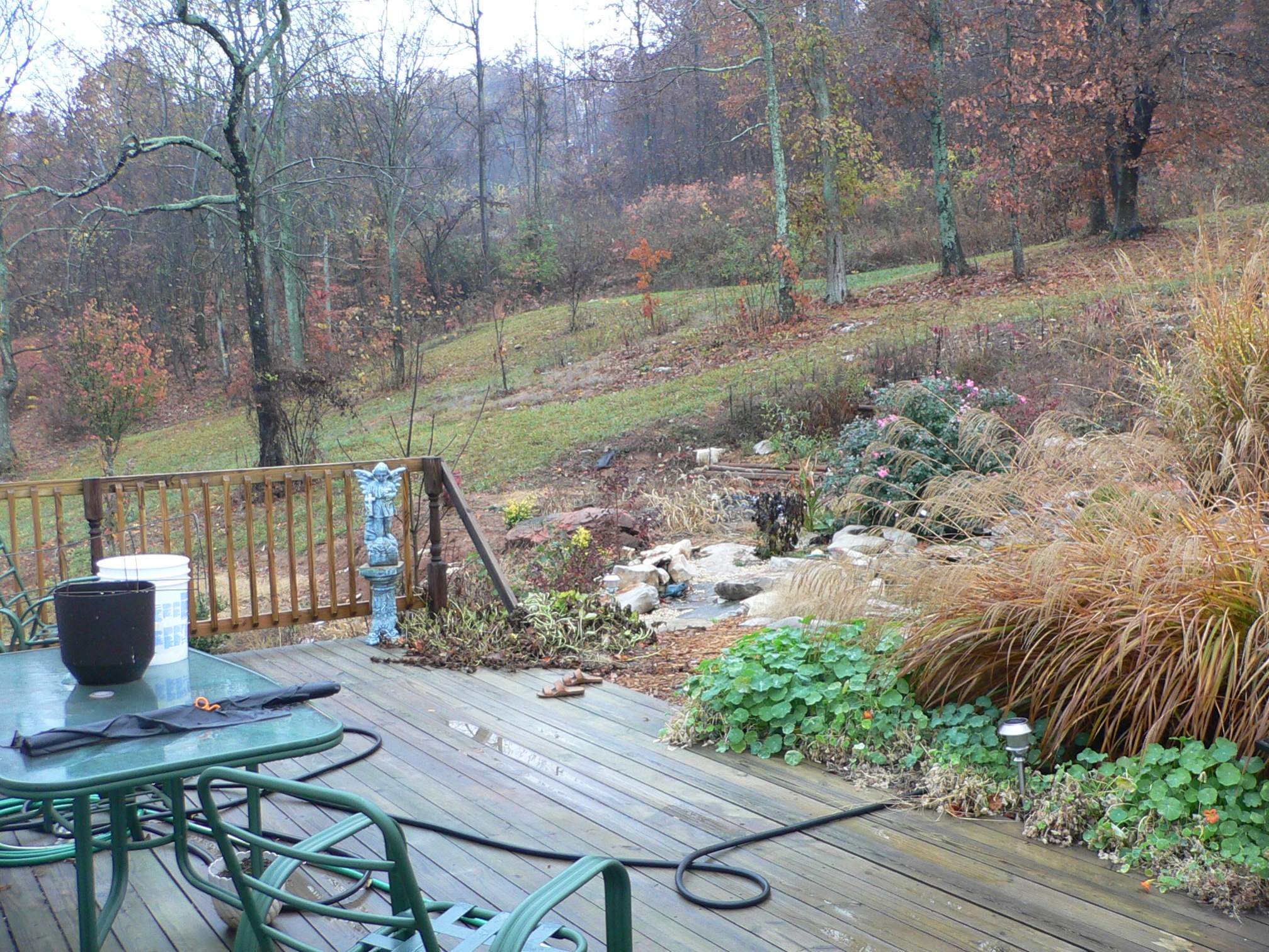

I agree with another poster - it looks like it might be a warranty problem. Also - you have a beautiful view of the hill - but why are you operating with your ROPS folded down?
   / Quick attach bucket won't attach
#24

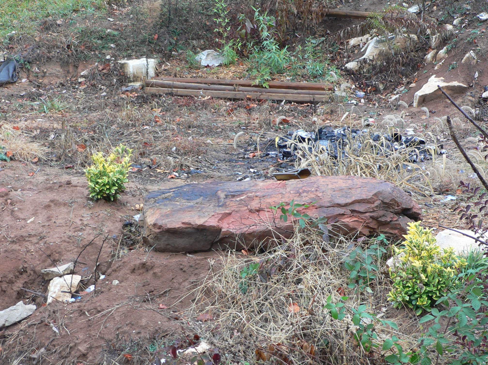

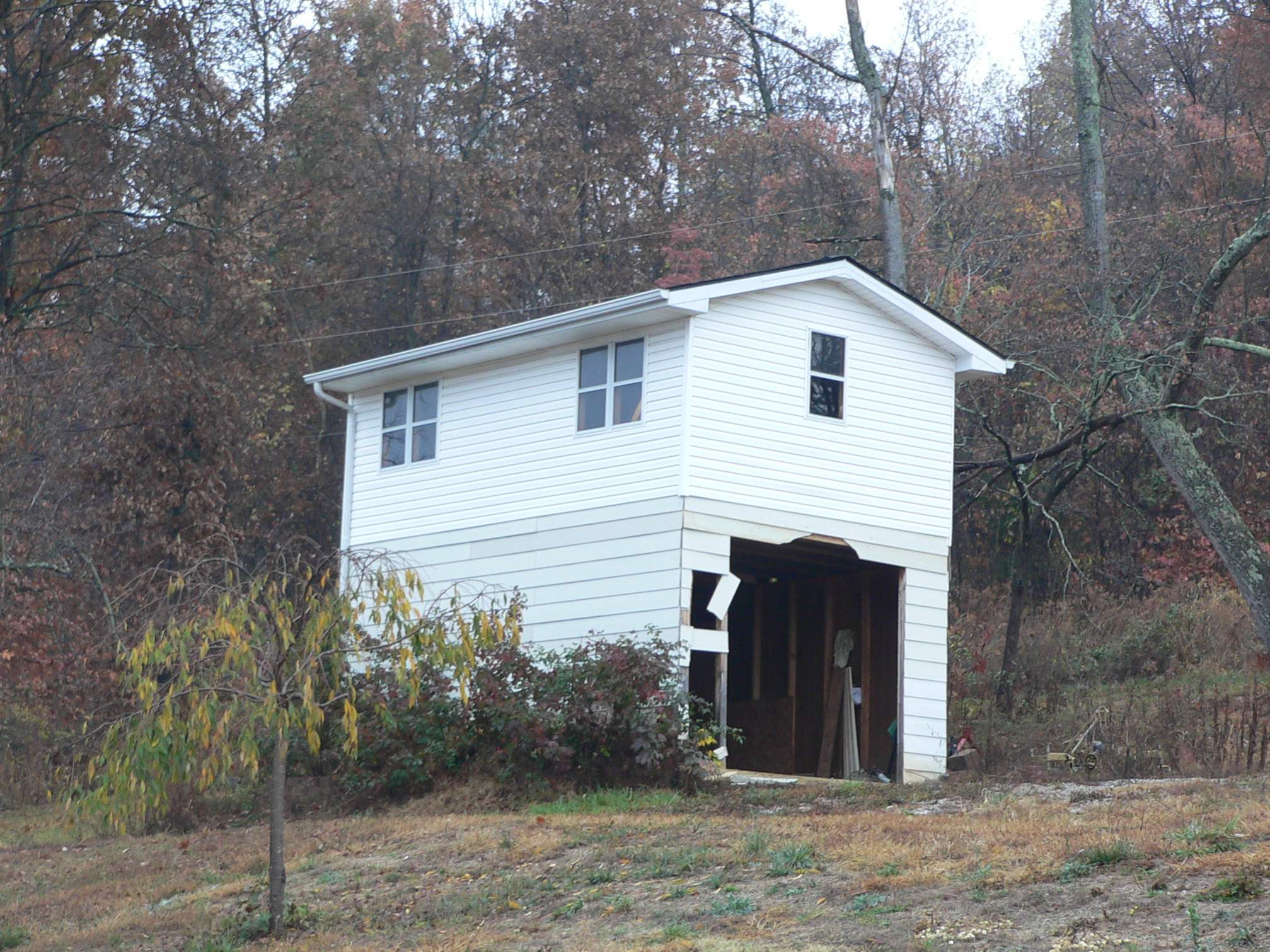

Tractor won't fit in tractor building with ROPS up. I was not operating, I was trying to attach the bucket. When I do more than move it on fairly level ground, I raise the ROPS. Picture of "the rock" that I moved with forks and tractor building showing why I lower the ROPS, now.

Didn't have the bucket on when it bent. Had forks on with a hugh rock on the forks. Drove it up the hill, layed it down and pushed it into place. Think the lower pin came out when I pushed the rock. Left the tractor with the dealer yesterday. Told him no hurry and a week would be fine to fix it and attach a hook on the top of the bucket while he has it. Will ask the mechanic how he fixed it when done. I tried the pushing against the immovable object and it didn't budge. Have this rock sticking out of a bank that's perfect for the immovable object stuff.
