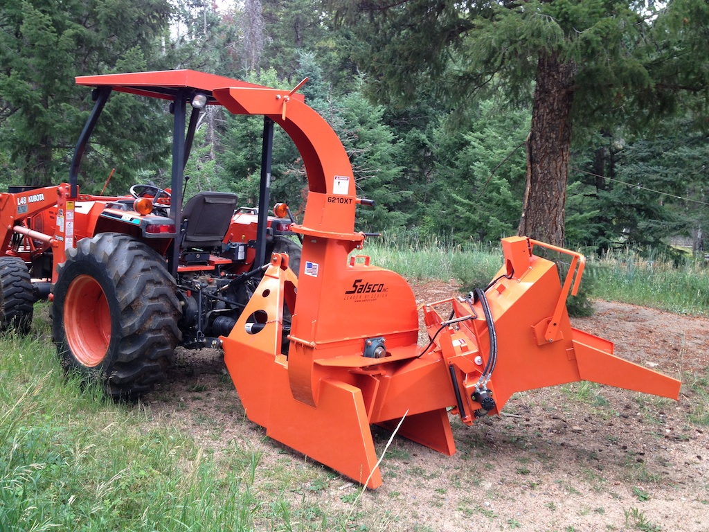

Hey folks, I just got a nice new Salsco chipper to use with my Kubota L48 tractor. Everything hooked up fine except the hydraulic lines, which I can't get to snap in for the life of me.
I notice all the Kubota quick connects (male) have a little nipple on the end whereas the Salsco lines have a little stainless steel ball. Are both these supposed to be compatible with the Kubota female side? Or is this an Ag hydraulic vs. Series B issue and I may need to swap out the Salsco fittings?
Thanks in advance from Colorado.

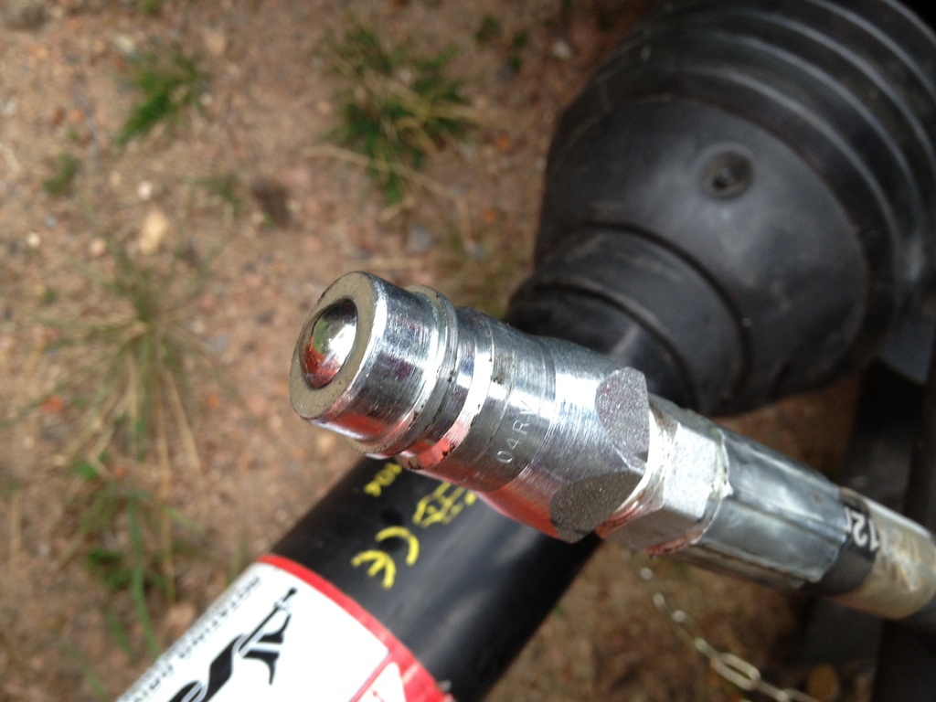

I'm thinking this may be the case. Pictures of rig below :) and of chipper hydraulic connector. Connector on the Kubota side says PARKER SERIES 60

[ISO 7241 B connectors] do NOT interchange with any of the previously mentioned couplers.
I think HHG nailed it - I just downloaded Parker Series 60 spec sheet and it says:
"Industrial Standard: Parker 60 Series couplings comply with ISO 7241, Series B Standard"
So that seems to be the problem. Now - where to find matching nipples? I don't suppose they'd have 'em at Big R or Home Depot ;)
I have the same model Salsco that your picture shows and run it off a JD. I presume your Kubota PB has one female QD on the supply side and one male on the return side which you plug into the supply side when the PB is not in use. (Both 1/2 inch QD) I presume the fitting picture you show is the supply line on the Salsco (you said it had a ball fitting not a poppet). When you stated that you could not get it to snap together I and everyone have been assuming that the fittings do not match. I am on the road and do not have mine to visually compare nor due I have the catalogs to do a visual comparison of the grooves on the nipple but that looks like the one I have. My Salsco came with 7241-B compliant fittings.
Since you can not get them to snap together could it be pressure on the internal lines of the Salsco. I had it happen once when the weather was very hot that enough pressure built up in the Salsco lines that the ball could not be depressed so coupling could not occur. Did not make sense but it did happen.
I presume the Kubota has been turned off and pressure relieved on the PB as you can not plug in under pressure.
Have you tried to depress the ball on the male end of the Salsco? If it will not depress with your finger you may have pressure on the line that is preventing the hookup. If so take a wrench and loosen one of the fittings on the Salsco and relieve the pressure. It can be on the male or female end and hopefully they are not both NPT fittings but are ORB as NPT fittings can be a pain to just loosen and retighten. Have you tried to plug the Salsco male into the Salsco female and had them mate properly? That would also remove the pressure question from contention.
