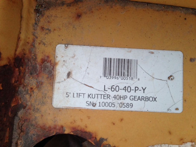

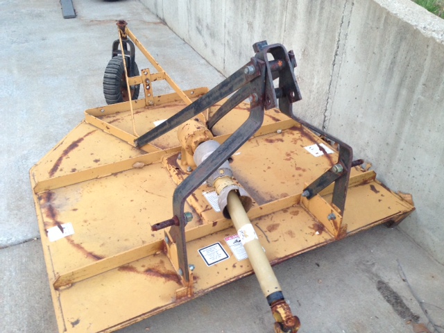

Guys, sorry for the late response - my employer thought it best that I work away from home for the last few days. Took these pics of the cutter this evening.
countrybumpkin - tried moving the uprights inside, but could not get them back together at the top link. Wondering now if I could try again with a shorter bushing and let the flex connector swing between the rear stabilizers and the uprights? Do you think I could weld a tab to the back of the U shaped piece and let it mount/swivel from that point?
EDIT - Just saw the QH adapter from Harbor Freight and Agri Supply - wondering if this would solve my problem? I'm thinking I could move the uprights inside the brackets and still have plenty of room to mount this adapter.

That's it..
/ Quick HItch Question
#17
How wide are the uprights?
About 27 3/4" or so; with the shoulders on the pins, it puts the distance at about 28 1/4" I think I can gain over 1/2" by moving the uprights inside the brackets.
/ Quick HItch Question #18
How wide is your quick hitch on the inside? (There is a little variation between manufacturers)
#19
Haven't purchased yet - but the HF in the store measures to 27 1/2 inside to inside.
/ Quick HItch Question #20
My idea won't work then:thumbdown:
I was going to suggest removing the bolt on pins and getting pins like this and welding them on to gain a little more clearance but it won't be enough.
I guess you are easiest option is to move the uprights to the inside and shorten the bushing like you were talking about.
