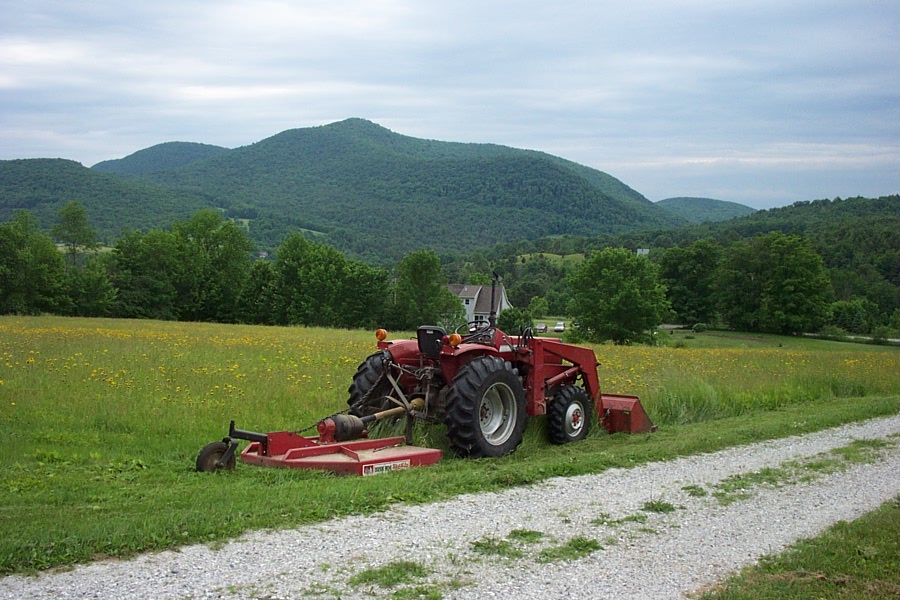

Ive used the Bush Hog Squealer for the past few years with absolutely no problems. I have the 5ft model behind my Massey, probablly could have gone with the 6 ft but its not that big of a deal. I agree with you in the fact that the Brush Bull is a heavier duty unit but is it worth another $200 ? For the type of cutting Im doing its not, mostly open meadow, although I have occassionally cut some small saplings. Im still on my first set of blades and I do occassionally touch them up with a angle grinder, that mower just keeps cuttin along ! ;)
BTW the stump jumper is a nice feature when finding rocks and stumps !
