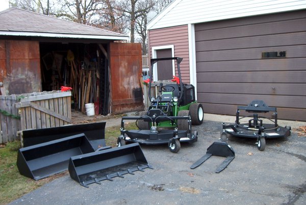

My bucket was 3/4 yard and yes, you could notice the traction difference when it was full VS empty. The concrete barrel was heavier than the empty bucket, though. I know this because one time I cracked the bucket and took it off to get it welded. I put it in the back of my pickup truck myself with some ramps. I could lift one end of it. It was all I could do to move that concrete barrel around by hand. I was lucky if I could tip it over, then roll it in that sand. Then, standing it up again was a bear! :D Maybe it was due to the compact size of the barrel VS lifting one end of the bucket?
As for the 4wd... I agree. That's why my current tractor is all wheel drive. It is a fine little loader. :D
