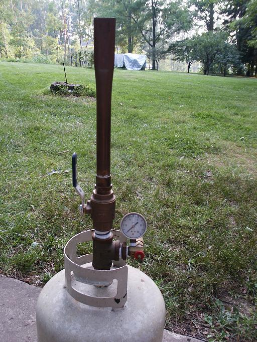

If you've got an old propane tank you can make your own cheetah.
   / R4 tire popped off the rim #25
I used to do the ether spray and pray method, but using a bead cheeter type tool is definitely the easiest way I have found. One other tip: Use a clip on type of air chuck, get some air blowing into the tire, then hit the dump valve on your bead cheater tool. When done right, the tire is on the rim, gaining pressure, before you figure out it is happening. I made my bead cheater out of an old 7 gallon air tank, and a 1-1/4 inch ball valve, and a short nipple(4"). Total out of pocket less than $100.00. Bead cheetah tool will cost you about $300.00 new, if you can't weld.:D

Hey mighty dodge, I got a question for you. Did you weld the safety blow out valve on the bottom of the propane tank shut? I thought they would blow out at about 45lbs pressure. Just thought I'd ask, no animosity on my part, the rig looks similar to what I did with the old portable air tank.:cool: :cool:
   / R4 tire popped off the rim #28
Sorry for the delay. There was no safety valve on the bottom of the tank. As far as I know it was built in to the valve that I removed.
M.D.
   / R4 tire popped off the rim #29
I've never seen one of these "cheetahs" in action... do you just shove the opening under the tire bead and let 'er rip - or is it attached to the valve? If shoved under the bead, how do you get it out of the way once the tire starts popping onto the rim?
   / R4 tire popped off the rim #30
When I use my home made cheetah I fill up the cheetah with 100lbs of air and let my compressor come up to full pressure. Then remove the valve stem core, put the air chuck on the valve so it's putting all the air it can through the valve stem. Put the cheetah nozzle between the rim and tire and open the ball valve. It hasn't failed me yet. The biggest tires I've done are my 16" truck tires.
