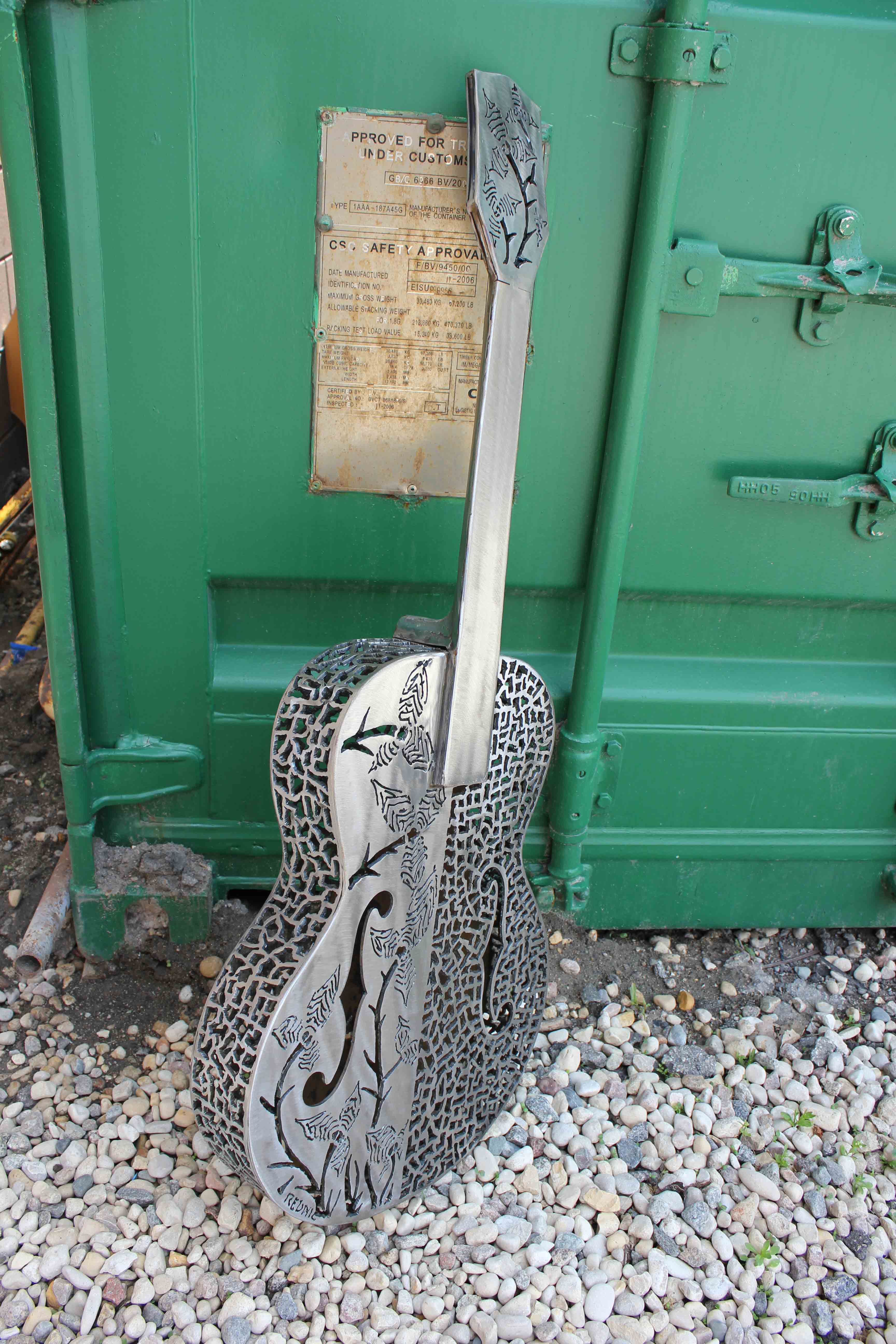

How do you guys manage to use wood templates without burning them? Do you just trace them and then freehand follow the lines?
When I've tried, I either burn the template or my cut is too inconsistent for my liking, especially when trying to make matching parts.

I use 1/4in hardboard, I run the plasma cutter right along the edge of the wood. yes it can burn a bit if you do multiple cuts. but I have templates I've used over and over for years. watch the start of this video where i'm making some augers.
https://youtu.be/0E7m3U3kuy0

You made that look easy...the cutting part. Perhaps I just need to learn how to use my plasma cutter better. I was also using plywood, don't know if that made the difference or not.

hard to say, i find the hardboard is easy to smooth out nice, so maybe the plywood is holding you back. the nicer the template the nicer the cut
