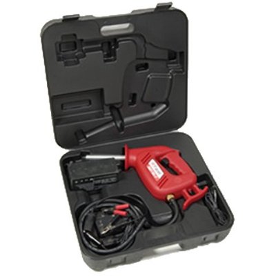

I recently purchased a "Facet Fuel-It" pump and a portable battery from Amazon. So far I like it pretty good. It's not fast like a gas station type pump, but it's speed is accepatable to me...about 1 gpm according to the manufacturer. Hook it to your battery (or buy the optional 12 volt battery) or plug it in to a 12 volt cigarette style outlet. There is also a grounding strap. It's much better than those lousy new style fuel cans.
