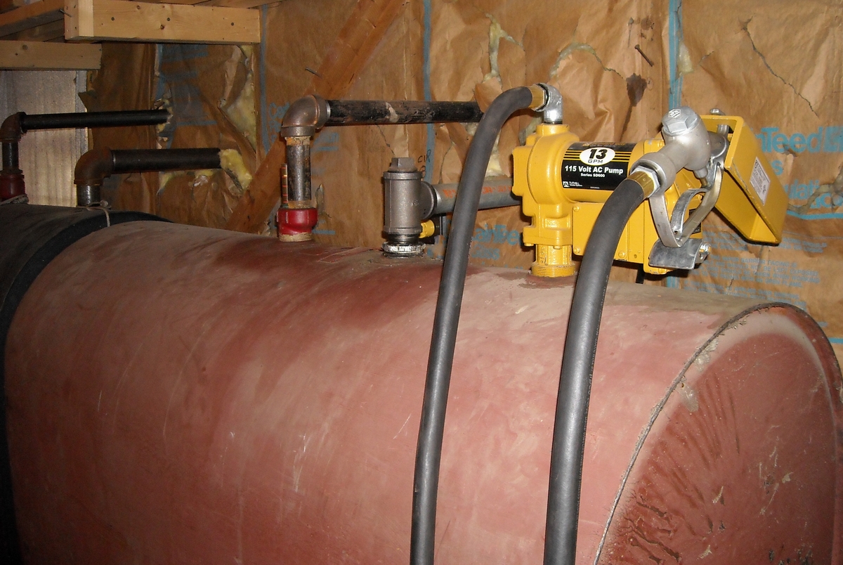

I have an oil furnace in my garage and so a 275 gallon fuel tank. I got another one year old 275 gallon tank on a deal I could not refuse (free). With the 500 gallon plus, I can heat my garage and have plenty of fuel for about a year.
I was not going to park my tractor beside these tanks and then lug 5 gallon cans so I bought a pump with 25 feet of hose.
The only thing I would do different would be a smaller pump. This pump is running on bypass most of the time because it pumps too fast for my little 6 gallon tractor fuel tank. It sure was nice fueling up the large excavator I borrowed last summer.
