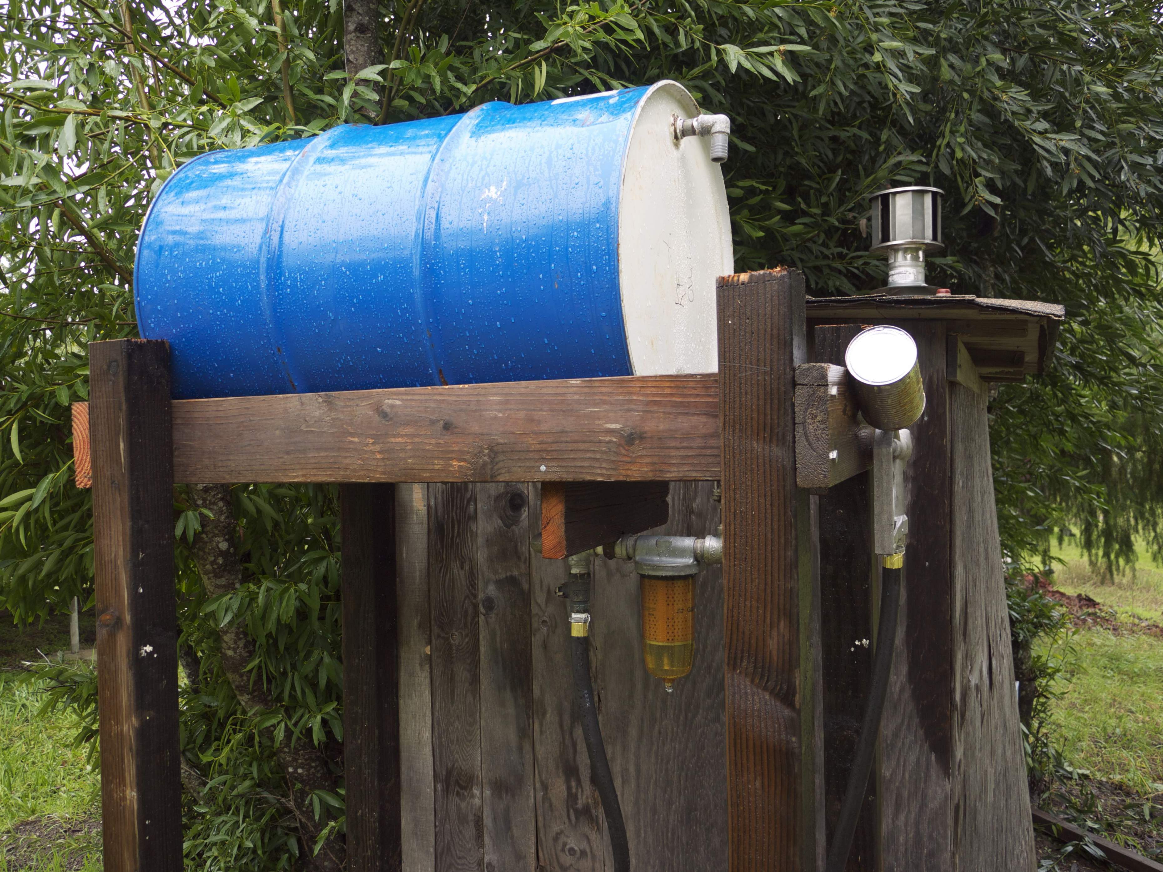

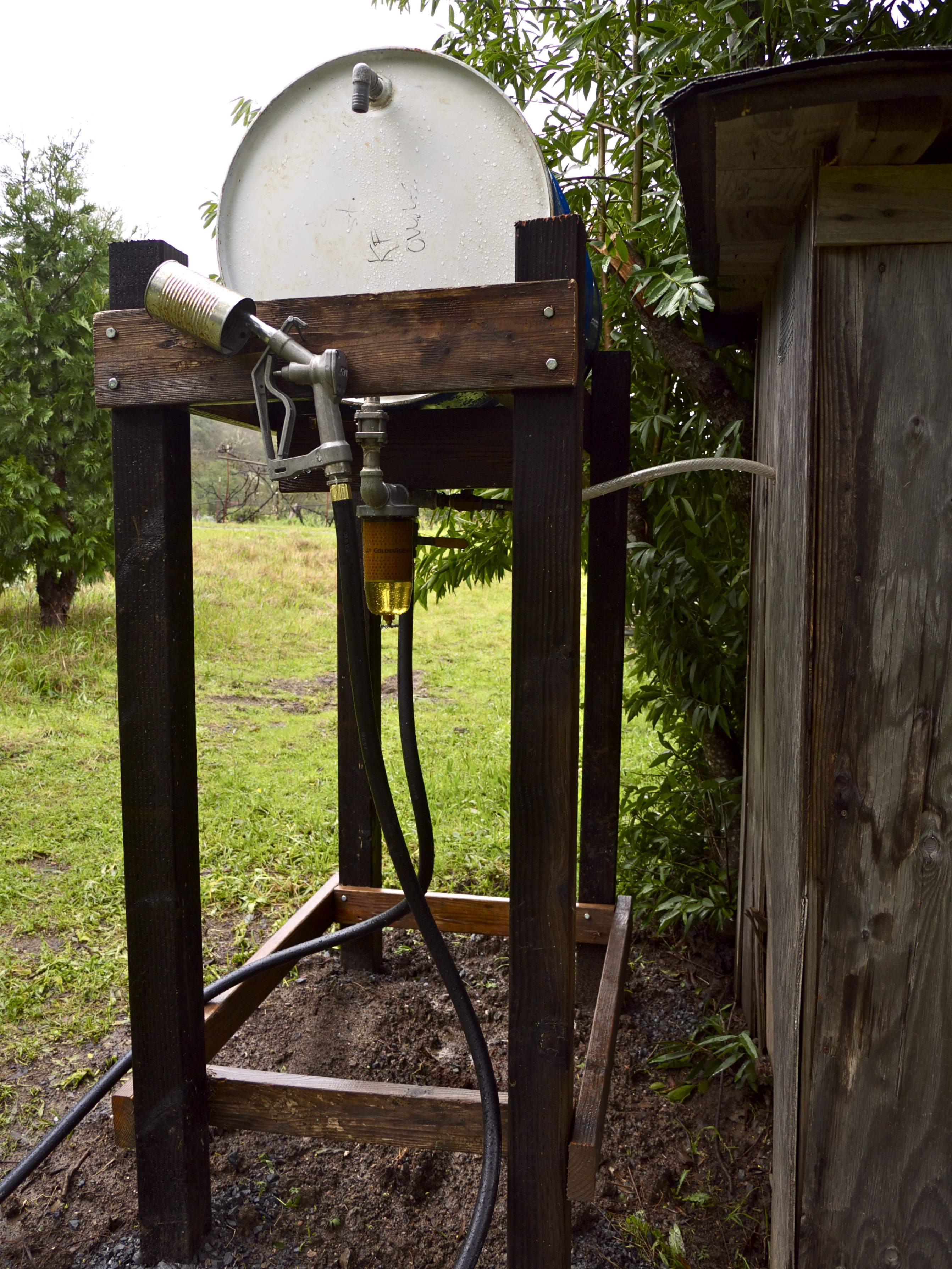

Here's my solution: two 55 gallon drums, one on the stand, the other goes to town in my truck for filling. Then it's lifted with the clamp-on forks on the FEL of the Kubota, high enough to gravity feed/fill the drum on the stand. The nozzle, hose and water separator/fuel filter all from TSC for about $100. Gravity feed for the tractor, RTV, truck, and the 10kw Kubota genset in the shed. The 2nd drum gets refilled on the next trip to town, thus there are 110 gallons on hand, which is enough to run the generator 24/7 for over 3 weeks. Normal usage (only when the utility power is down, about 4 hours/day=18 weeks.) A stabilizer is added to prevent algae growth.
