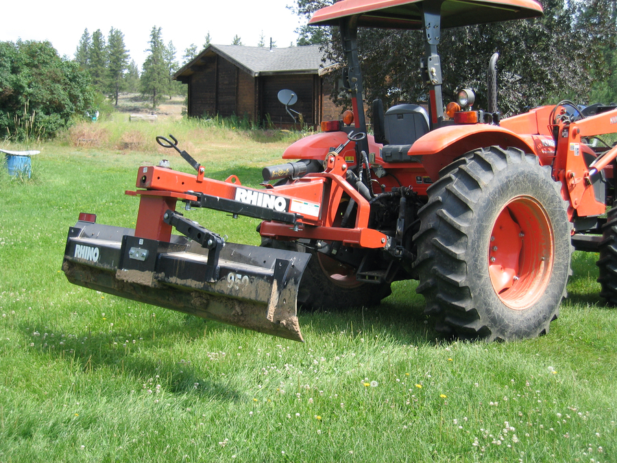

I have a HD Rhino 950 blade on my M6040. It's 96" and 1050#. I've had it and used it for seven years. It's 100% manual - except for my hydraulic top link.
I started out with a Land Pride 2584. It was - at 570# - too light and did not cut a wide enough path when angled. In the summer it just bounced and jumped down my mile long gravel driveway.
The Rhino DOES cut into my concrete-hard driveway in the summer. With ground engagement implements - weight IS your friend.

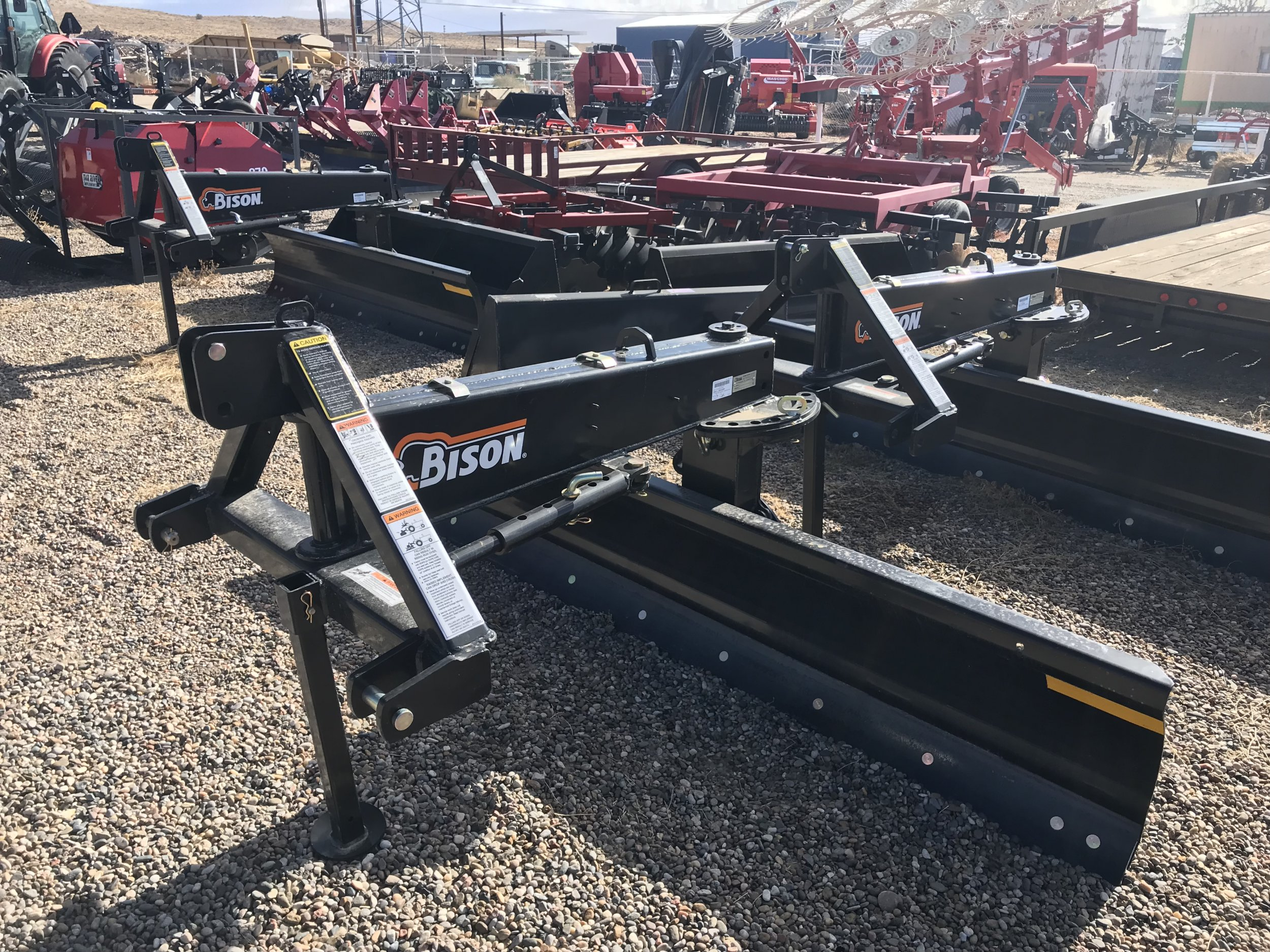

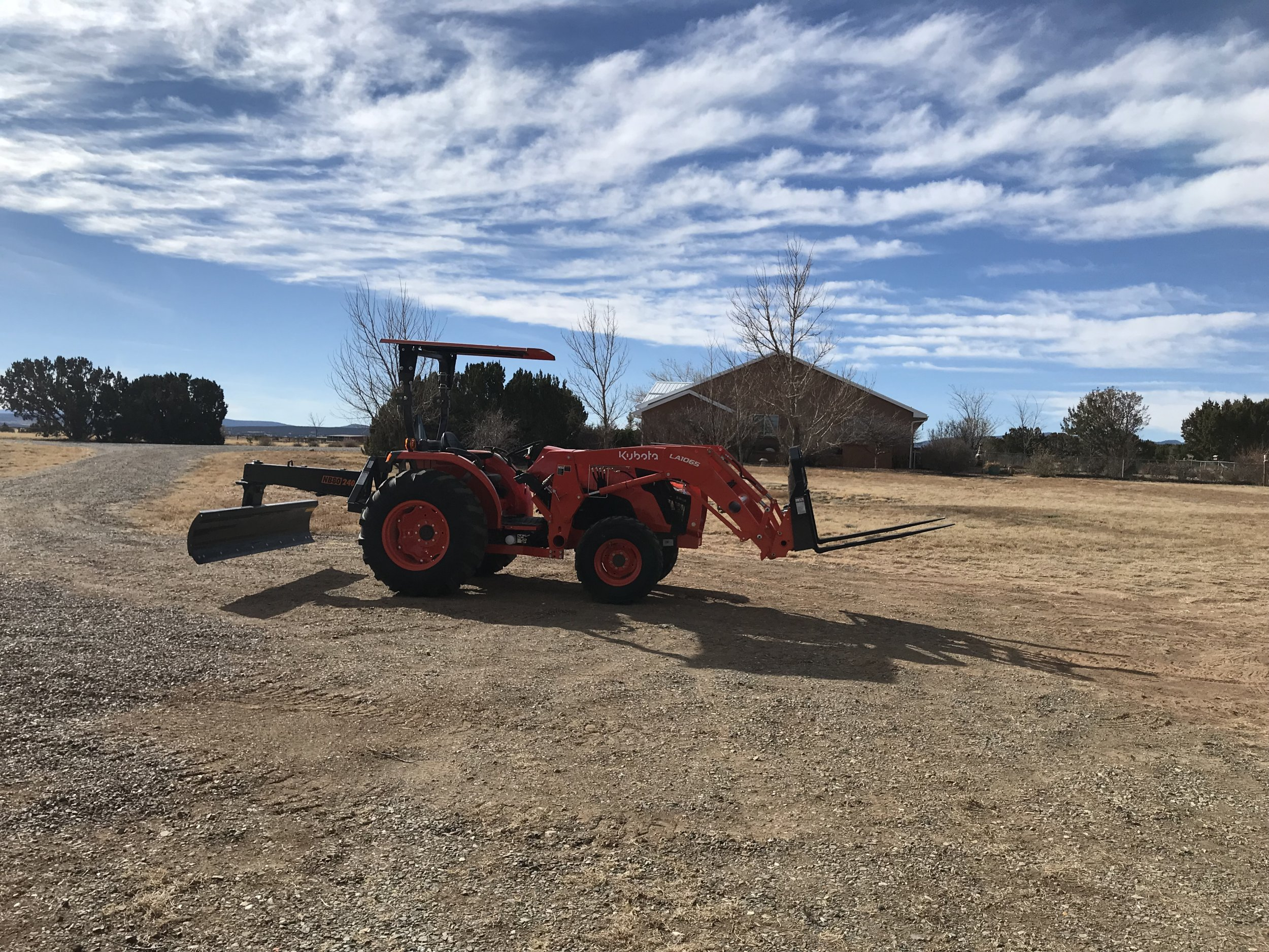

I did buy the 8’ Bison blade, and it is a category 2 blade only. It seems like a perfect blade for my purposes. The literature rates it at 970 pounds. I have loaded T4 tires and loader. The MX6000 is also turbocharged. The little bit that I have experimented with the blade, I think I’m going to really like it.
Congrats on the new blade.
I have that same blade with hydraulics on it. I used it on a Kubota 5460 grand l I used to own. It handles it fine. Very heavy built blade. I could not tell if you have hydraulics on the blade or not. The hydraulics I have on mine can tilt and pivot. Very handy set up. Enjoy the new blade.
I don’t have hydraulics on the blade or rear connectors on tractor. I can manually move and pin the blade in any of the offset and tilt positions. I know, not as handy as hydraulics, but it will work until I can add hydraulics in the future. I am very impressed with the weight and substantial construction of this blade.
