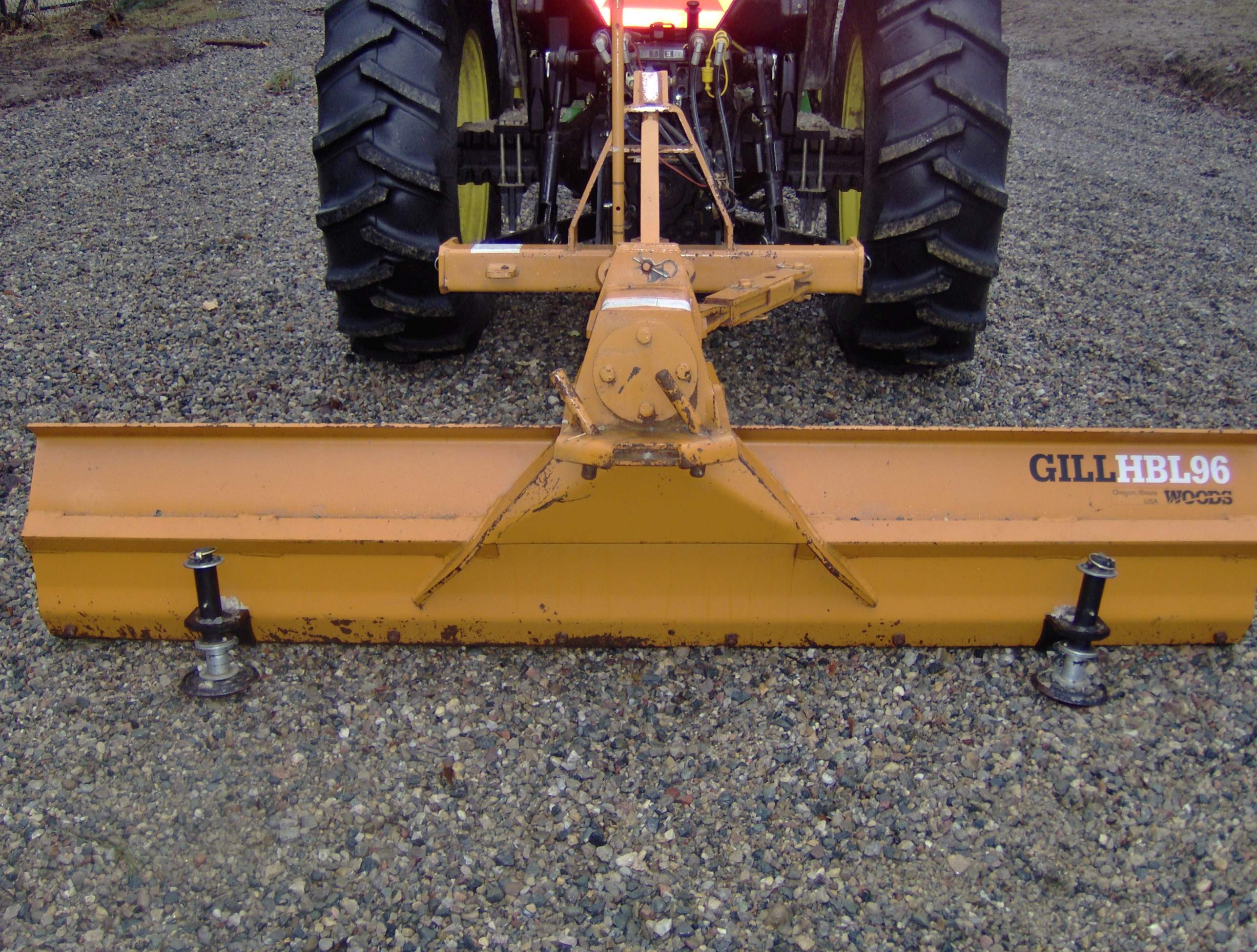

My Woods HBL96 is an excellent match for my 53 hp tractor. It's well built and tilts, offsets, and pivots any which way I need it to.
