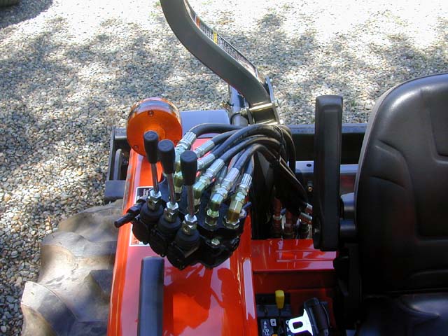

I would argue that. At about $1300 for a full TnT setup with 6 quick connectors, 2 Gannon hydraulic cylinders, a very nice 3 spool valve, tap block, and many, many, many hydraulic fittings not to mention a bunch of hydrailic hoses with crimped ends, and a bracket to hold the 3 spool valve, it's not cheap, but there is a whole lot more too it then a hose, a 3 spool valve and inexpensive hydraulic cylinders. While mine is not Kubota, it is fairly comparable in terms of quality. Kubotas mounts in the body of the L30 tractors while mine sits on top where I prefer it. The value it adds to a tractor is in my opinion second to none, especially the top link. If anyone is thinking about it, the hydraulic top link is indispensible. Rat.

Gee, I try to give some of you guys some cheaper alternative way to get hydraulics to the back of your tractor, instead of the Kubota rip-offs and you jump all over me, sorry. I did notice one you is a dealer,opps there goes some rip-off hydraulic sales. Any way, I've got some picture coming, of the part, it does look good. 5030, I used a broach bit to make a o-ring groove instead of a flat indended surface, lot less chance for the ring to kick out and leak. I mirror image the patten of the Kubota blank to the stock, so the holes are dead nuts on. The surface of the stock does not need to be milled finish but reasonably flat, the o-ring does the sealing. There is a third hole in the tractor, but it's just a blank on the piece, you have to make a O-ring groove for this one also on the part your make, to create a seal. Don't ask what it's for, I don't.

For what it's worth, I think your idea is great and thank you for sharing it with folks who really want add some rear hydraulics but find the price of the Kubota equipment more then they want to spend. Either way they will love having a hydraulic setup on the rear. I realized I could have modified the Prince cylinders and purchased a much cheaper 3 spool valve, but the Dinoil I use is very well built and gets a lot of use, especially the first spool. Anyway you decide to do it will be well worth the effort. I can't say enough how valuable TnT is for me. Thanks for the info BBell. Rat...
