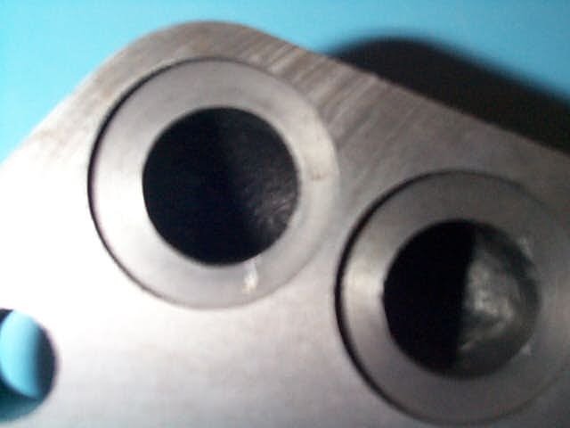

<font color="blue"> The 2 parallel surfaces of the mounting block must be symmetrical with each other so that the clamping pressure of the bolts exerts equal pressure over the whole surface of the "O" rings. Any surface irregularities in the mating surfaces would negate this uniform pressure. I am familiar with the mounting block itself and the mating surface is machined to a high degree of flatness. </font>
In your first post you also stressed that a surface grinder was required. Look at this picture. Those are mill marks. You don't get them from a surface grinder. This is a similar housing cap.

So Jerry, are you saying that you don't have to be real true on the surface, just reasonably smooth? If so Mr. 5030 is a little bit extreme? I think I'm reading this right.
   / Rear hydraulic on Kubotas the less expensive way #23
Re: Rear hydraulic on Kubotas the less expansive way
It needs to be reasonably flat, but doesn't need to be as smooth of a finish as a surface grinder gives. A quick mill job is enough, like in the picture. The point is that the surface doesn't interfere with the o-ring seal and clamps even. Mill marks are fine.

You have done nearly the exact same I intend to do
I have 25 years machine shop experience and a lifetime of farm experience.
with an o ring seal surfaces don't need to be anymore flat than
CRS steel comes and doesn't need to to be paralel at all.
A static o ring is very forgiving on both depth and diameter.
it's a great idea. /forums/images/graemlins/smile.gif

Actually, that particular block was machined on a CNC mill using Tungsten Carbide tooling.
The block in the picture was not milled in the true sense of the word.
Because I am a Journeyman Tool and Die maker and I own my own machine shop coupled with the fact that I pride myself on accuracy, in a prototype or one off scenario, I would grind the mating surfaces.
In a production environment, the surfaces are probably fly cut, or shell milled. Nevertheless, if you were to gage the flatness of the piece on a surface plate, using a dial indicator with the block jigged properly, you will find that it's flat and parallel most likely within 0.001 or better.
You might get lucky and find a piece of old stock lying around somewhere that you could counter bore the "O" ring grooves in. I am not saying that it's impossible. What I am saying is that for the block to be leak free and the "O" ring seal to be secure, the clamping surfaces need to be parallel. The chance of picking up an old piece of rusty steel and transforming it into a leak free block with the tools lying around in your garage is a fantasy. Then you are faced with the problem of either welding on the outlet pipes or tapping the block to accept fittings. The welding scenario in a garage type environment with the trusty buzz box or the home Hobart MIG, leaves a porosity question, with the uncertainty of leaks at high pressure a hazardous question at best. The answer would be to tap the block, but then again, the local hardware store doesn't carry the type of taps necessary to thread the holes.
I don't think too many people on this site or for that matter the general public have at their disposal the type of machinery and tooling necessary to perform that task. An angle grinder and a cheap drill press isn't going to do it.
