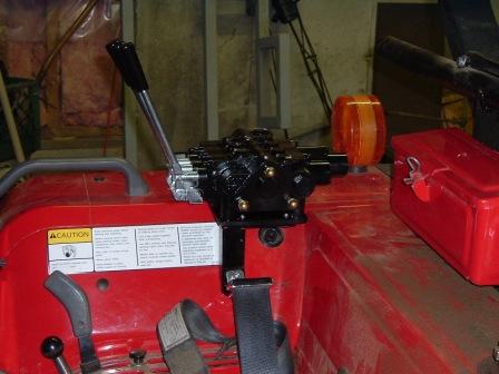

Auxiliary hydraulics update: I’ve got the rear ones mounted and they are working fine. I plan to finish the front set and get a photo of it tonight. I’ve got the dust covers on order as well.
   / Rear Hydraulics
#47
Finished the front hydraulic connector mount. I ended up drilling and tapping the loader cross brace for two ¼-20 screws. That’s Rustoleum paint BTW; there is no tractor supply store near by and my MF dealer has convenient store hours that start after I get to work and end before I leave work! My only chance to get to the dealer is on a Saturday.

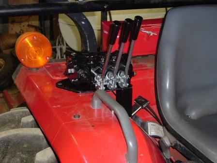

   / Rear Hydraulics #48
I don't think that I ever did show how I mounted my rear QTs. Here is a picture.
