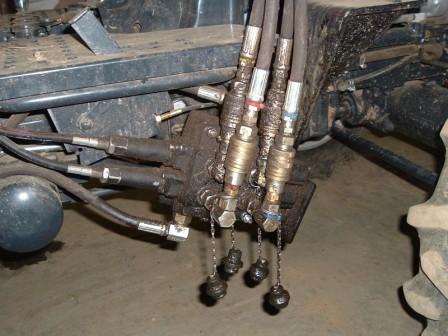

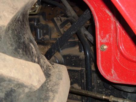

</font><font color="blue" class="small">( On the first picture, where are the two lines going?)</font>
Those lines go to my tractor mounted valve; in the second photo you can see one coming in the lower left hand side and you can just barely make out the second one near the top of the valve.
My dealer had told me to take the front line from that sump manifold, disconnect it from the tractor mounted valve and run it to my new aux. valve. Then he told me to take the return line from the new valve and connect it to the tractor mounted valve where I removed the front line. Does that make sense? /forums/images/graemlins/confused.gif
/ Rear Hydraulics #22

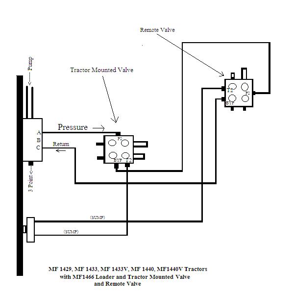

Your dealer is right on this. That is the way the picture that I posted has it. I know this is kind of confusing. The biggest problem here and in most threads like this, is that there are several different names for the same item. These different names are not always wrong, just different words used by different manufactures. BTW The T2 is a call return.

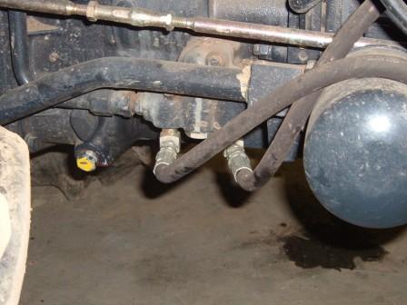

#31
Here is a shot of the front lines showing the QC's. I still need to make some brackets for the connectors. I am having issues with the fittings...They are Parker 3000 PSI version; FF-371-6FP (female) and FF-372-6FP (male) which are supposed to be very high quality. My problem is I have a real hard time (read impossible) to reconnect my dump trailer. It's always on the tractor end (not the trailer) that gives me a problem and only one side? /forums/images/graemlins/confused.gif
Very frustrating! I had to unscrew the connector and bleed some fluid to reconnect; not exactly a quick connect set-up! I must be doing something wrong?

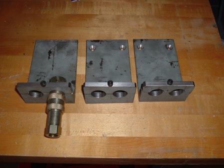

More progress! I was at my BIL's machine shop last night until 11:00 working on some wagon repairs (posted in Build it yourself) and some brackets to mount the quick connect couplers to my tractor. (right now they are just wire-tied)
This photo shows them roughed out (my blueprint is in the back)
/ Rear Hydraulics
#40
Here are the finished brackets. Two are for the rear and one is for the front (the one without the mounting holes as I haven't figured that out yet). The rear brackets will get paint and hopefully be mounted this weekend, yippee!
