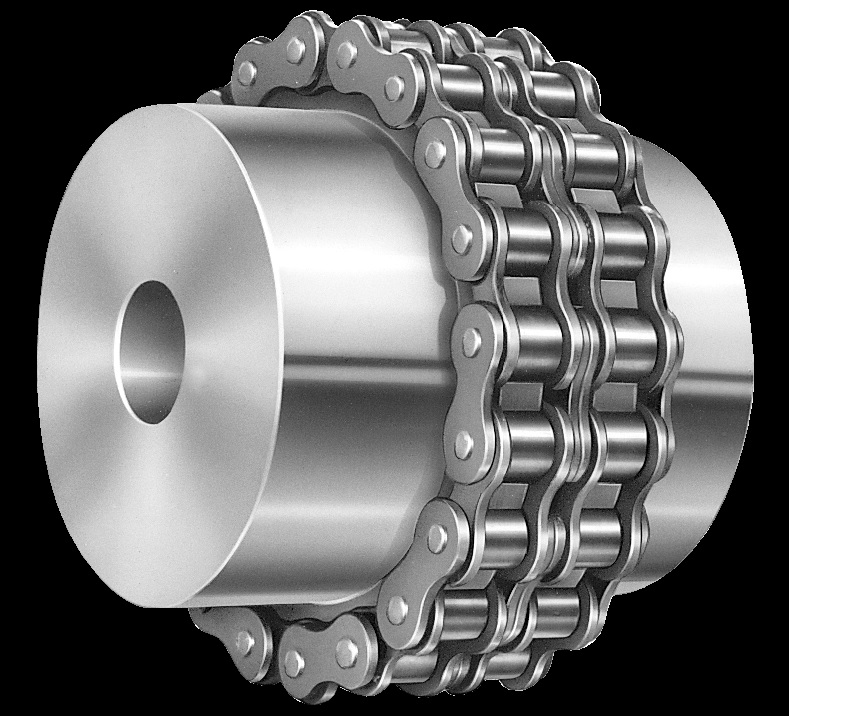

Well the new replacement blower finally arrived! I think the guy that delivered it must have driven over every dusty side road he could find before getting here. The whole thing was covered in dust and the auger drive chain was packed with dust that clung to the chain grease. Not a great idea. The dealer said he ran the blower at his place and said it was working properly. After cleaning it up and greasing the gears I ran the blower to see if there were any issues and it appears there is. Here is a video of the blower at idle speed. It appears the collar on the end of the fan shaft was not welded to the fan properly, causing the driveshaft to wobble.
What do you guys think?

I can't exactly tell from the video. Could be movement as a function of the coupler?

You are not buying a Swiss watch but rather a low cost blower.
The shaft is connected to the fan by a flex coupler looking like a double wide chain. See attached photo
At the back of the blower, the fan shaft is supported by two bearings bolted to a welded structure making up the open gear box.
This is not a real gearbox which has line bored bearing races to ensure true rotation of the shafts.
The flex coupling is not intended to support the fan but turn it which is is doing.
If the fan does not vibrate at full pto speed, I do not think there is anything to worry about.

When evaluating the movement of the shafts, think of the basic design. The fan is supported by two pillow blocks bolted to a weldment. The precision of this design is limited!
The shaft on the pto side of the fan is supported on only one pillow block and then uses the chain coupling to the fan to hold it up.
The fan shaft is not bent it is just not perfectly in line axially or radially with the shaft on the pto side. It. is the job of the coupling to deal with this condition
If it was part of an electric motor and pump setup running 1,750 or 3,600 rpm then the design would have to be different and the alignment of pump and motor would require skill to accomplish.
This unit runs at most 600 rpm. Take 10 brand new blowers from the assembly line and it would be amazing if even one did not act like the two this forum member has now or previously.
Avoiding this condition means buying a more expensive unit with an enclosed cast iron gear box.
The open gear design has served owners for decades but is not found in commercial grade equipment for a reason.
Dave M7040

Bearings using an eccentric locking collar have runout built into them which is why they aren't used on things that require precision, no vibration or that run high speed. You can use an indicator to check how much runout there is but it wouldn't surprise me the manufacturer will say that runout is within their design limits.
Also, the input shaft may run truer when a load is put on it. I can't see the input shaft bearing in the video but I would imagine they used a self aligning bearing, probably a pillow block with an eccentric locking collar, that will self align once a load is put on it. Keep in mind that self aligning doesn't mean it will run perfectly true, it just means it will run true enough for the intended use.
