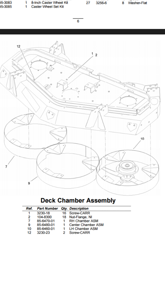

My preference is my Recycle Deck:
For knee high grass ground speed would be very slow or two passes with the deck set high on first pass.
