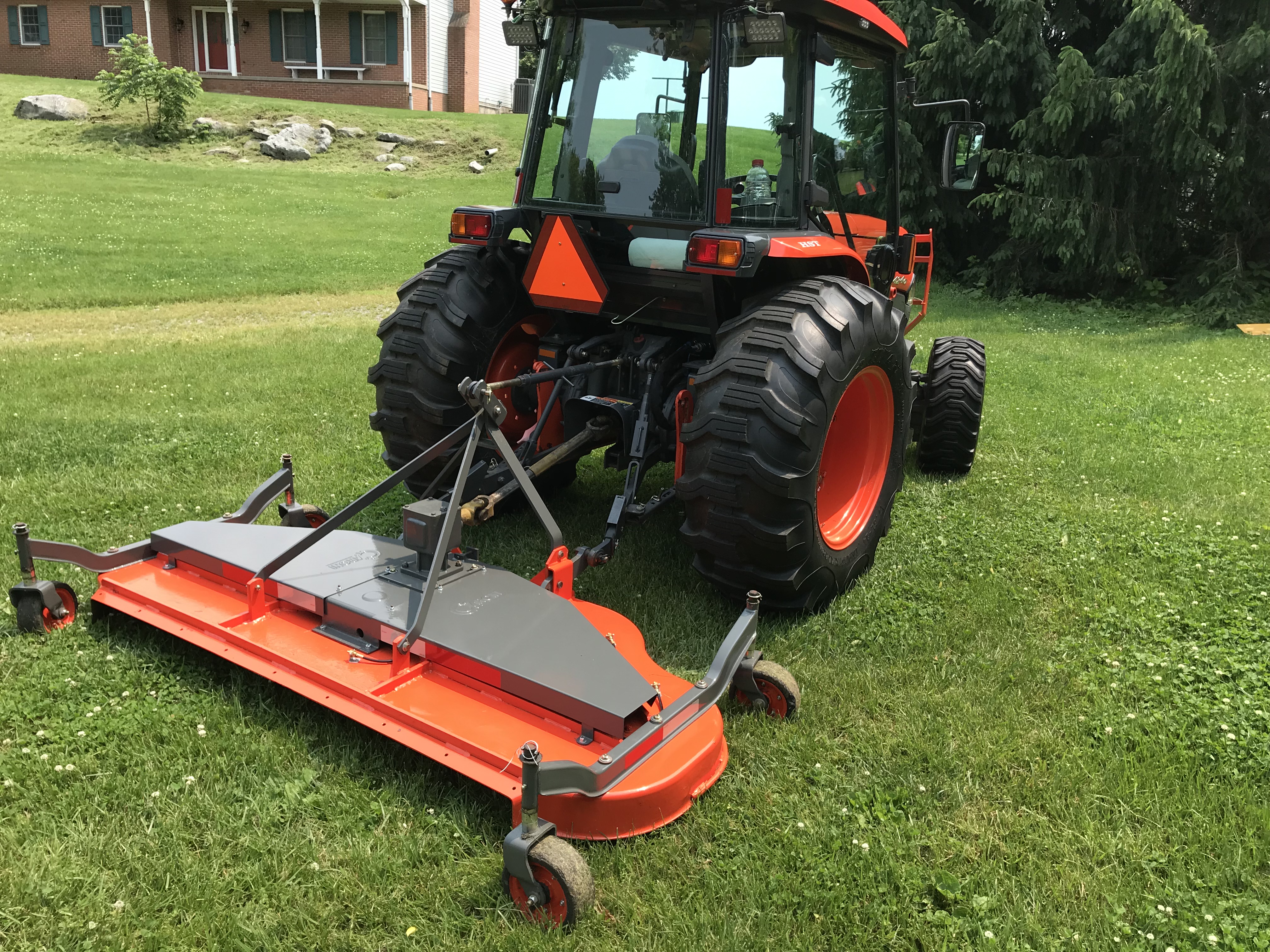

I've used a 3 pt rear discharge Bush Hog brand finish mower (7 ft) and it left a really nice cut and dispersed the clippings evenly with no clumping. It cut tall grass really well too due to the size of the mower deck. I sold that mower and bought a F3080 with 6' rear discharge deck, and while it's a lot more maneuverable than the 3 pt mower on the bigger tractor, the rear discharge deck doesn't leave as nice of a cut and clumps terrible unless the grass is really dry or mowed very frequently. While I really like the F series mower, the RD deck sucks. I'm not sure why the 3 pt RD was so much better. I've tried Gator blades, which help a little with the clumping, but the cut quality is even worse. If I could do it over I would have gone with the side discharge.

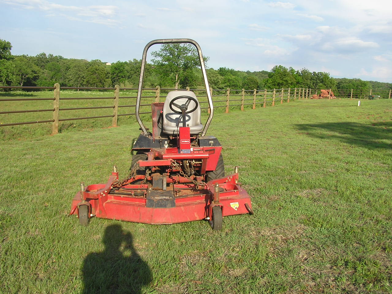

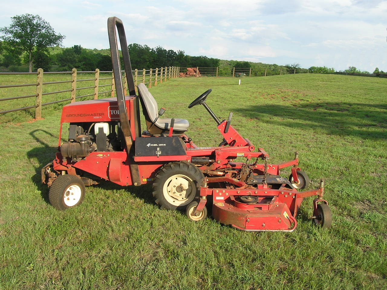

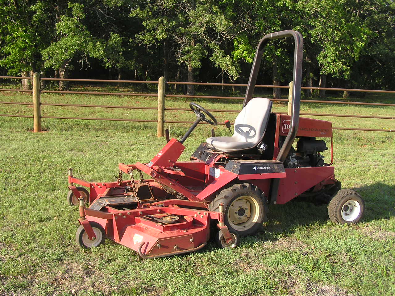

Had a few side discharge decks and two rear discharge. If the grass isn't too long when cut any of them are OK. My side discharge decks have all been right-side discharge. Generally I went counter clockwise and blew clippings away from the center as the mowing pattern shrank. To switch things up I've mowed different patterns with a side discharge but not when the grass was high. Rear discharge really frees you up to go in whatever direction you want.
Here are a couple pics showing the RD deck and the cut / uncut grass in front of the tractor. This is taking probably 3-4" off.

Well that looks pretty clean if you ask me.

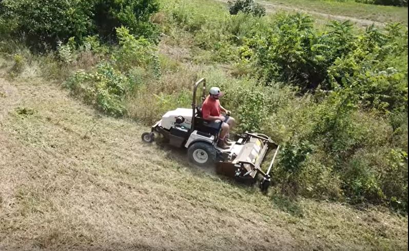

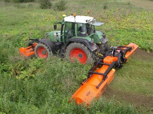

I spoke to some other companies... they suggested a "flail" mower.
I must say I didn't understand what that was, I had a look at them in use...
They cut short/tall grass without issues and they disperse the grass (rear - discharge if you will, it doesn't shoot out the side) very evenly and nicely. Even picks up the grass the wheels just flattened to not leave uncut areas.
I was quite surprised how neat that mower leaves things looking and what sort of conditions (if your lazy and want to mow once in 2-3months) it can cut in without having to make 2-3 passes.
Can a properly set up flail mower be used as a finishing mower? - If I am not mistaken they use something of the nature on golf fairways - if they do... then well it seems that gives you the best of both worlds. Tall or short grass and a beautiful finish. 1 Mower that seems to do everything?

I used a flail mower for years cutting pastures & open lots for other people. It performed very well cutting short or tall grass/ weeds. Keeping blades on the drum is a challenge sometimes depending on what you are cutting. When a blade is thrown off, you know it pretty quickly due to a strop of uncut grass & vibration. I had to replace the drum & bearings in mine due to it being so out of balance, that alone was a little over a $1000 20 years ago. Finally got rid of it, got tired of replacing blades.
