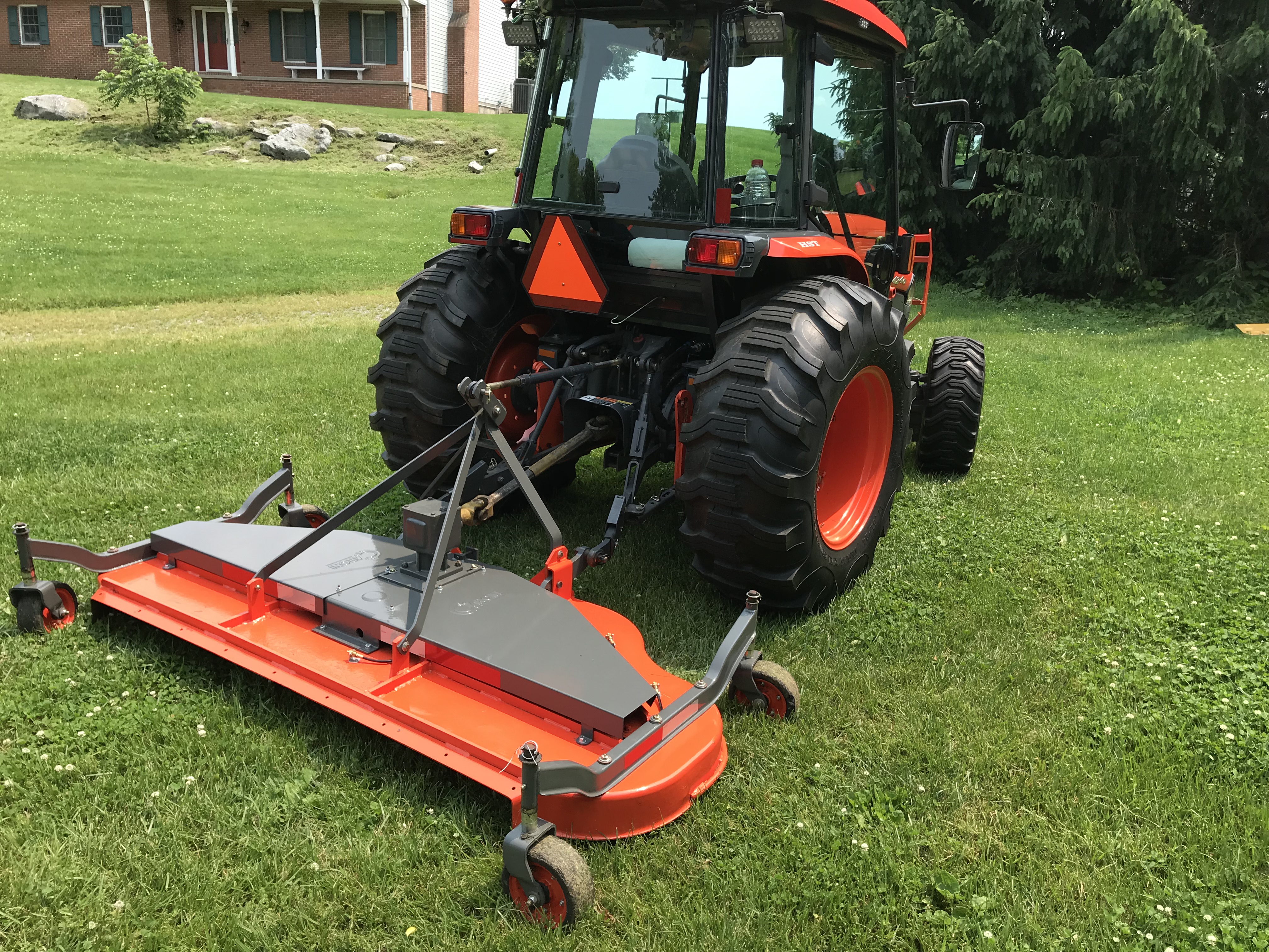

I've used a 3 pt rear discharge Bush Hog brand finish mower (7 ft) and it left a really nice cut and dispersed the clippings evenly with no clumping. It cut tall grass really well too due to the size of the mower deck. I sold that mower and bought a F3080 with 6' rear discharge deck, and while it's a lot more maneuverable than the 3 pt mower on the bigger tractor, the rear discharge deck doesn't leave as nice of a cut and clumps terrible unless the grass is really dry or mowed very frequently. While I really like the F series mower, the RD deck sucks. I'm not sure why the 3 pt RD was so much better. I've tried Gator blades, which help a little with the clumping, but the cut quality is even worse. If I could do it over I would have gone with the side discharge.

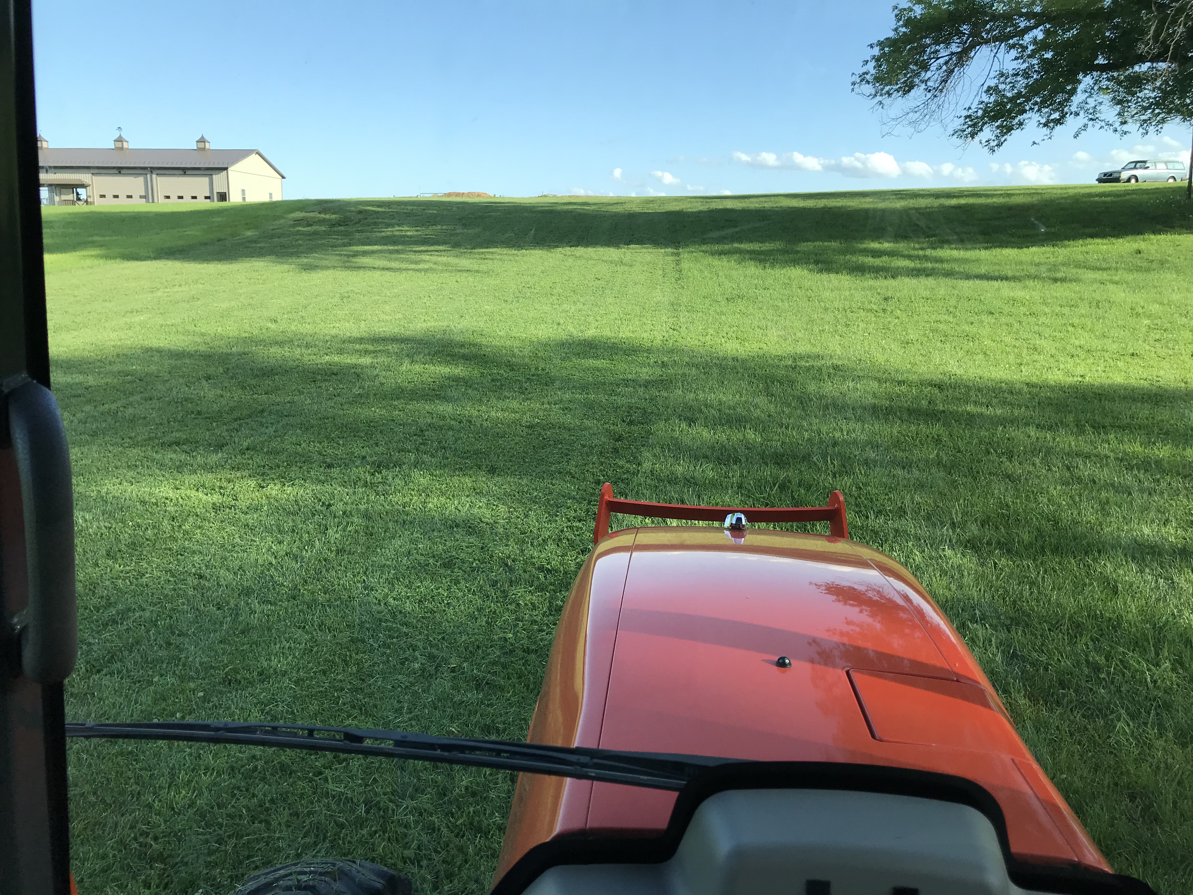

Had a few side discharge decks and two rear discharge. If the grass isn't too long when cut any of them are OK. My side discharge decks have all been right-side discharge. Generally I went counter clockwise and blew clippings away from the center as the mowing pattern shrank. To switch things up I've mowed different patterns with a side discharge but not when the grass was high. Rear discharge really frees you up to go in whatever direction you want.
Here are a couple pics showing the RD deck and the cut / uncut grass in front of the tractor. This is taking probably 3-4" off.

Well that looks pretty clean if you ask me.
