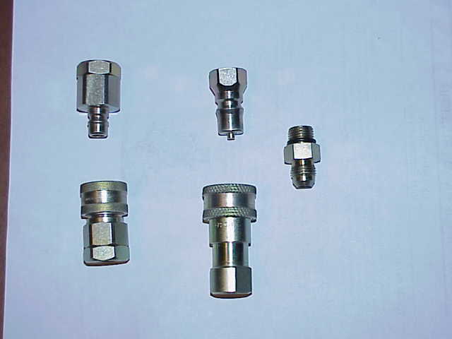

I will try to explain that to all, and I am just picking MadReferee's post as the one that is handy.
The rear remote has 3 hoses in the kit and a male and female disconnect. Also contained in the kit is a small adapter that goes on the transmission after you remove a plug. This is the return from the valve to the sump. The instruction say to run the two long hoses to the front of the tractor and </font><font color="blue" class="small">(
8) Disconnect the loaders power beyond hose (1 & 2). Connect the remote valve pump hose (A) with male quick coupler to the power beyond hose (1) off the loader valve. Connect the remote valve power beyond hose (B) with female quick coupler to the power beyond hose (2) off the tractor. See the photo to the right. )</font>
This is where the problem lies... the quick disconnects that they supply are different than the quick disconnects that are in the kit. (See Photo). The supplied quick disconnects are on the left and the type that are on the tractor are on the right. My question to Kubota was... do you remove the factory installed quick disconnects and use the quick disconnects that are supplied in the kit to make the connections? If this is the case, then they would need to supply 2 complete sets (1 male, 1 female = 1 set) of quick disconnects to complete the installation. I have a feeling that they want you to have different type of quick disconnects, so if the loader and valve is removed, that the rear remote isn't disturbed. I know that I can make it work with the spare quick disconnects that I have, but I want to know what Kubota intended before I do this.
This is being installed on a BX22, which I believe has a different plumbing set up from the rest of the BX series. If anyone wants to know the lengths of the hoses and types of ends, I will post them later on. After seeing this set up, I realize that I could have done it less expensively by not going with the Kubota kit. I chose to do it this way, because I didn't want to jeopardize my warranty if something went wrong later on. I know now that I could have had this set up made up locally for less. This is an advantage that others will have from information that I will post at a later date. I just want to get this set up correctly the "Kubota way".

The coupler supplied appears to be a SafeWay series 70 coupler but I could be wrong on that. If so, they are noted for being able to connect and disconnect under full pressure. I can see no other reason for having this type of coupler. It almost appears that the engineer just mis-spec'd the couplers.

All I can add is the connectors on the left are the same as the ones on my BX1500.

Ken...... thanks for that information.... the quick disconnects on the BX22 are the type on the right. You may have answered the question for me..... the kit is different for the BX1500 than the kit for the BX22?????... Now the next question to be answered is.... does Kubota know that they are using two different disconnects on the BX series? I am also wondering if there might be a change of connectors based on the year of manufacture along with the model of the tractor? What month/year did you purchase your BX1500 tractor????? Does anyone else have the connector on their BX that is like the one pictured on the left side? We might be able to figure this out before the engineer gets back on Monday from Boston!! /forums/images/graemlins/grin.gif

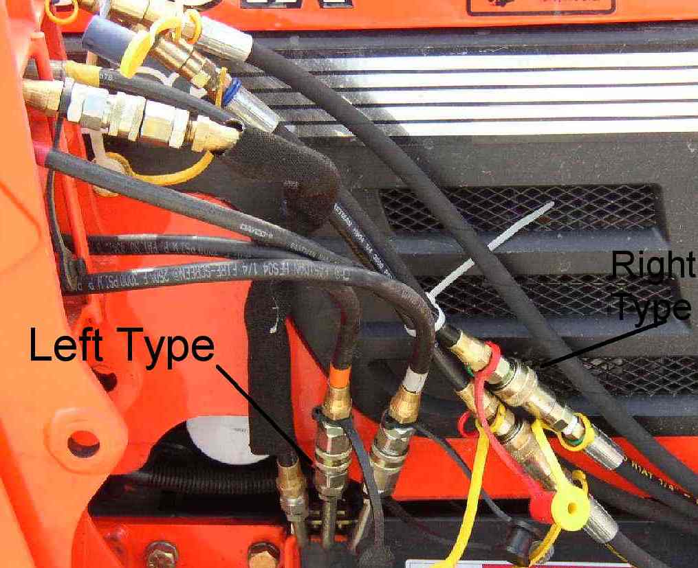

My BX22 has the connector type on the left, but the hydraulic lines used for my front blade mount are of the type on the right. (As you know, on the 22 the valve stays with the loader; therefore I had to plumb in QD's of similar type to the blade mount lines in order to remove the loader but keep the valve with the tractor.) Attached is a photo showing both types.
I suspect that somewhere along the line Kubota changed types - or they just use whatever type they can buy cheaper, and therefore sometimes you get the type on the left and sometimes the other.
