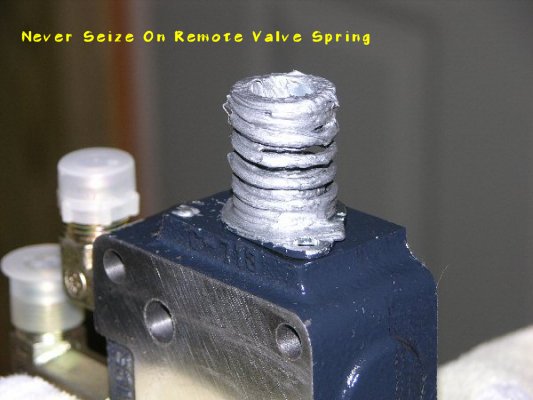

I would also advise using a good pipe thread sealant. I even put a little on the flared threads knowing that it wasn't necessary but using it as a lubricant to help me get everything tight. As Jim said you don't want remote number one to leak after 2 and 3 is in position or you'll be cussing a blue streak.
Jim had some corrosion issues with the innards of his rear remotes so I disassembled mine right out of the box, even before installing them and coated the internal parts like the springs and such with Never Seize. (see picture) The heavy grease prevents rusting and galling and makes disassembly at a later date much easier. It may be a bit overkill but I figured it was easier to do it at that time then a year or two later.
Be extra careful with that filled rear tire. /forums/images/graemlins/frown.gif
