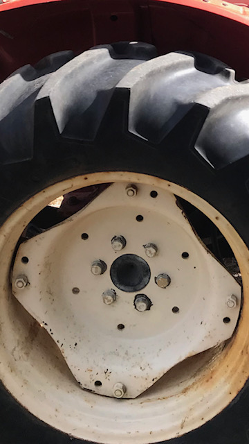

Hello everyone... I'm the proud new owner of a Yanmar YM276D. I can't wait to tinker with it and make it mine.
For starters it has a flat tire on the rear, when I tried to put air in it the valve stem broke off due to dry rot. The other side looks just the same. So I plan on taking the rear wheels off and bringing them to a tire shop to get fixed up.
My biggest question is what size is the wheel bolt on the rear wheel? I want to be sure I head up to the property with the right tools so I don't end up stalled before I even get started. Also are these inner-tube tires? Calcium filled? Any thoughts, tips or tricks would be great!

I have researched it a bit and found various results... mostly anywhere between 22mm and 26mm. thoughts?

I also have a 276D. I use a 6 point SAE 3/4" socket set to remove the wheels. No idea on the proper size, but can say that there is no need to use 3/4" metric sockets if you don't own them.
A 19mm and a 3/4” socket are the same size.
Sorry, I have no ideal on the bolt head size on a YM276. In my YM2002D on the rear are 22mm.

Thanks everyone! Great help. It will be secured well and I plan on using an air impact set for removal so should have plenty of room to work and torque. I hope to do just tubes as I too have tons of lug left. I値l cross my fingers and give it a go.

Heavy tires? There was a $100 coupon for the HF 1 ton shop crane so I used that.
I was able to roll the tires out of the way after removal - but barely. I couldn't have loaded them into even a low trailer.
These are 11.2x24 and I had drained the water ballast down to where I couldn't get more out.

Thanks again everyone... successful few days as I got the tires off, to the shop, and back all fixed up.
FYI for future reference it was a 1 inch bolt that held my rear tires on. They were fluid filled and heavy as all get out. After blocking everything up and putting my front bucket on the ground to ensure it wouldn't move, I jacked it up put it on 4 jack stands (2 primary and 2 extras further up just incase) then took off the bolts with a 1 inch socket and a flex head 15 inch breaker bar. I was able to roll the tires up onto my snowmobile trailer with its ramp down (don't attempt this unless you ate your Wheaties)... it probably wasn't the smartest thing I have ever done ;-)
around 200 dollars later at the tire shop I have two fresh tubes with squeaky clean valve stems. I opted to not have the fluid replaced as they couldn't get my old fluid out and i didn't want to pay $5 a gallon at 30 gallons per tire for the stuff they had (beat juice). I'll see how she does without the fluid this winter blowing snow and go from there. I see there are lots of cheaper options out there for fluid in tires anyway.
