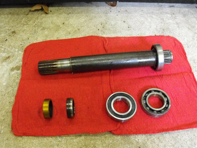

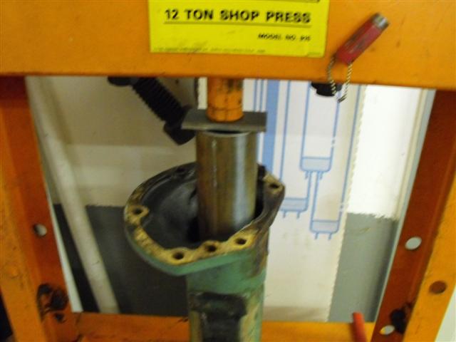

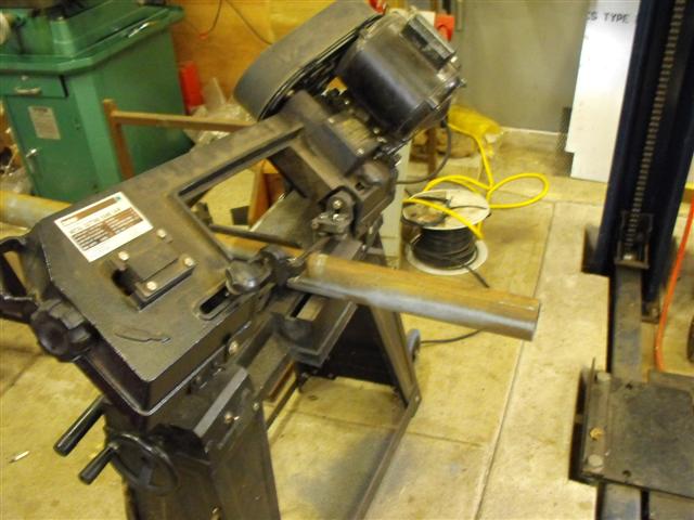

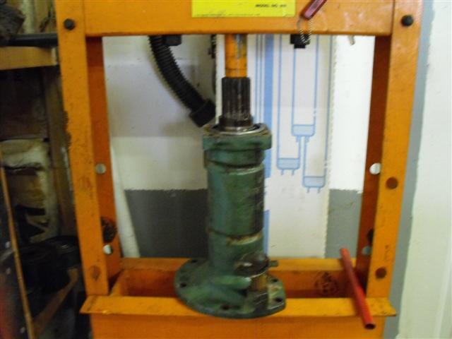

I think the 2000 and the 1900 are pretty close in the way the bearings come out. Here's some pics of mine when I changed the bearings and seal.
The piece of pipe was used to push the new bearing back in.

Clemsonfor, I can't view your pictures. Maybe because I don't know how. Message comes up "Invalid attachment specified".
Would seem to me the best way to change that sleeve is to remove the axle housing as Gary did. I'm not sure you would have to have a press to do the job. I'm sure it might make it easier. My experience would lead me to believe the bearings will not be that tight fitting. The sleeve probably is. Looks to me like the shaft with bearing would tap out of the axle housing once removed. Then you could use your puller to remove the outer bearing and sleeve.
Normally, a sleeve like that without an o-ring seal would be a shrink fit. Reason being it would leak if not. The parts drawing does not show an o-ring. If you determine to remove it take a chisel and hammer and whack it good. It would most likely help to loosen it for easier removal.
As you know I haven't been there done that, just surmising in my mind how it all goes together. Carey and Gary are the ones to really listen too.

I pulled out the service manual. To get the axle off i need to pull the PTO unit. There is a bolt that retains the axle to the axle gear. you remove that 1 bolt from the inside then the bolts on the axle tube. It appears the whole assembly then comes off like gary shows. Then i think you would need a press to push the shaft with the bearings on it out of the tube, along with the ring once it was heated?
