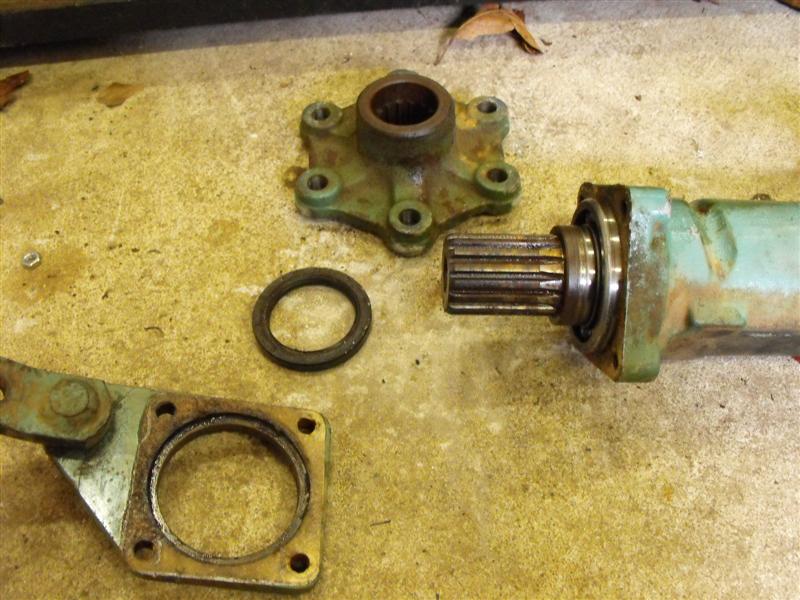

I did the left and right sides differently to see how they would hold up. The right axle was removed and the bearings, seal collar and seal replaced as you see in the photos. For the left axle I just replaced the seal collar and a new seal. Both sides worked fine until this year when I noticed the left axle starting to seep oil out again. Why it is leaking I am not sure. May be something with the bearing and maybe not. Either way, I will pull the axle and replace the bearings. It is very important to replace the seal collar either way.
You can see from the photo, that bearing is going to be hard to get a hold on to pull it out without taking the axle off the tractor and pushing it out from the inside. If your just going to replace the seal collar, it will come off pretty easy with just a couple of screw drivers pushing on both sides. Take care not to scratch the new one putting it back on and make sure the axle is very clean.
I did say something wrong in my previous post about the piece of pipe. I had to use it to push the outer bearing out. If you don't have a press you could knock it out with a hammer and a pipe but be careful to support the axle housing evenly so you don't take the chance of damaging the housing. The bearing on mine was stuck in there pretty good and it took some pressure on the 20 ton press to get it to move. Once it broke free, it pushed out smoothly. The PTO comes out real easy as one unit and goes back in easy.

I may have a tip on the seal collar. I deal with seal collars on Toyota truck rear axles quite often for seal/bearing replacement.
Anyway if you have a dremel or real small die grinder all you need to do is use a 3/4" dia cut off wheel cut a long diagonal cut across the collar from close to the bearing out (if you nick the brg race its no biggy) and get as deep as you can we are just trying to weaken it at this point not cut it off.
Then simply take a sharp chisel and strike the collar in the cut you made and with the axle supported solidly and it will spread the collar and it will fall off a lot easier. hth
OK here is the question, when you pull the axle/tube, does the inner axle bearing near the gear, does it press into the housing? You would have to get it off the shaft before you can press the outer bearing out with a pipe?
Also if i pry the axle colar out with screw drivers, do i need to worry about maring that bearing, well the cage that holds the bearings. I should say the face that rests against the colar? Thats why i did not slip a screw driver in there and start whacking, i was worried about maring up the bearing!
