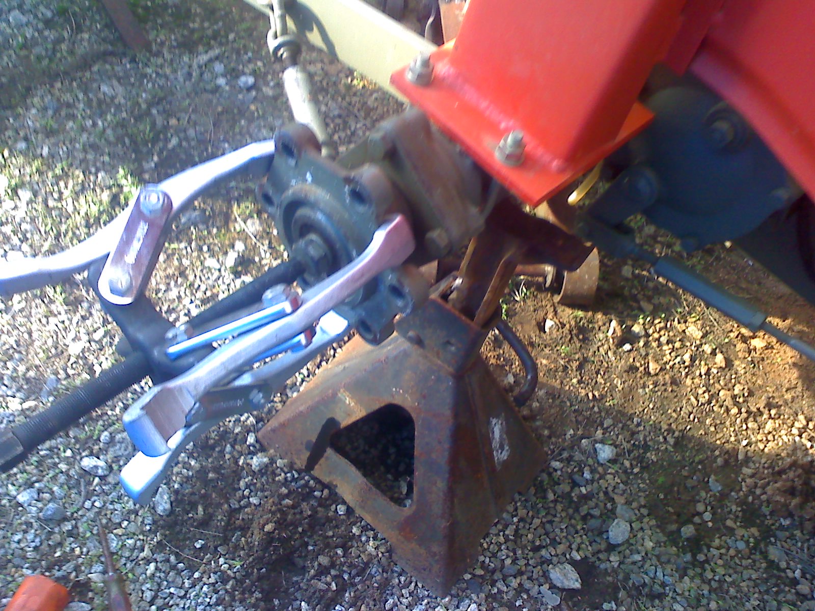

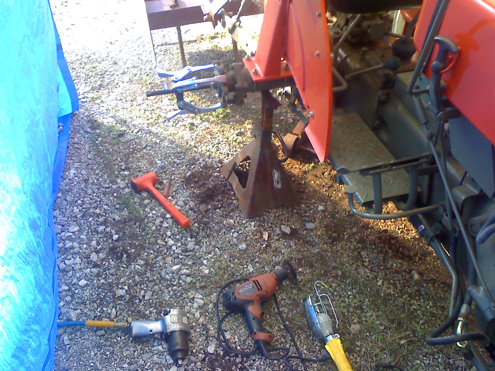

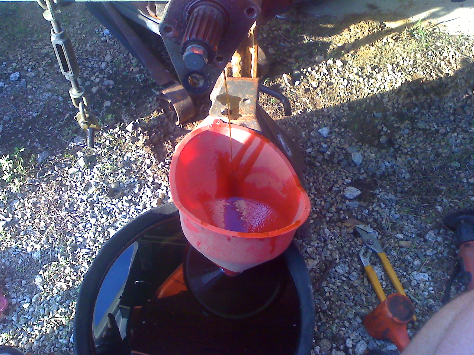

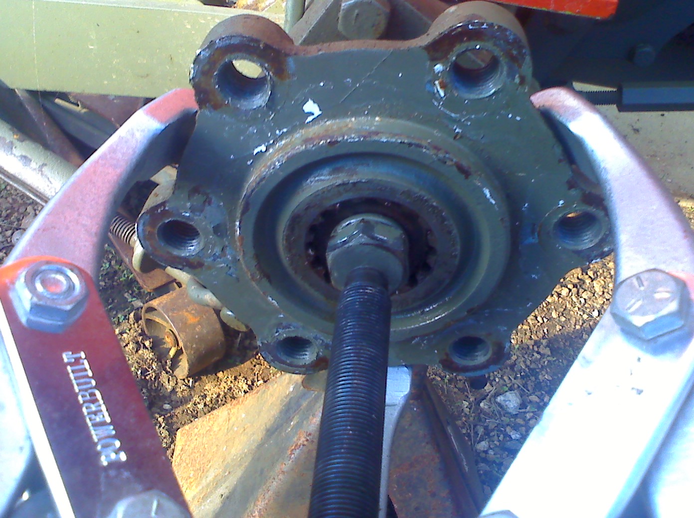

0813121848a.jpg0813121847a.jpg0813121817a.jpg0813121816a.jpg0813121815b.jpg0813121815a.jpg
reuploaded
I figured id put a few pics for those who want to do this or find this thread in the future. There not in order obviously but you should be able to figure out the order of progression. Actually just looked, there in reverse order.
