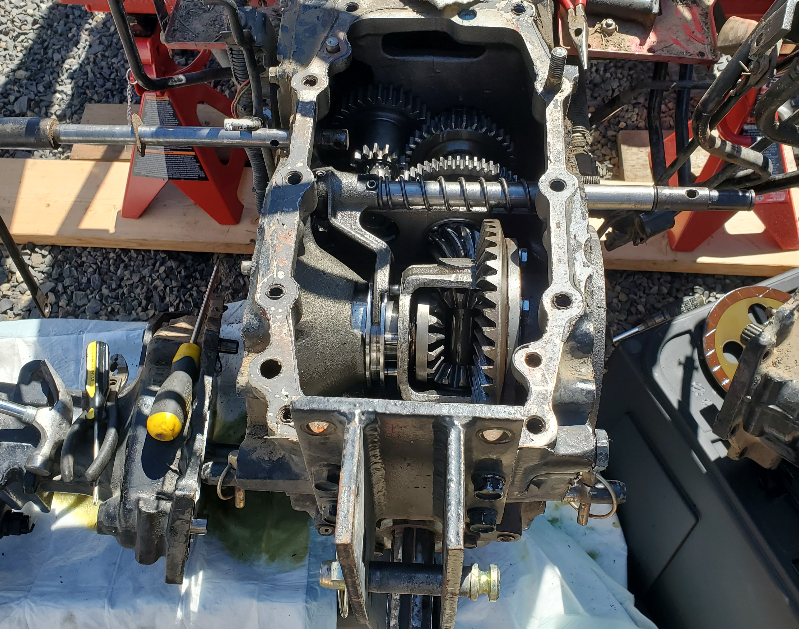

Well I finally opened it up and it looks like the ring gear is the only problem I can see. 20200711_124032.jpg

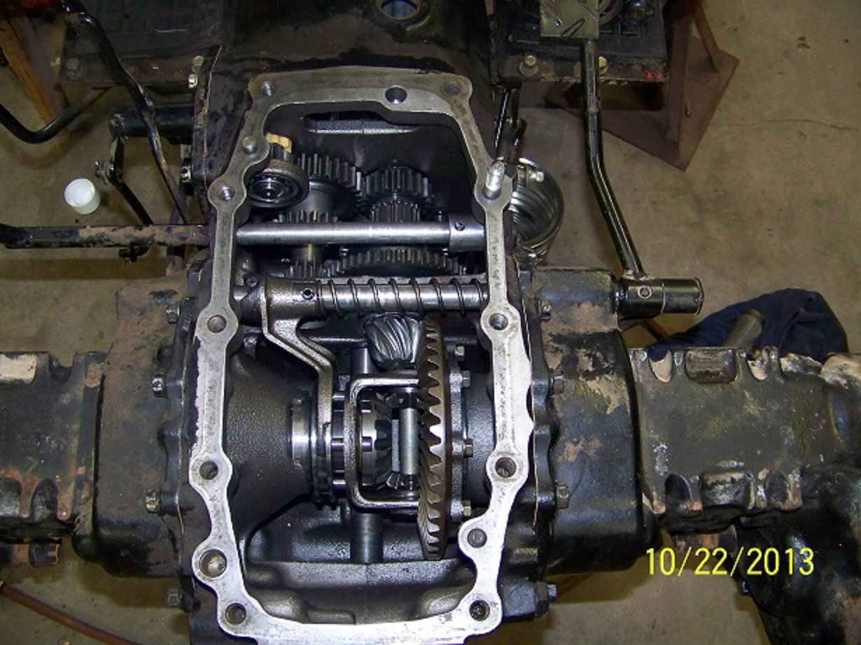

I attached a thread in post #22 where I changed one out on an FX24D back in 2013. Yours looks almost a spitting image. I believe you will have to remove the axle housings. They will come off as one piece. The axle shaft goes into the carrier. Here is one picture showing the likeness.

Fireman984, I seem to recall a crown wheel and pinon are machined as a matched set, and sold that way.
Good Luck

Thanks Winston! Yes that looks like the same set up. I'll pull the ring out this week and take a look at it. Where did you find your gear at? Finding parts seems to be the problem. Also how did you make the gaskets for putting it back together?

I got the gear set from Sheaffer's Town & Country Tractor.
ring and pinion are sold as set. Probably not suppose to do it but I only changed the ring gear. I did blue and check the tooth contact and so far as I know GWsmith is still using his tractor.

What's the trick to getting the ring and pinion out? I've removed both axles but I am not sure what I need to remove to get it out.

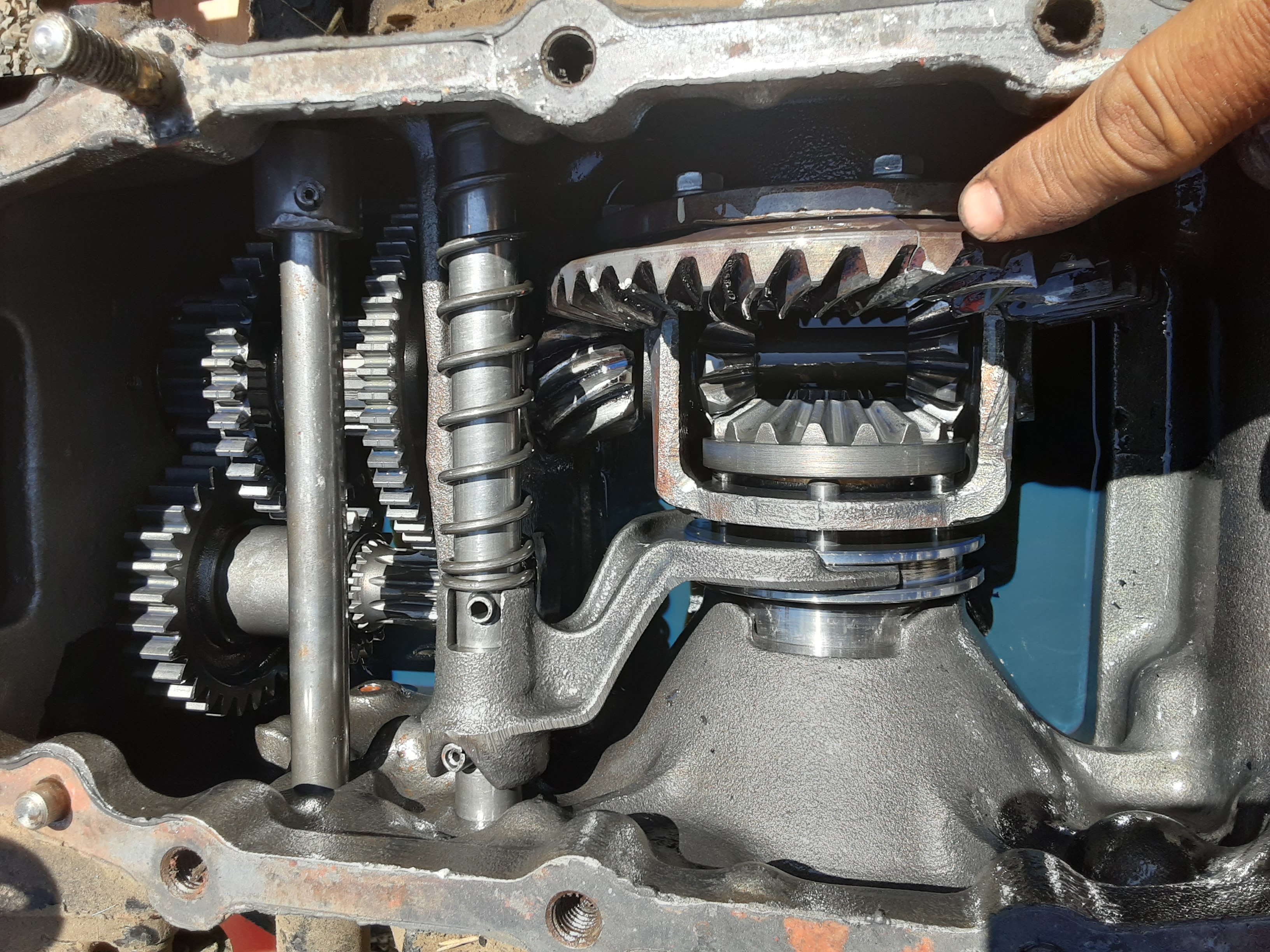

I've got it apart this far.
