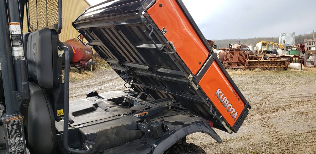

It's rated at 800 lb dump capacity, so I guess we will see how that works out. I looked at a couple newer used Kubota machines and noticed that on both of them the bed was bent/twisted with the front right corner spending life about an inch or 2 above the rubber frame rests. It looks like the Kubota ram will lift greater than the bed frame is capable of supporting to the point that the ram (mounted on that right side) bends the bed.
I'm hoping that the 1,000 bed capacity and 800 lb lift capacity means that the ram can not trust and deform the bed like the Kubota ram can.

The Kubota ram is centered under the bed. A twisted bed is the result of outside forces other than the hydraulic lift system. Odd that you have saw two.
Also odd that the Mule claims 1000lb hauling capacity but only 800lb dumping capacity?

Look at the attached photo, the ram is on the right side of the bed. This bed is one that was bent.20190108_154212.jpeg
