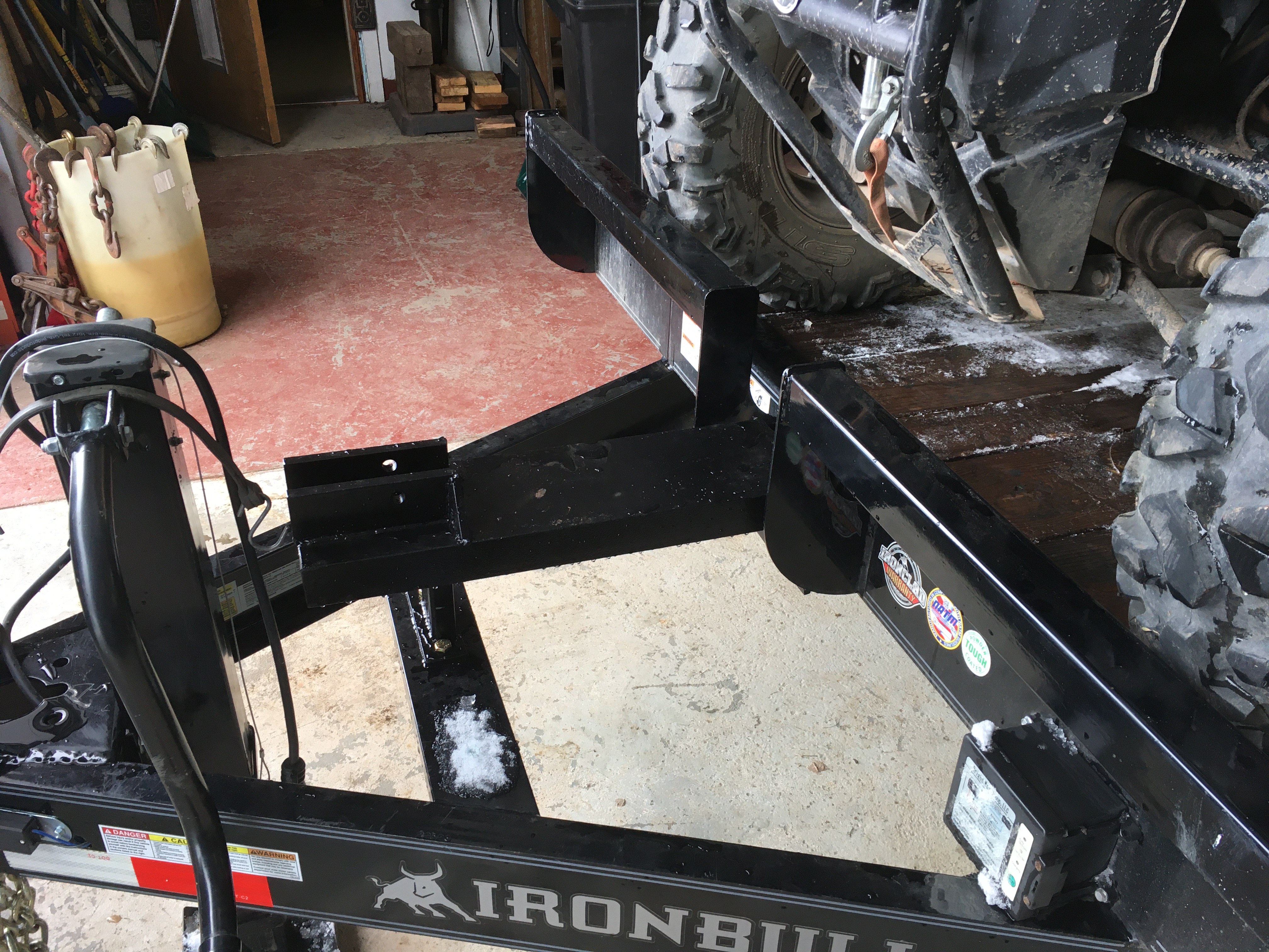

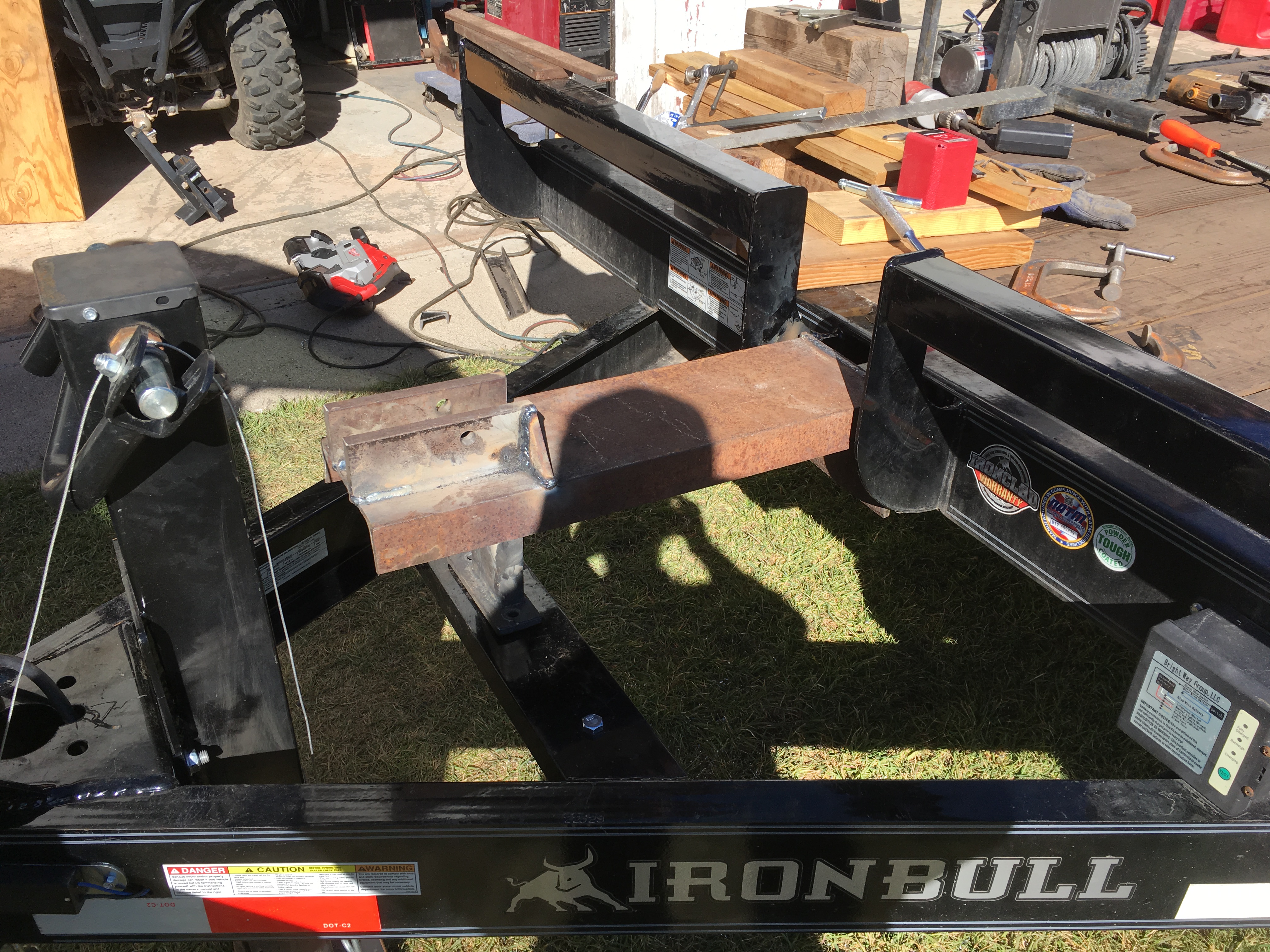

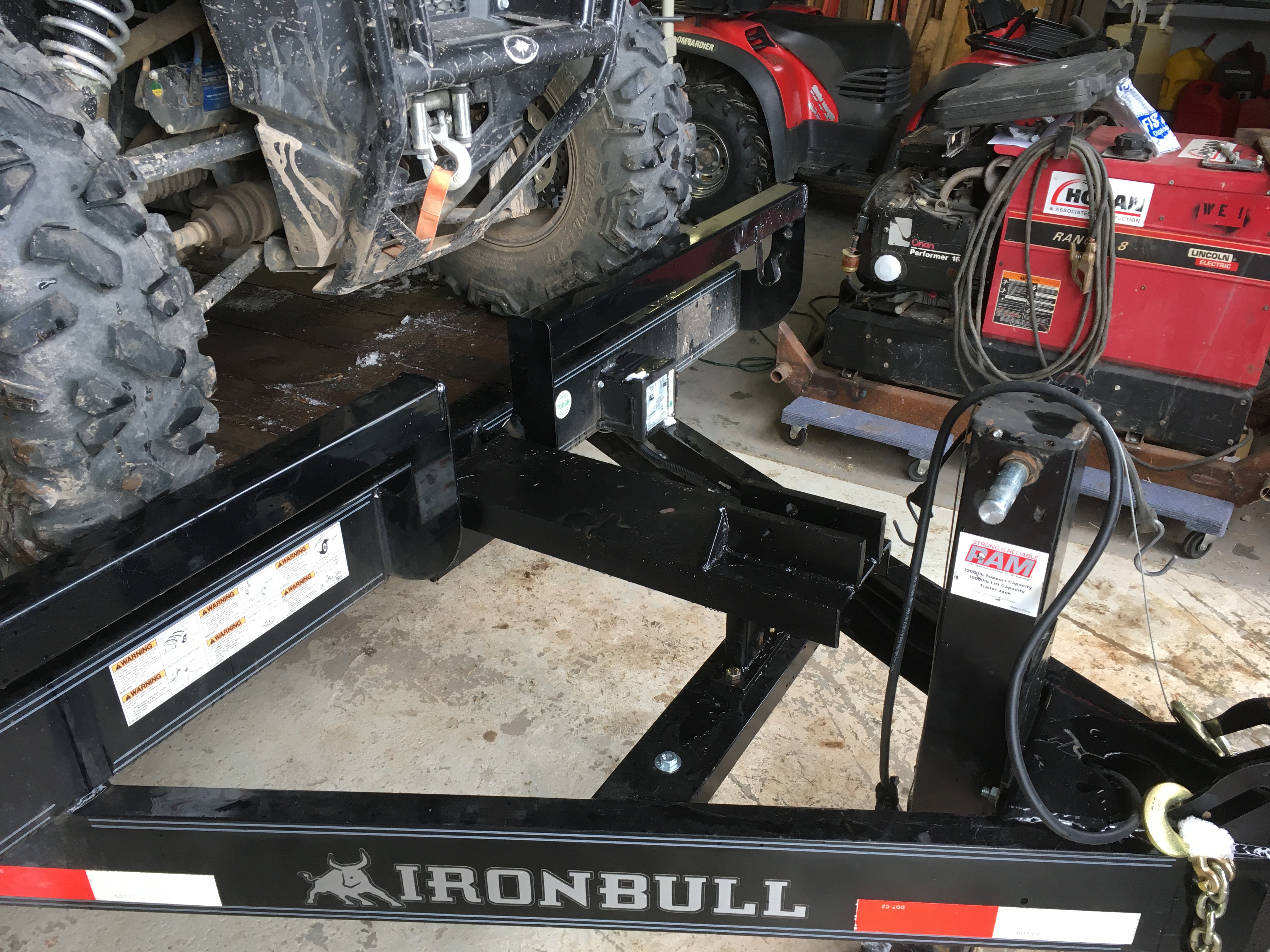

I bought a new trailer last year and just got around to making a winch mount for it.

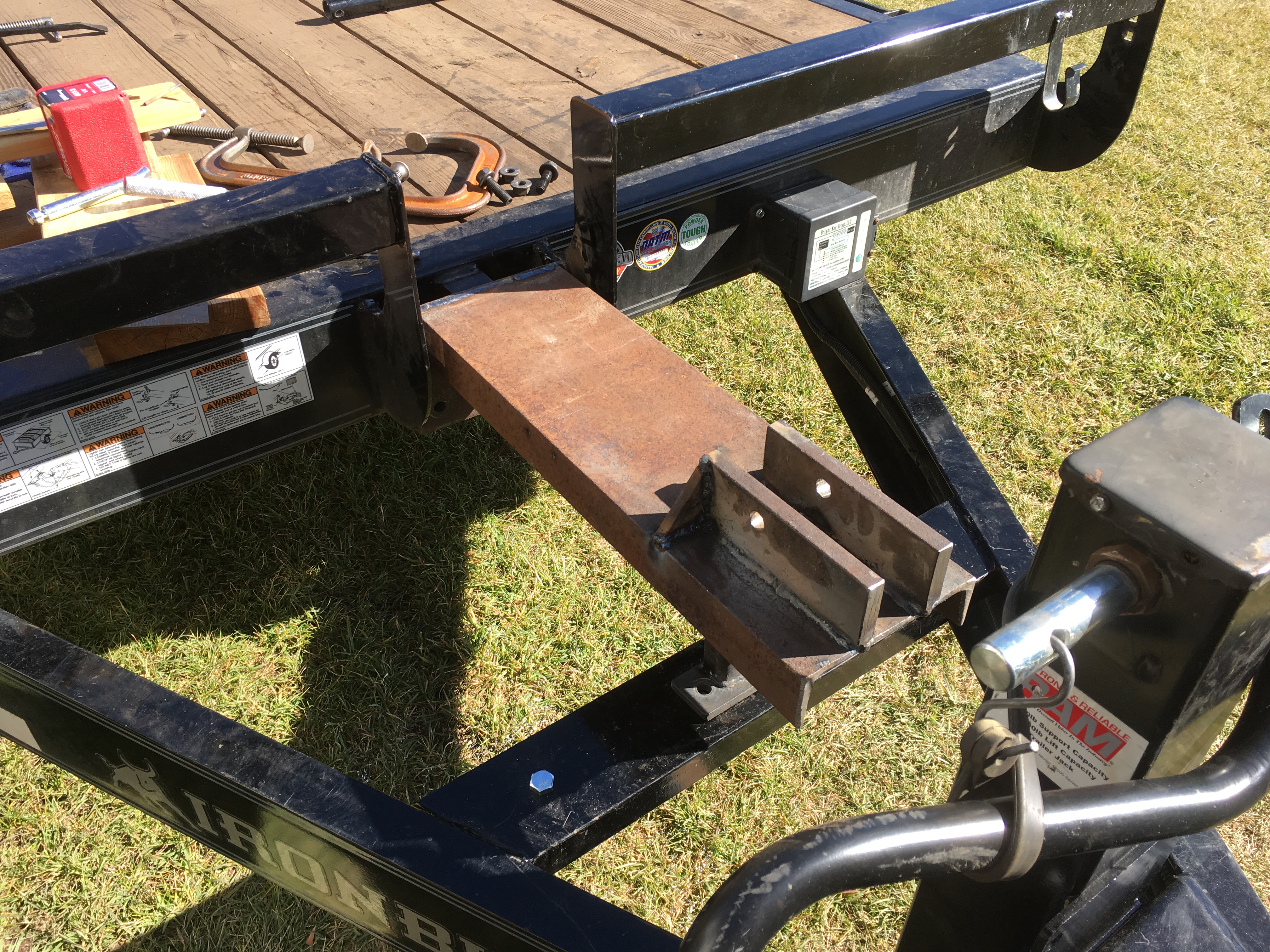

First I had to move the tongue jack from the front of the deck to the front of the tongue. The holes were predrilled in the tongue so it was just a matter of drilling and welding a new plate to the jack so I could turn it around and mount it.
Next I found some heavy 7" channel iron for the main mount. Drilled a 3/8" plate to mount on the front of the deck and welded the channel to the plate. Added a couple 5/8" x 2-1/2" flats with supports for the receiver and put a stiff leg from the cross member up to the channel. Not shown is a stiffener under the cross member I added for strength.

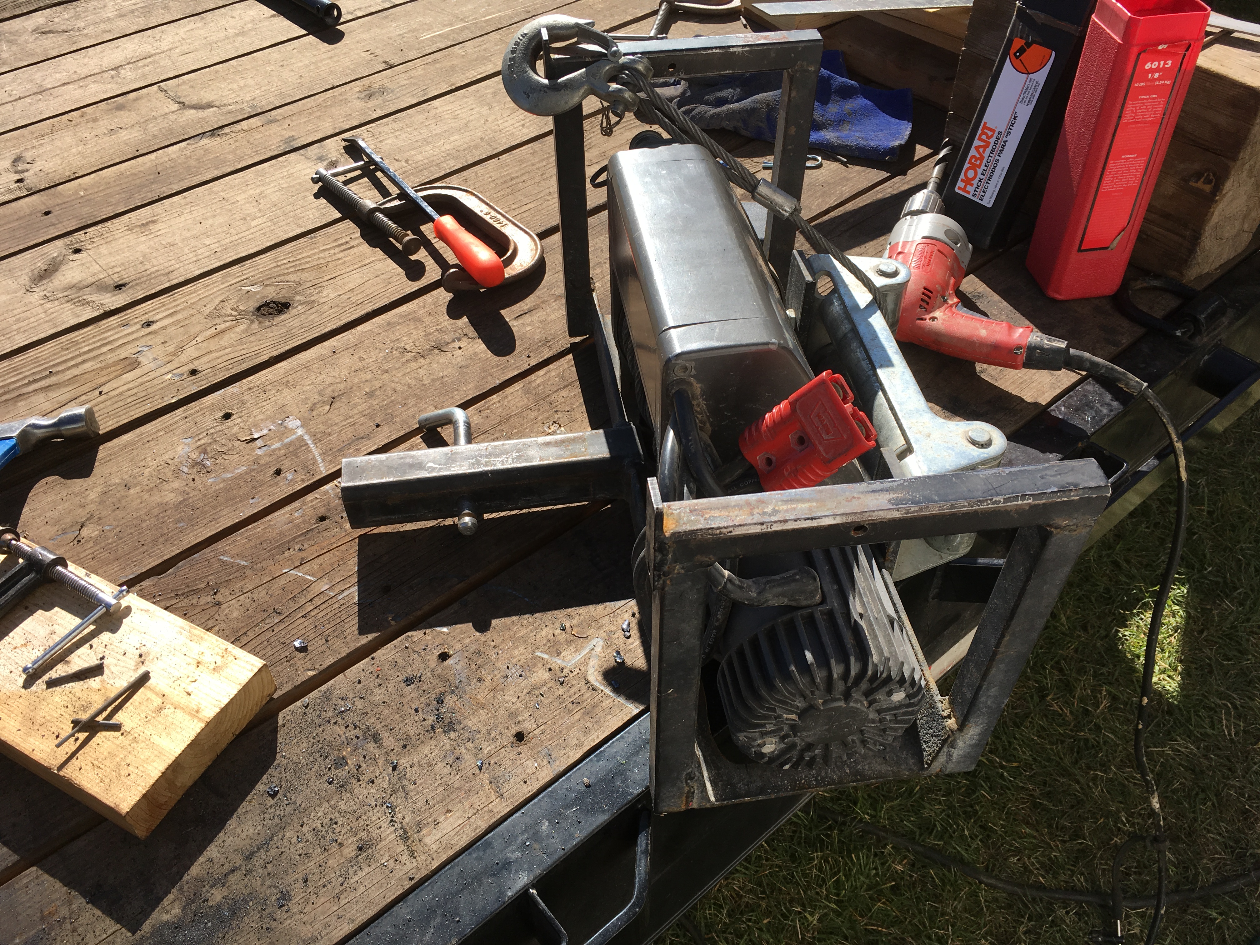

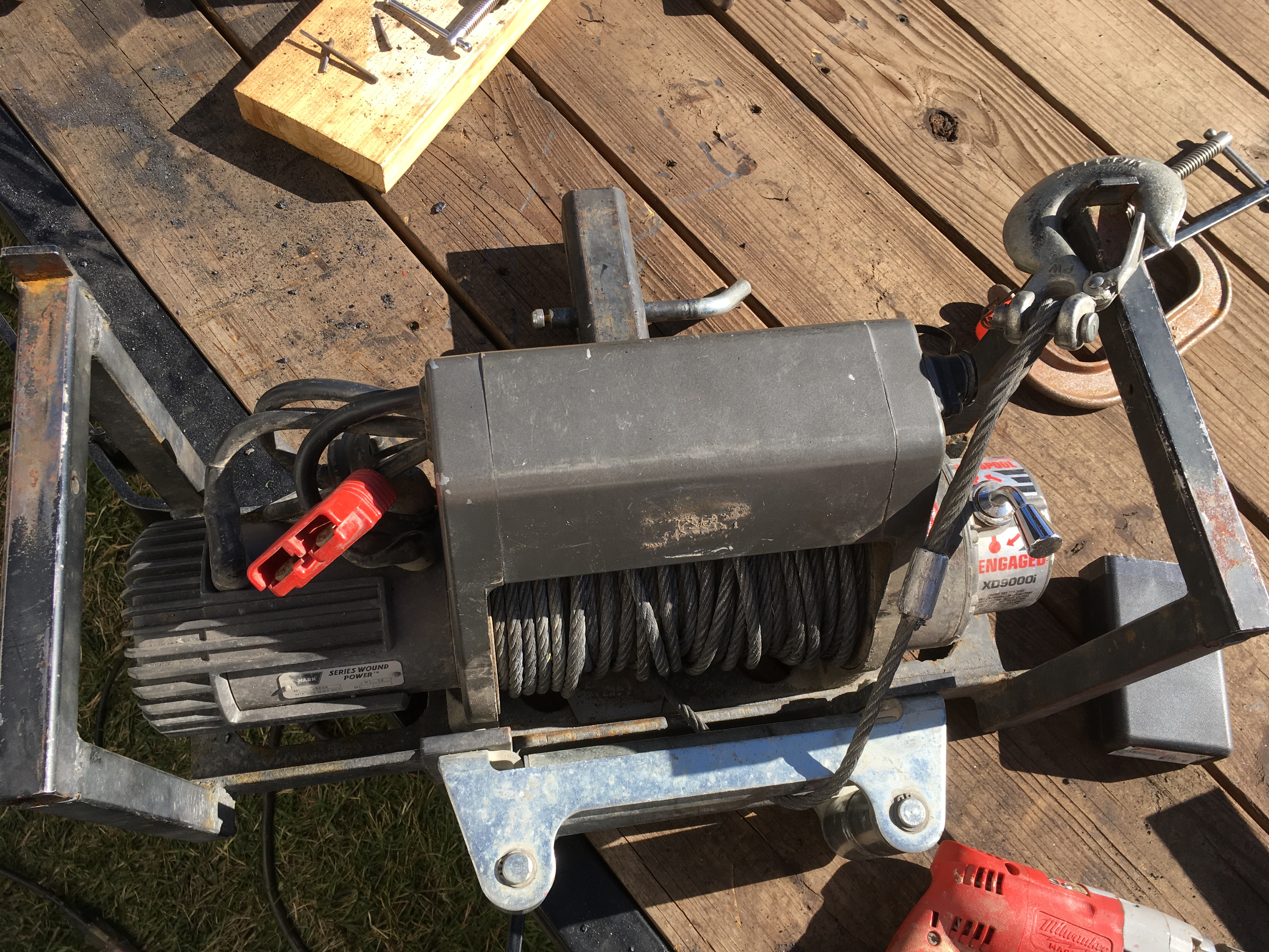

Here is the winch system I built a few years ago for use on a different trailer and in a pickup receiver. It is a 9,000 lb. Warn winch.
Here is the mount with a few layers of paint.

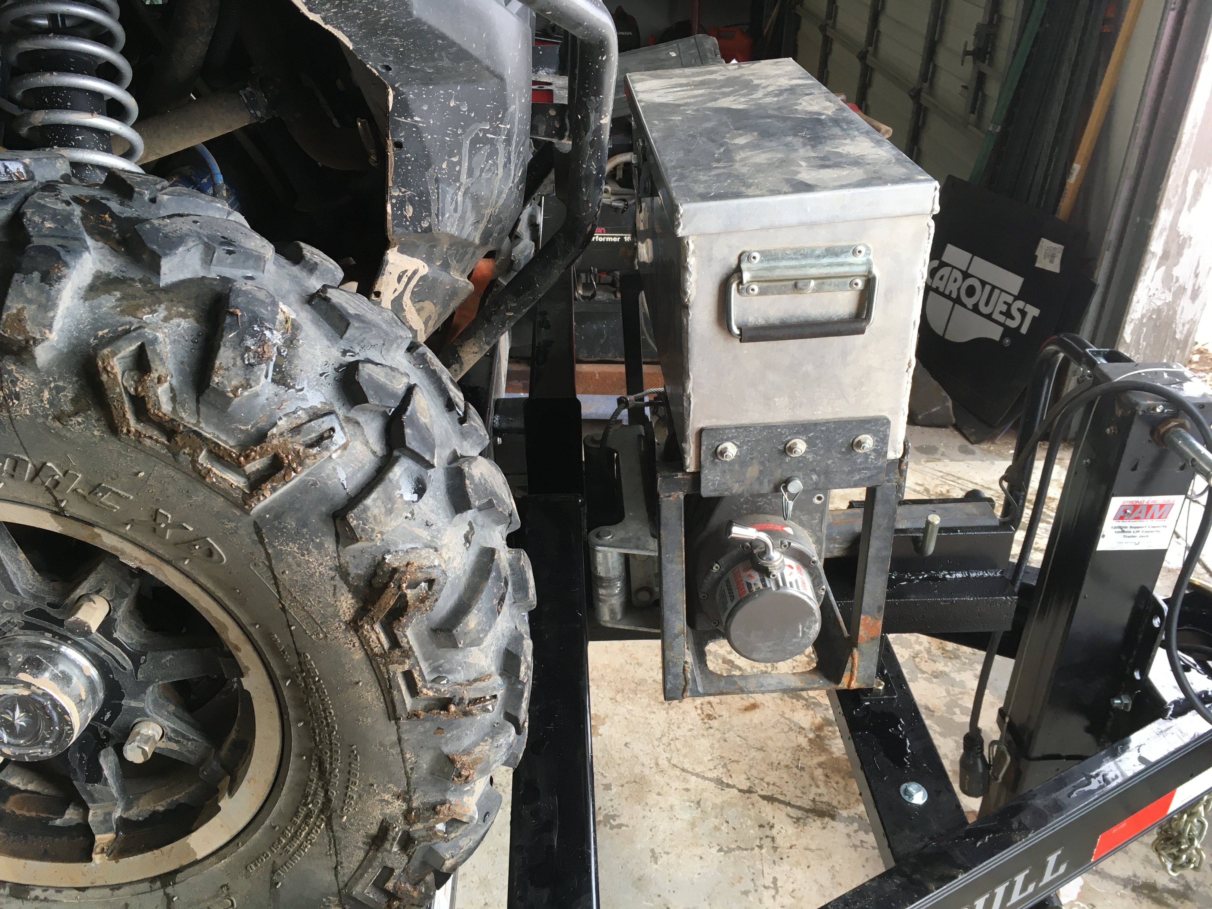

Here is the system with the winch mounted and the battery/misc. box pinned to the winch frame.
Next, when I get time, will be to mount a plug on the trailer so I have a charging point for the winch plus what ever else I might need in the future.

You didn't describe how you are powering the winch??
/ Receiver style trailer winch mount #4
Oh, I must have missed that. Both pics I see with the box, it is closed. I couldn't see any wires going in/out of the box to indicate battery cables?
/ Receiver style trailer winch mount #5
Not sure, perhaps they are visible from the left side (where the cables enter the winch)?
Aaron Z
A battery is stored in the box and is disconnected from the winch unless the winch is in use. In the pictures of the winch you can see the red plug, the battery has cables attached to it with a matching plug. The winch by itself is pretty heavy so I set it up to move the winch separate from the box which has the battery and misc. items in it.

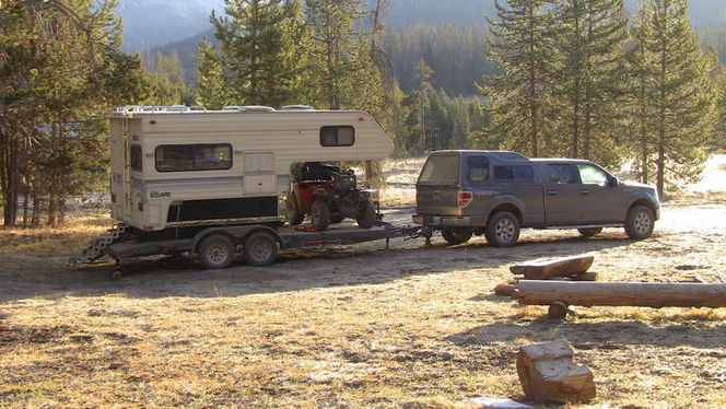

I originally set this system up so the trailer or pickup I was putting it on didn't have to have any special wiring. It was easy to move it from vehicle to vehicle. Quite a few years ago I had a different trailer this was on. When I wanted to go hunting or just camping I would use the winch to drag my cabover camper up on the trailer, then drive my ATV crossways under the cabover part of the camper. When done with it I could use the winch to drag the camper back off the trailer so it was available for other uses.
