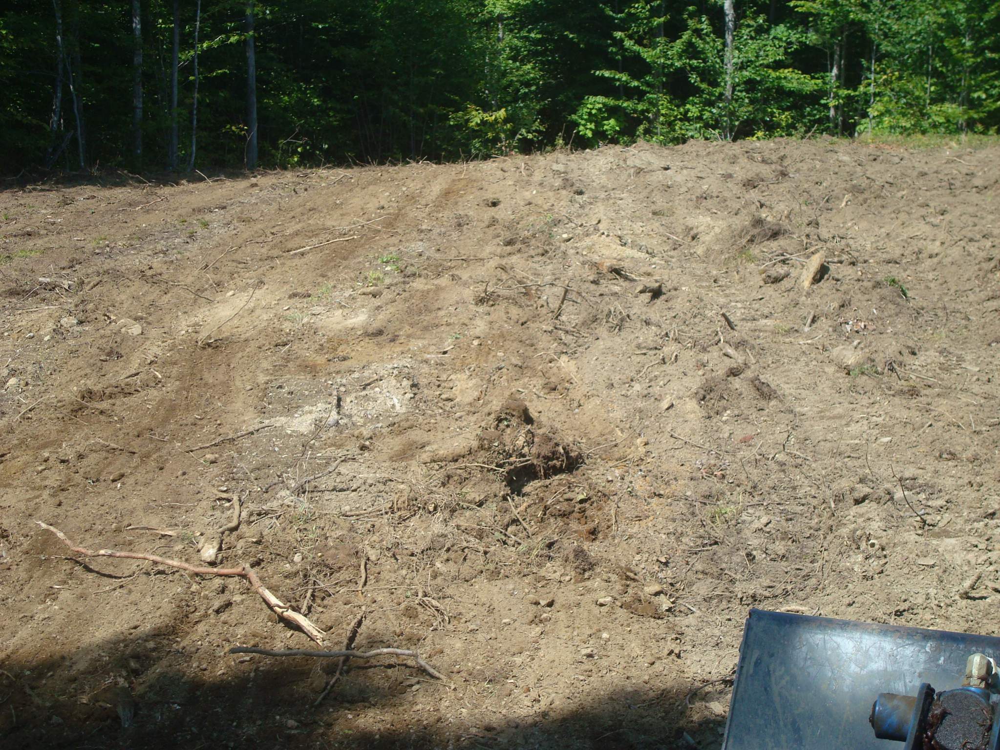

Some before and after dragging pics:
This area has nicer dirt, and deep enough that the dozer could leave it fluffed up. It levels pretty easily. To the left side is after one pass.

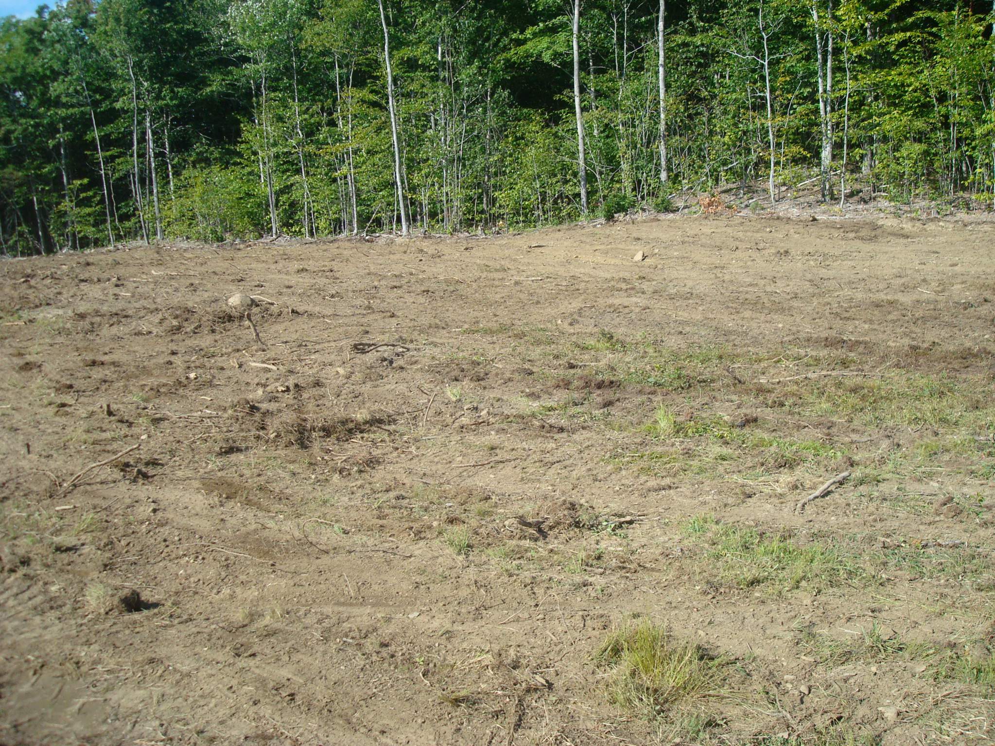

This not as nice dirt after one pass. The hump sticking up across the center of the pic is solid ledge with a little dirt sprinkled on it. :laughing:

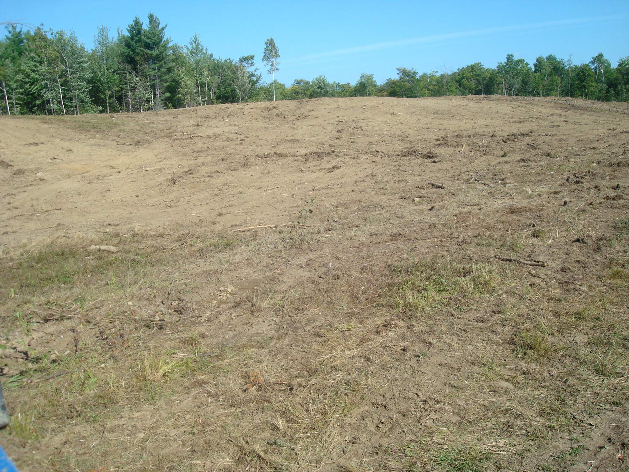

This is reasonable dirt after one pass. You can see how the I-beam tends to bring stuff to the surface and build up clumps until the beam rolls over it. Pre-gathered. :)
The plan is to get over everywhere with at least one pass, then pick up the rocks, bigger chunks of wood, and rat's nests of small roots before making another pass with the I-beam. The dirt is dry and loose now, so it's a good opportunity to get it smoothed at much as possible.

That is a serious beam Dave. It is doing a good job. {the links 2 posts up wouldn't work for me}
