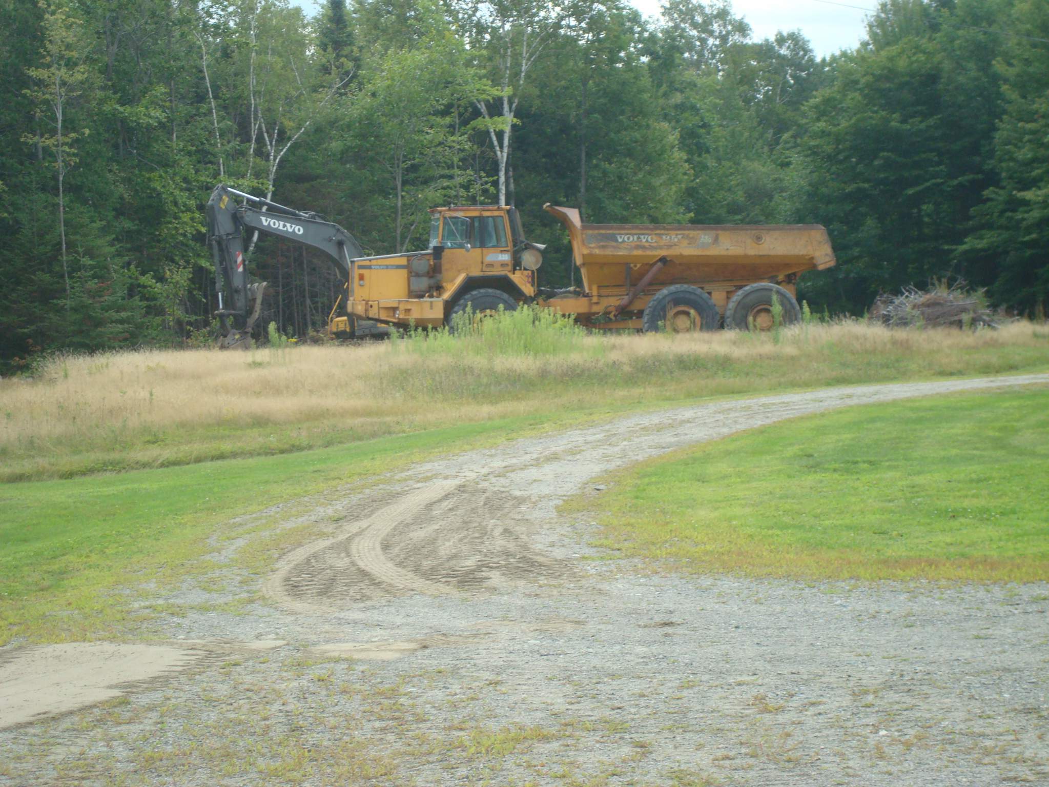

This rock truck will be used to haul the stumps to the stump dump. The ground across the field is pretty rough for a road truck and it won't get much better until the stumps and rocks are out of the way to allow some grading.

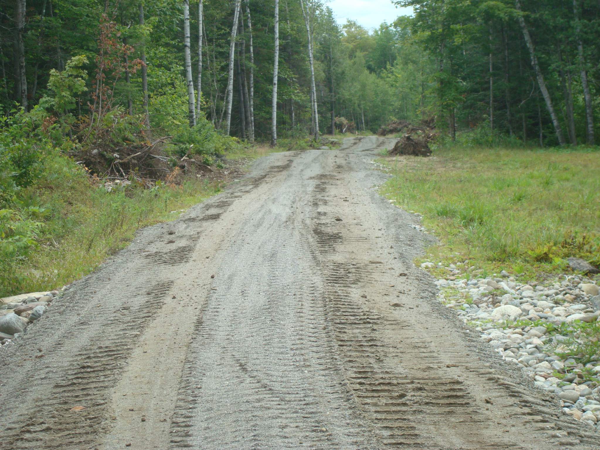

I finally got some topping on the lane to the field. It was 6" smooth/round rock like at the right in the pic. Driving on it will work the fines down into the rocks and lock them in place. It was neater than that until they skidded logs on it, which was a bad idea for loose rock. RDrancher would be appalled, I know :laughing:, but now we can use it without twisting an ankle or shaking the tractor to pieces.

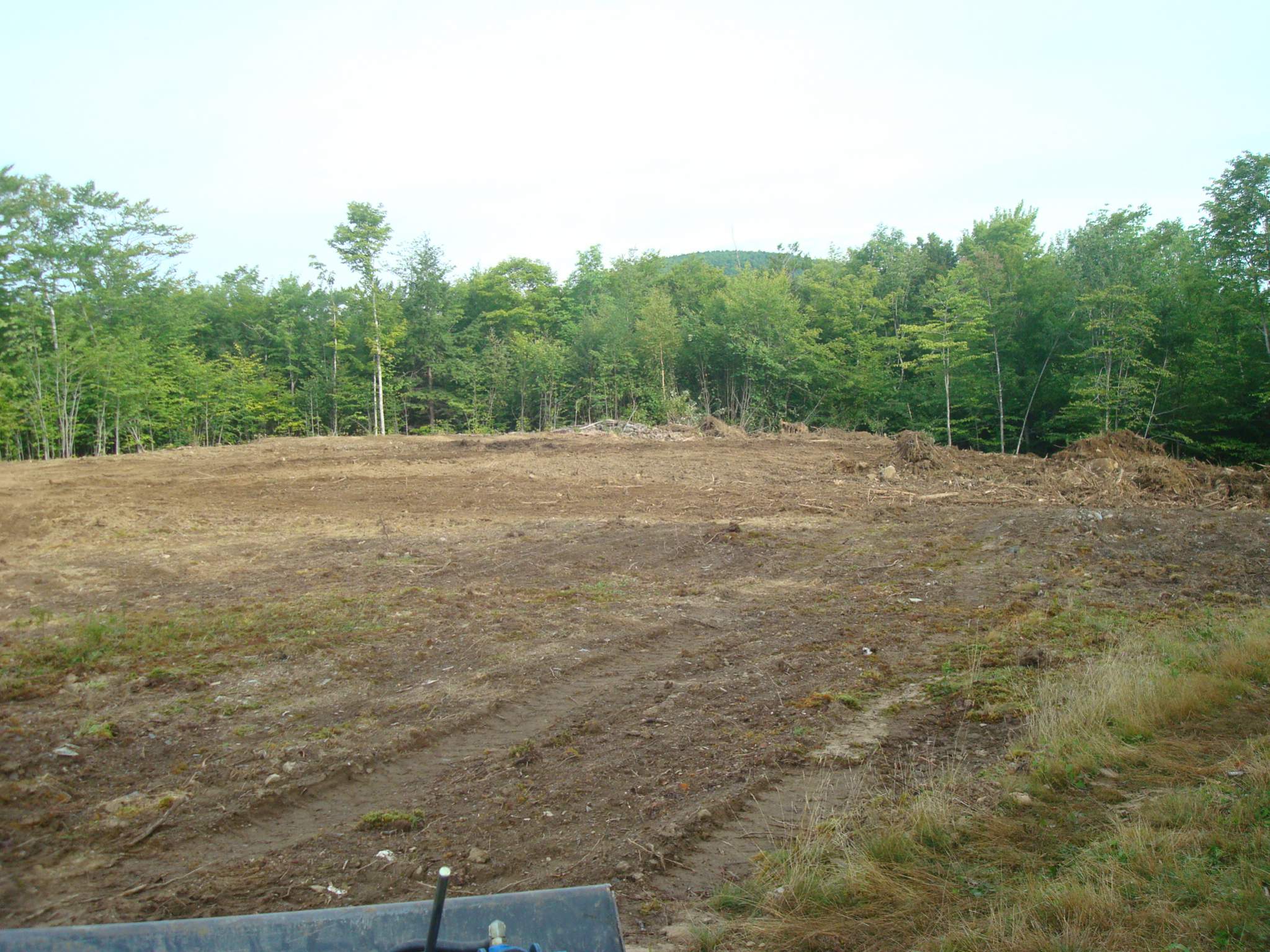

The stump and rock wall removal and trucking is done. Plenty of picking up yet to do this fall.
The stump dump got pretty well filled. Enough dirt was carried on on the roots and squished to the surface by the weight of the rock truck and bulldozer that the top of the dump will be able to be bush hogged for the most part. From past cases of burying brush, I think it will be years before much changes there. It will be interesting to watch though.
This is about the same view from the side of the stump dump as post #39. The level top area is much larger now than at the start.

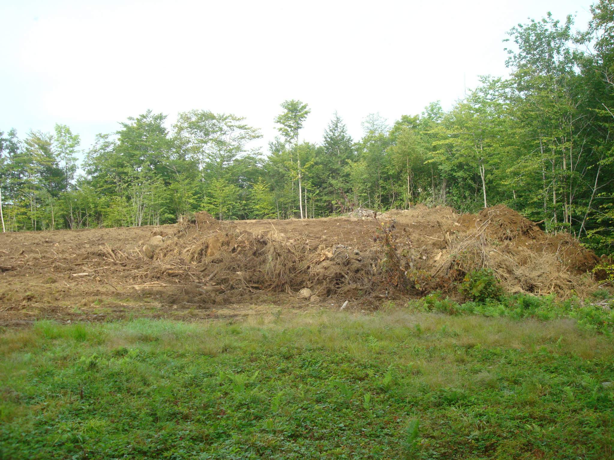

View from the lower end, also as in post #39. We didn't pretty this up because I have trees and stumps to dispose of somewhere every now and then. They can be added to the end as needed.

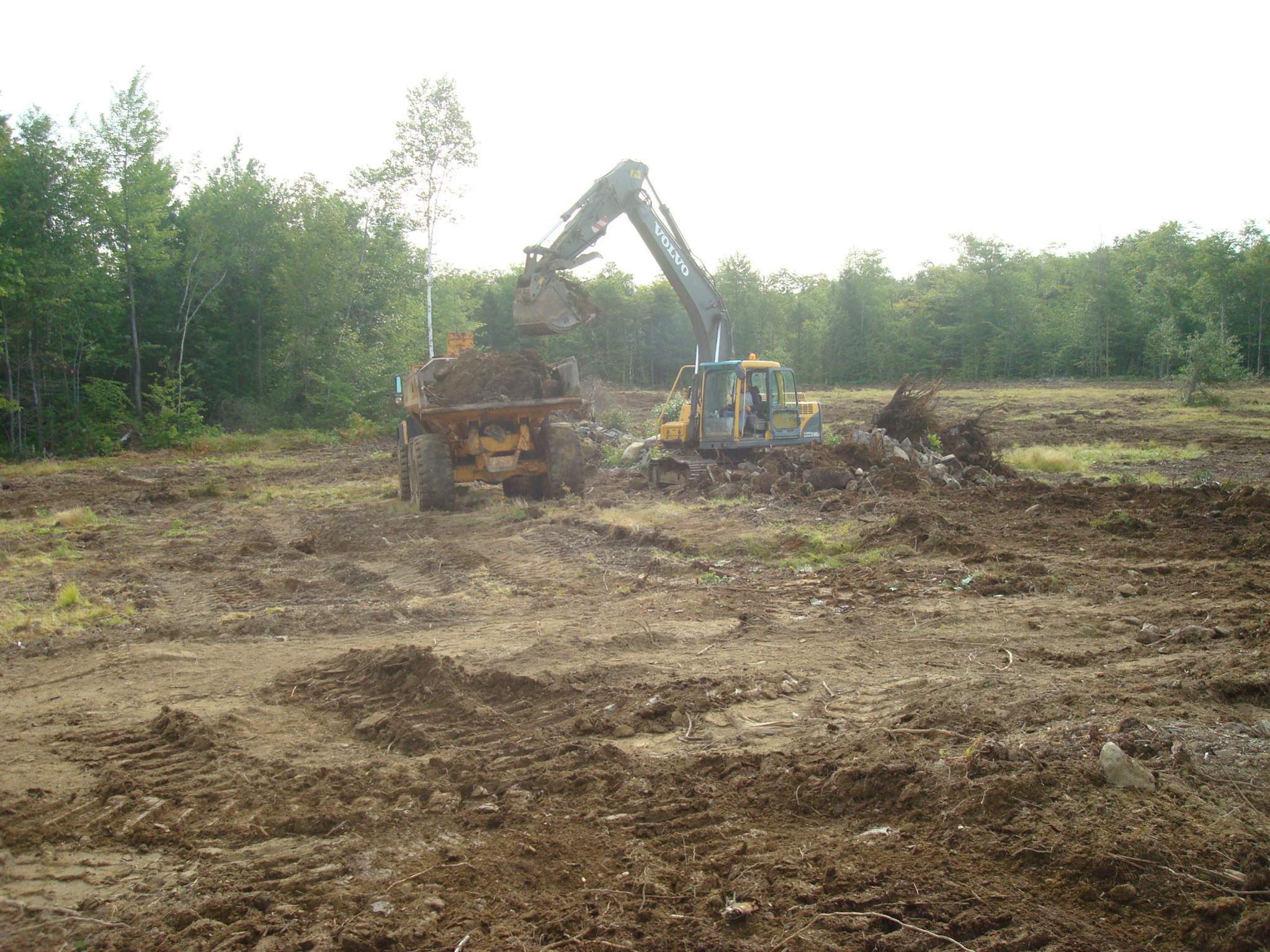

Some pics of removing the rock wall. It ran across the center of the field. Most of it was just a mess except for about 50-60 feet that had never been skidded over. I decided to just get rid of all of it. They are a pain to keep the trees from growing next to them where the bush hog can't cut, besides living with a barrier across the middle of the opening.
Having the rock truck made a huge difference. The contractor said without it, we wouldn't have been able to do it the way we did. I could easily see that. It allowed working from all over the field whereas a road truck would get torn up and stuck doing that. He rented it; it's for sale in Madison, ME if anyone needs one. :D

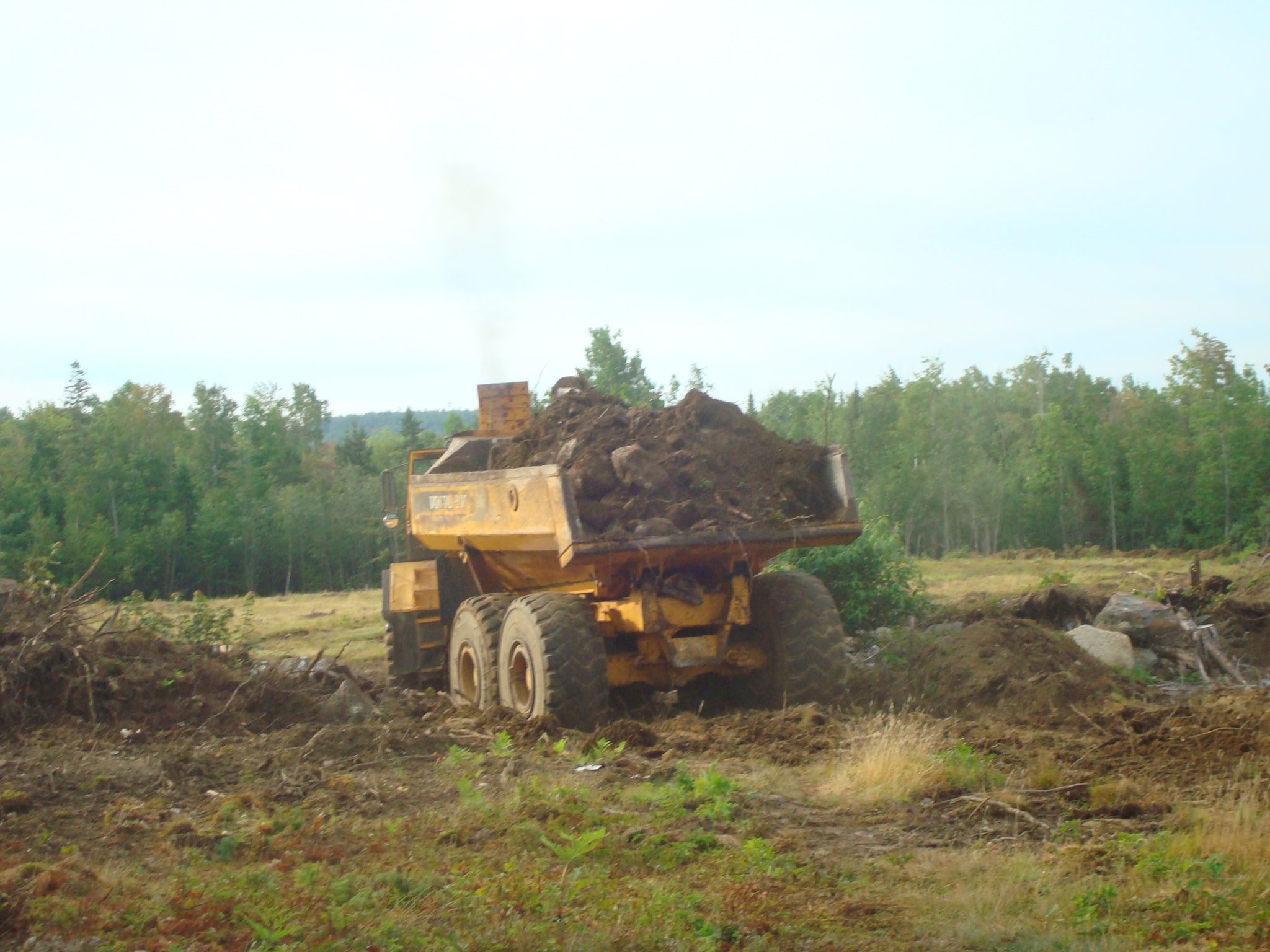

Loaded rock truck. Interesting factoid: the wagon portion of these trucks are made to tip over. At the articulation joint behind the tractor portion, there is a swivel. We didn't test it thank goodness but it had been on its side sometime or other. The load rides high. There is a safety decal inside saying if the wagon tips, hang on to the steering wheel--do not jump out.
Loading rocks from the wall.

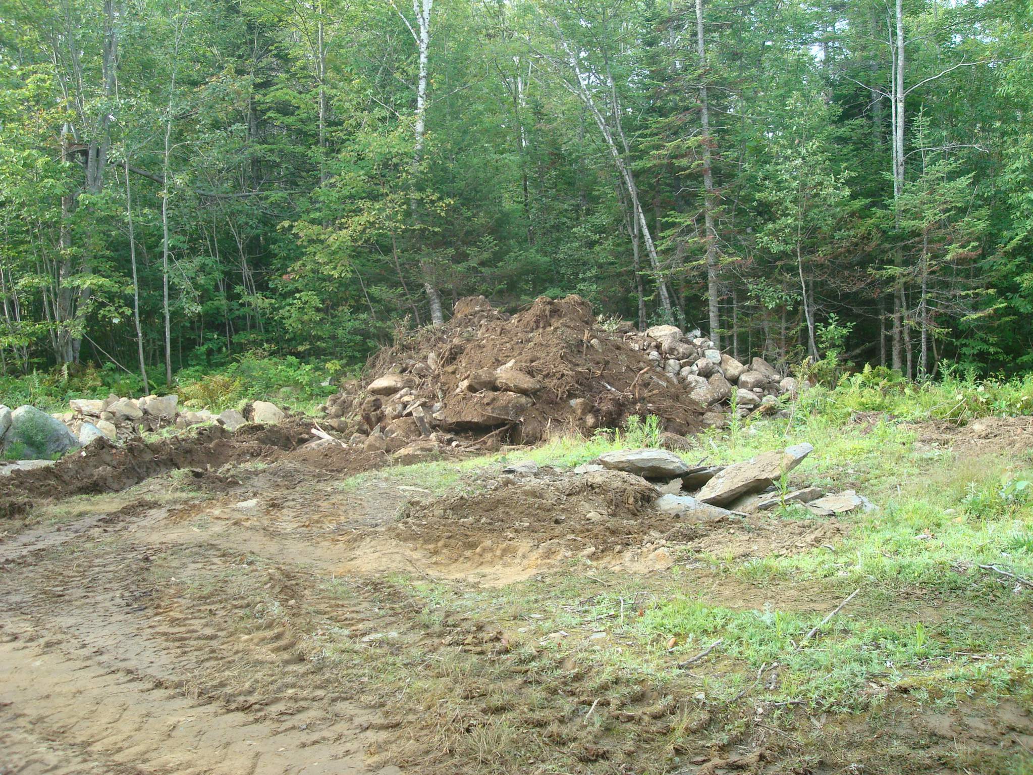

Some of the rocks were trucked here to provide the base for a truck turn-around at the entrance to the field. It was a mostly useless small, low corner area behind a ledge outcropping, so I made something useful out of it. :)
