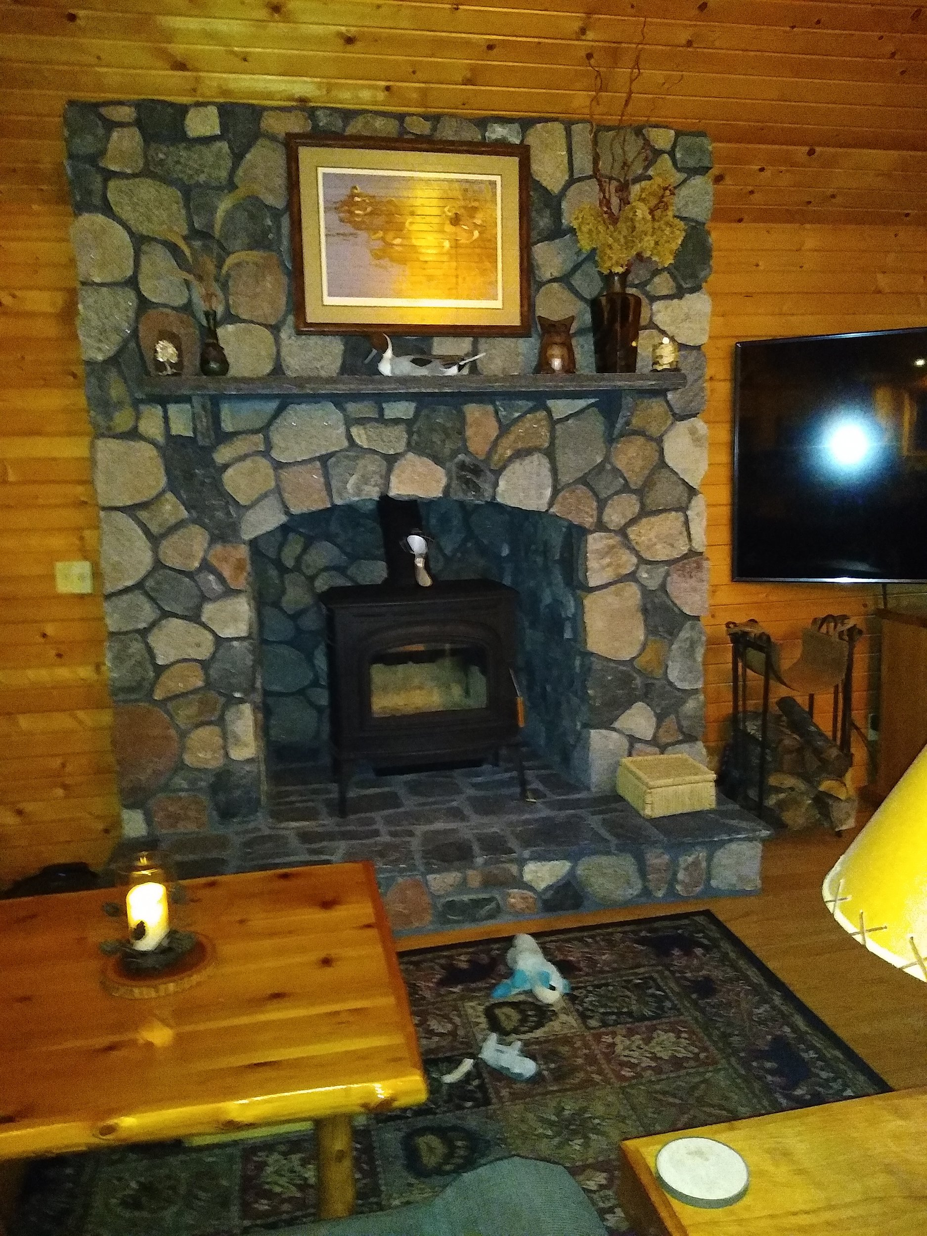

Blaze King catalytic here installed as a hearth stove. Very happy with heat output and burns all night on low damper setting.

Here's a picture of install
