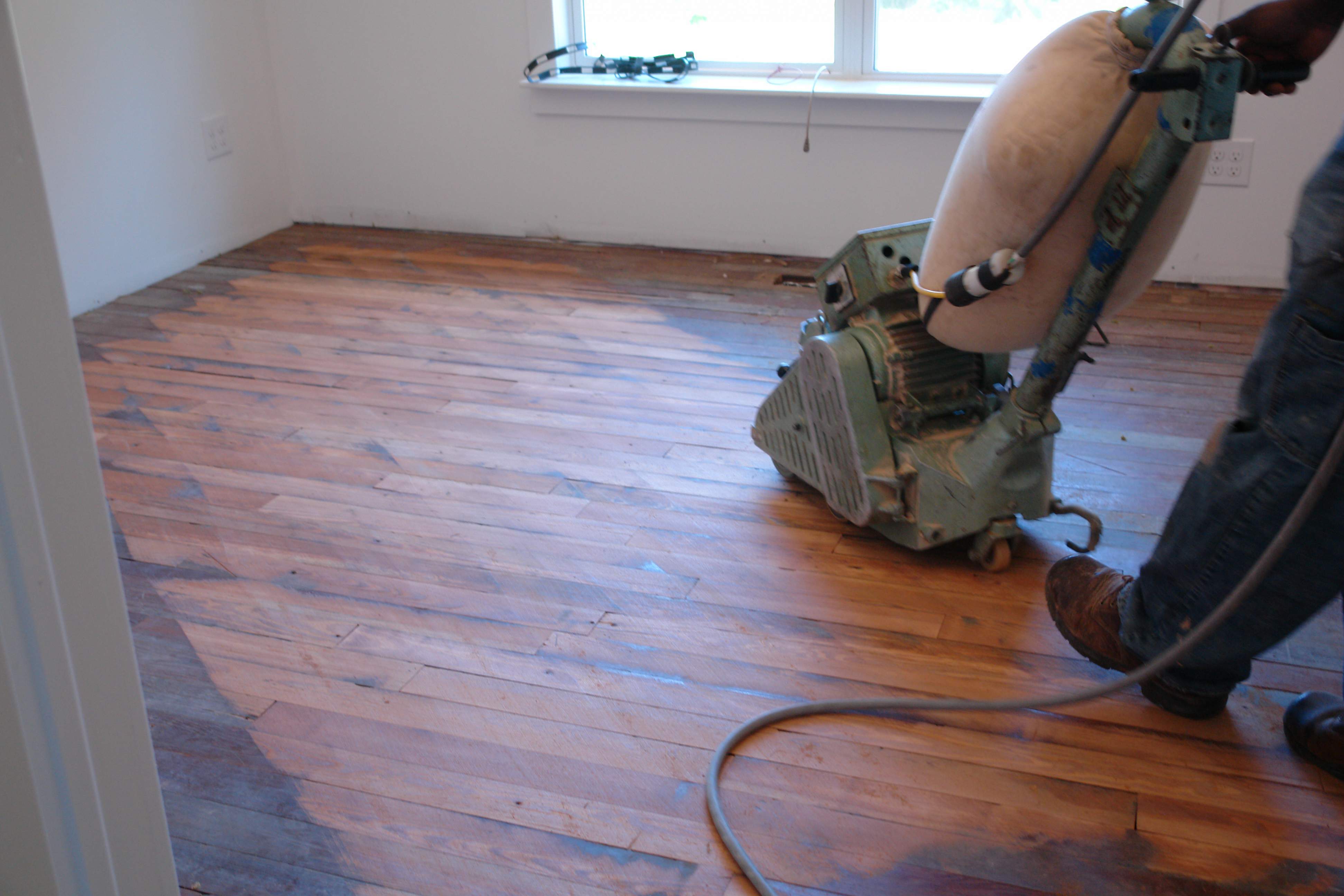

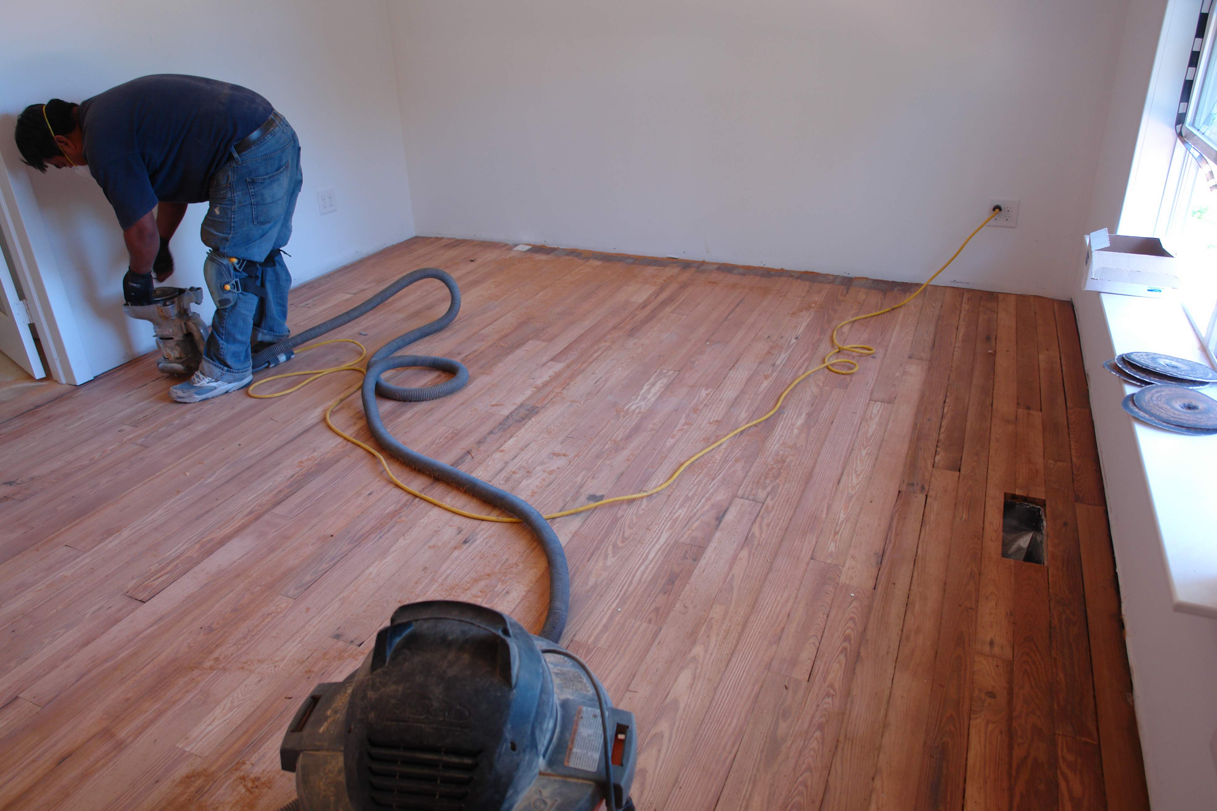

DSC03507.jpgDSC03492.jpgMy wife and I have had the hard wood floors refinished in two of the homes we currently own. I hired it out to flooring professionals both times. The last house we had done just this spring, was a rebuild house. 60 year old white oak floors that had layers and layers of wax on them, pet stains, water damage and we also tore some walls down and put new walls up in different locations. The flooring people came out, popped out the water damaged flooring and put down new solid oak flooring. Same thing with the new construction area. They then came in with a large drum sander and a vacuum system. The vacuum system is not only key for keeping the dust down, it sucks up all the dust accumulated on the floor from the previous swipe and helps keep the sand paper clean. After 3 passes at different angles with the drum sander to make sure no strips were sticking up higher than the other strips, they had a screen sander that they used to smooth out the wood grain. Being that there had been pet stains all over the floor, which had absorbed into the wood for many years, we decided to stain the raw wood before sealing it. The floors came out wonderful. A 1450 sq.ft house we had completely redone for about $1500.00 dollars.

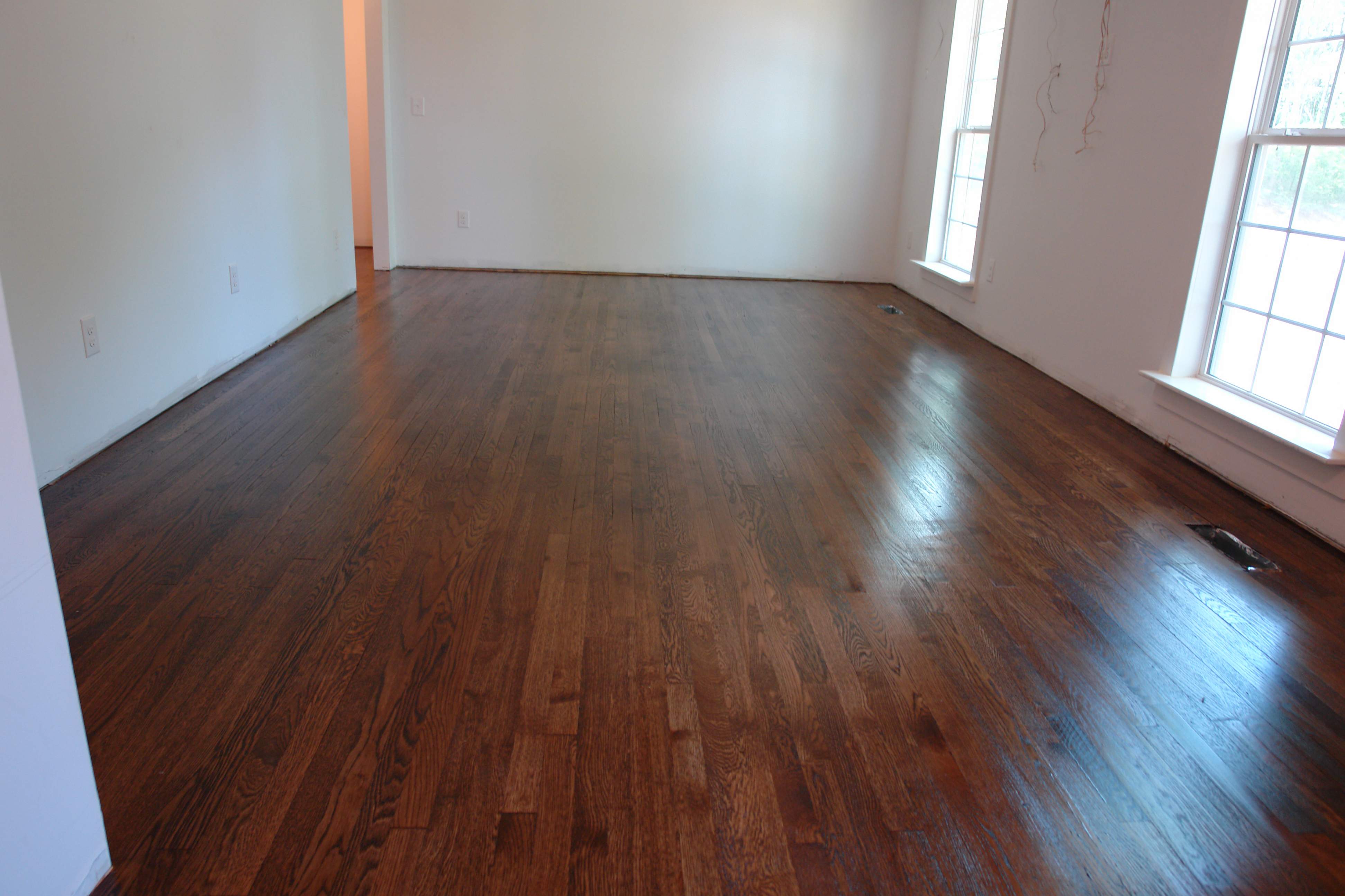

Those floors came out looking really good! You should be proud.
When we rebuilt our latest house last year, during demolition, I found some old pine boards in the converted garage that was used as the subfloor and the floor. Due to the shoddy building practices of someone many years ago, we tore the old floor out and I almost threw it all away. One of my contractor friends stopped me and told me that might be good wood. When we had the flooring contractors come out, I asked them about re-using the old pine wood. The flooring contractor said by all means, use the wood. He estimated that the wood was somewhere around 150 to 160 years old and it was heart pine, which you just can't find anymore. If you can find it, it is expensive as all get out. This wood had been recycled several times. So, they put the old recycled heart pine down and came in and sanded it. Dang, did it ever turn out nice! No stain, just 3 coats of poly.DSC03484.jpgDSC03488.jpgDSC03506.jpg
