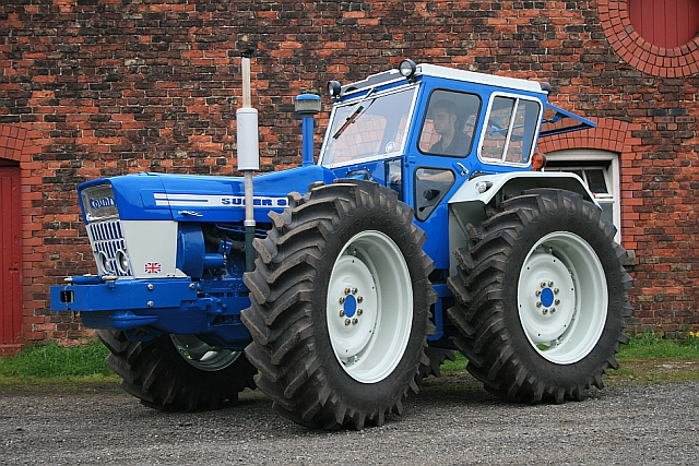

To answer another question there were some early 4WDs that were not articulated - IH 4166, Case 70 series and a few others - but they all had drivetrain issues. Steiger and Versatile were articulated and the others soon copied.
This reminded of a County tractor that I saw on a show from the UK that used to air on RFD-TV.

I don't recall windup being a problem on the counties. I think the driveshaft to each front wheel had a lot to do with it.

I'll bet that thing would hop around the corner!
sweet looking tractor though...looks like a Ford built in England
most of us have never heard of County tractors
