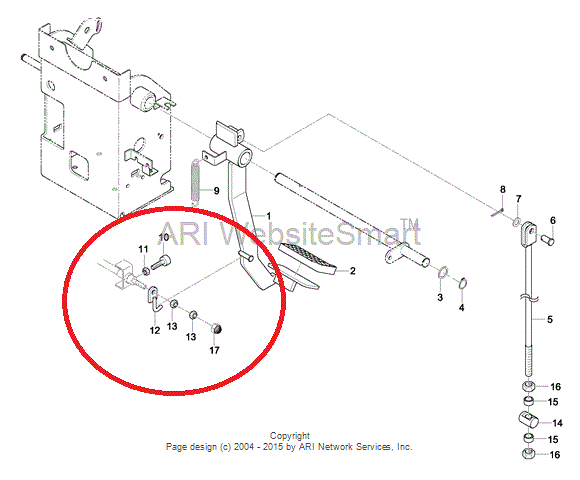

On the CK20 there is a hold down for the clutch so you can start it without having to hold the clutch down with your foot. See picture below.
So based on this the clutch issue is not really an issue.

my kubota has the same-ish hook, but I don't think it depresses it far enough for the clutch switch.
Obviously, it'd be easy enough to over ride...but that isn't necessarily the best idea either.

I have used this hold down hook to start my tractor without being seated on it, but since it is an HST, I am not concerned with it being in gear.
