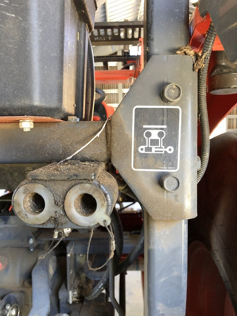

I have a Kubota MX5200 with remote hydraulics on the rear. The controls allow me to side shift my flail mower. I want to hook up a Backhoe and I need continues flow of hydraulics to the Backhoe. I was wondering if I can use the remote hydraulics by taking the controls and lock them in a "continuous on" position or will that damage my control?
Thoughts?

It will work just fine. A bungee cord or something holding similar the lever in place and you're good to go.
Just make sure you're feeding the backhoe from the pressure side of the backhoe control valve, since it's easy to reverse with the remotes.

We run ours with a pump on the pto and BH has its own controls. I wouldn't be putting those BH forces on my tractor hydraulic system.
Say you're digging a stump and have front of tractor up a little bit, and it comes loose. Where does that jerky release go to? Trying to dislodge a rock or piece of concrete? Back Hoes tend to get in good binds.

A lot of tractor manufacturers use rear remotes for the BH plumbing. My LS is set up that way. I imagine that they are engineered to do so, not sure if it would work on an aftermarket BH. The worst thing that would happen is the BH movements are slower and not as powerful..... if you don't have enough flow.

I can only describe what my experience is with a M59 TLB ( tractor loader backhoe ). The backhoe has a dedicated pump and two feeds to the backhoe and one return to the reservoir and then fluid gets pumped again. One circuit feeds L-R swing which consumes high volume. The Boom, dipper, and bucket curl run on separate circuit at much higher pressure since this is where you are doing real work. Both circuits are constantly being fed and if not doing work then fluid bypasses the shuttle valves and returns to the tank. This keeps everything cool including the fluid.
The reason for having two circuits is, if you are using both swing and boom lift then you are robbing either volume or pressure. You can't do both at the same time with one circuit.

A backhoe doesn't usually take a ton of flow. You're not dealing with hydraulic motors, so it's just cylinders. You'll need to check what your remote can put out in terms of pressure. Assuming you have the pressure, the flow is just going to make the hoe run slower if it isn't optimal. When I run my hoe, I keep the engine just over idle. If I go WOT, the hoe will move faster than ideal, even feathering the controls. Occasionally I need the WOT for pressure, but that's not frequent. Odds are you're not a pro operator, and you're unlikely to be running the hoe all day, every day to want peak performance. If you were, we wouldn't be discussing this particular setup.
The only issue I could see is does your tractor have enough cooling built in to the hydraulic system. I'm sure the best place to start that question is your dealer, and as noted above, find "the guy" that knows about reality, not just some sales weasel...
