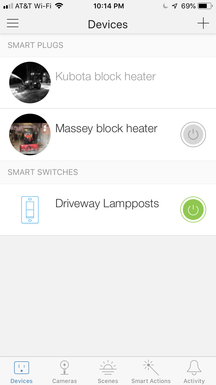

I use TP Link Smart Switches. Can be used with Alexa, but doesn't need to be. It DOES need to be installed within WiFi range (I use WiFi extenders as needed). You can turn it on or off anywhere you have an internet connection for your phone, and you can also set schedules or use a timer. It shows the status of the device(s) on the app.

There are two main reasons I like the TP-Link for most of my applications so far. I can control them from anywhere I have a wifi or cell signal. So I can turn on my block heater while I'm at work and have it warm by the time I get home. They can also be programmed to a schedule; for instance our driveway lamp posts are scheduled to turn on "at sunset (you give it your location so it knows when that is throughout the year)" and off at 11pm.

Pretty sure the TP-Link devices don't need internet to control locally. And I know that you don't need any network connectivity to continue already programmed schedules or timers - those are stored on the device.
