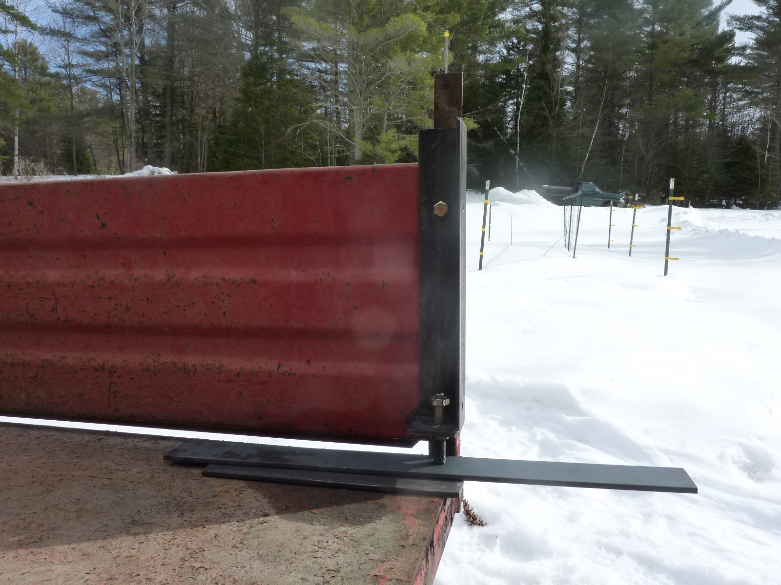

I bought a used Pronovost dump trailer a couple years ago. It is a great little trailer.
It is advertised as having removable sides. I wanted to remove to sides to make a flat bed. "Removable" is a little misleading maybe. The corner posts are 1-1/4" square tubing and the corner pockets they are pressed into are 1-1/2" X 1/8" square tubing so it is a force fit from the start. Then any deformation from use over time only tightens things up.

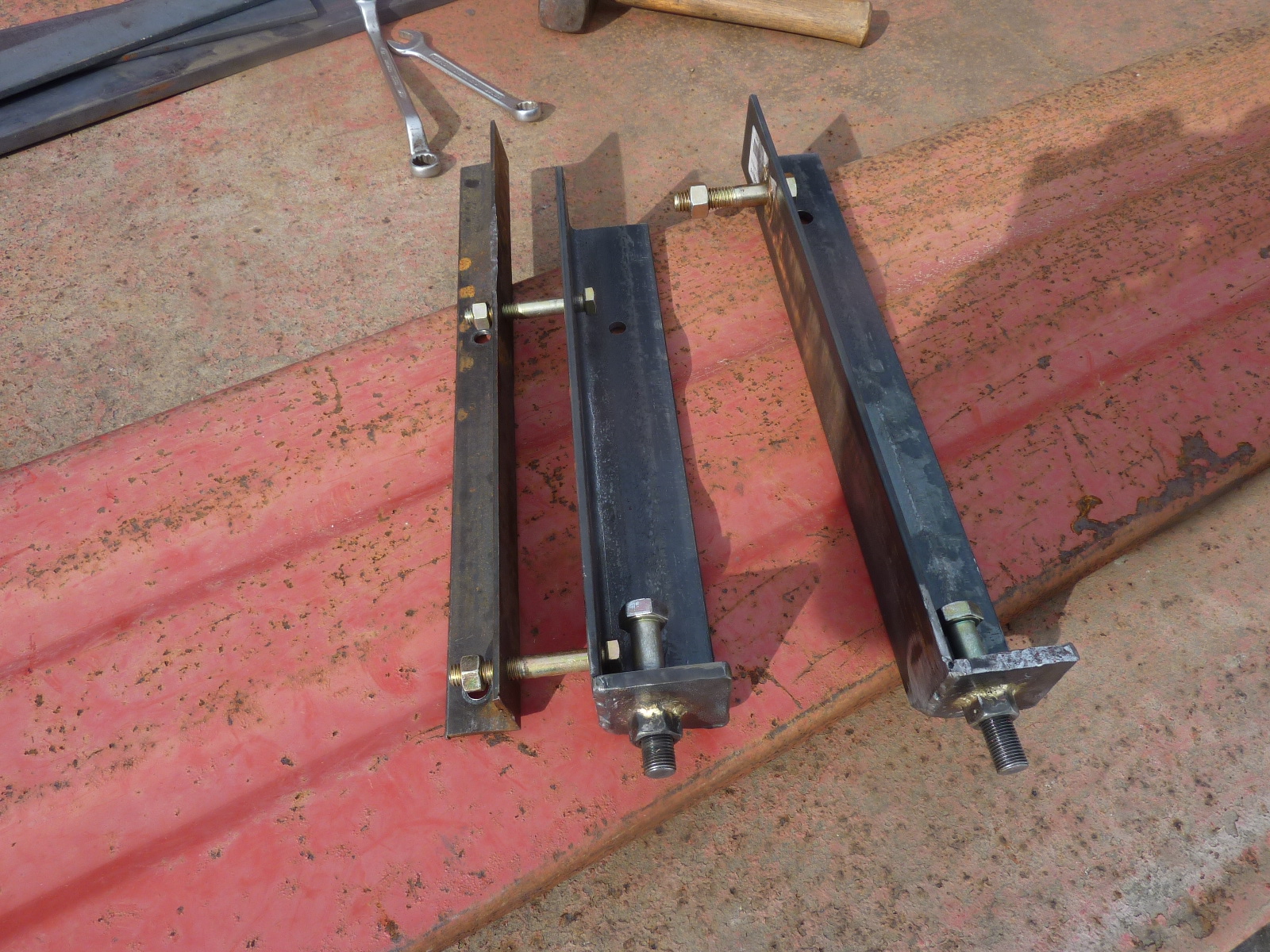

The sides and deck are only formed up 12 Ga ( .104" ) so you can't pry against or beat on them w/o stoving them up. There wasn't a spec of wiggle in the corners - just like they were welded in. I ended up making a set of screw jacks that bolt and clamp onto the corner posts to try and jack the posts up out of the pockets.
They worked and I did't bend it all up but things came apart much harder than I thought they would. I worked the back and front together a little at a time.
I have to change something to make this easier w/o losing much strenght.
gg

Not knowing how often you will need to remove the the sides, it would appear that you have a very good solution already. To borrow from Larry the Cable Guy, "Now that there is creative engineering, I don't care who you are!"
In all seriousness it would appear that one of the keys to the quality of the trailer is the tight fit of the side posts and their pockets. Would some anti-sieze in the pockets help make them come apart easier at a later date? Again you have a really good solution already. W Jones

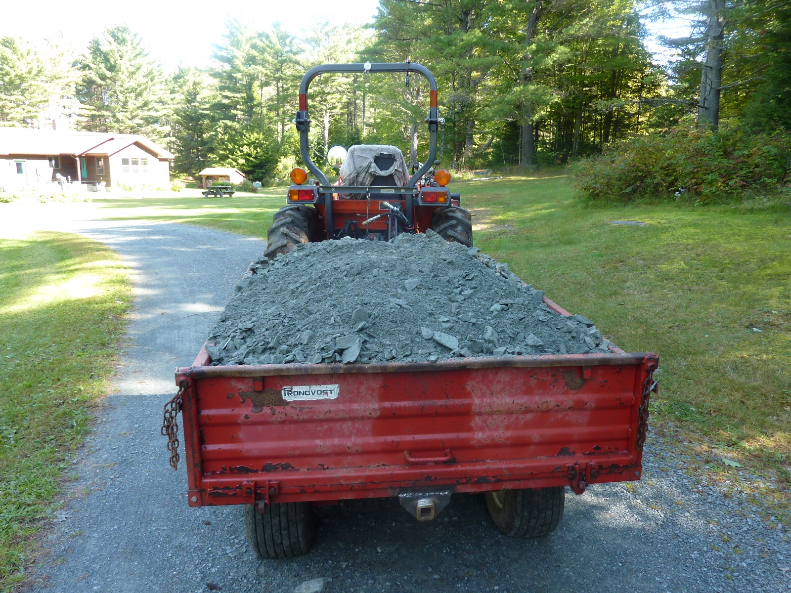

Looks a bit overloaded?
David
I forgot to tell the wife to stop shoveling !!!
