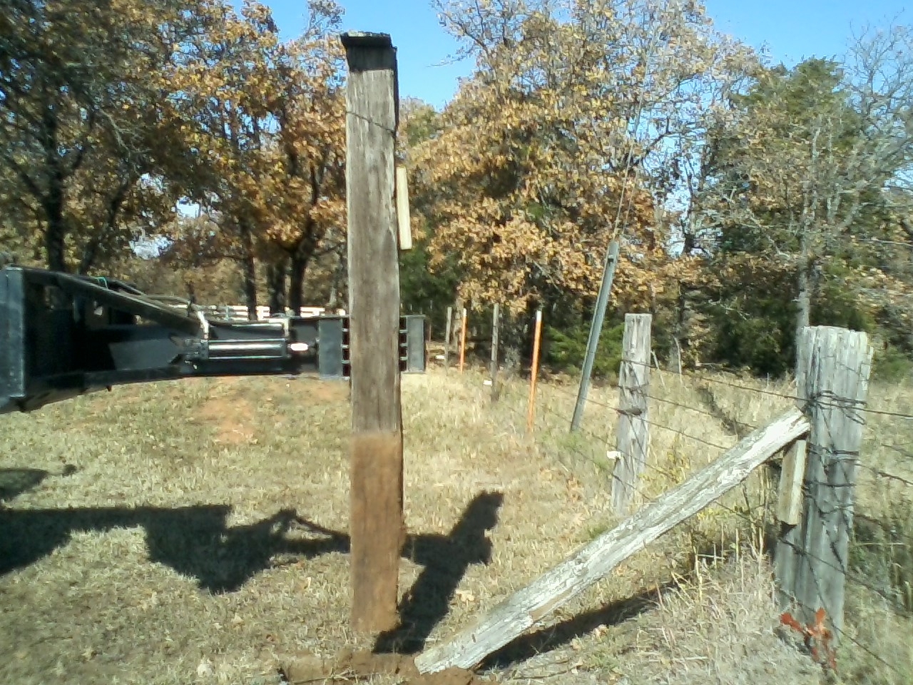

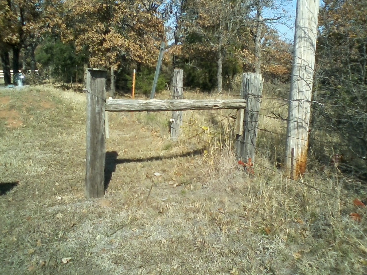

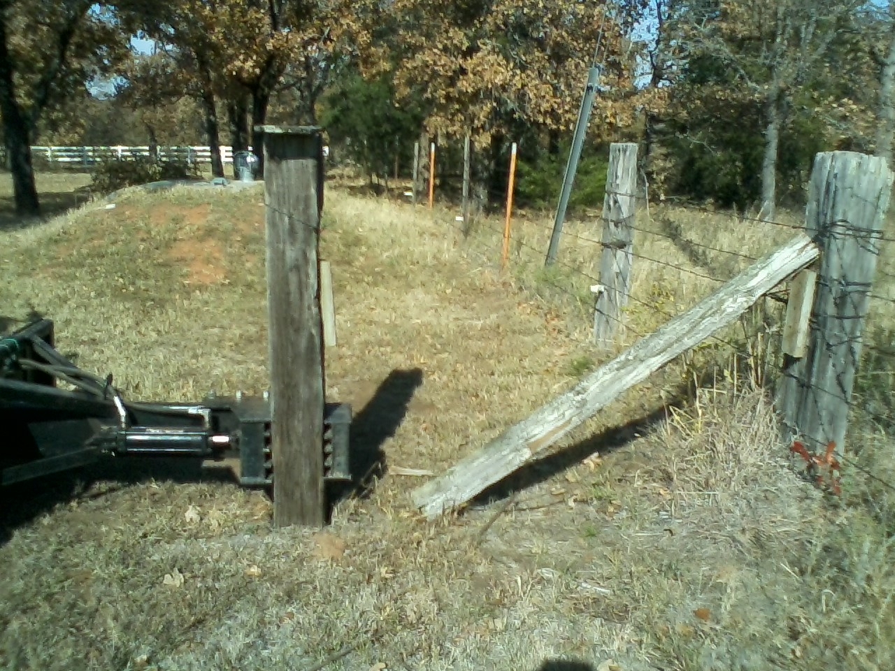

These particular metal fences were installed in the 1930s on split oak posts. Some still standing. Some on the ground at this point. What I've done is to use the teeth on my backhoe like a powered rake to pull the fence out of the ground and vegetation to roll it up. Have to watch for broken pieces of wire because I don't want flat tires later.

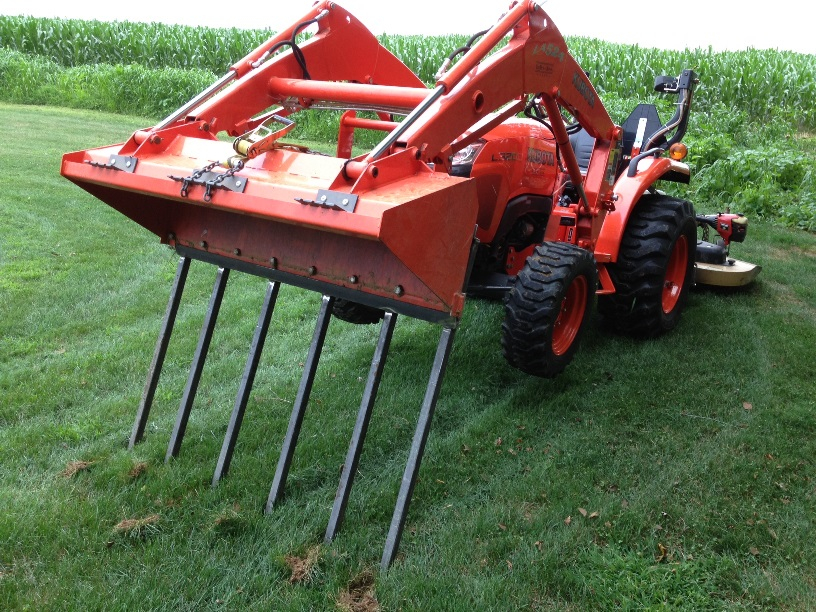

Bale spears are a nice secondary attachment. They can do more than just their name.
   / Removing old fence the easy way #15

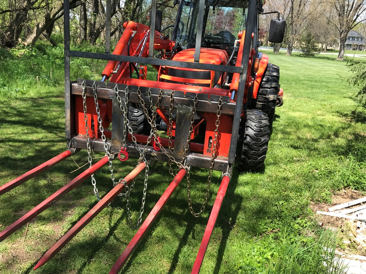

Never had an occasion to move bales, but so far I've made two sets of forks for debris, limbs, kitchen appliances, etc. The first was made for the L3200 of stuff we had laying around the shop at work. They clamped onto the bottom of the bucket via a chain/ratchet strap arrangement. That tractor didn't have a QA bucket. Worked OK.
The second set was made for the L4240 with bale spears and a QA frame a local guy listed on Craigslist. This one is a bit more heavy duty. The QA sure makes it more user-friendly.
